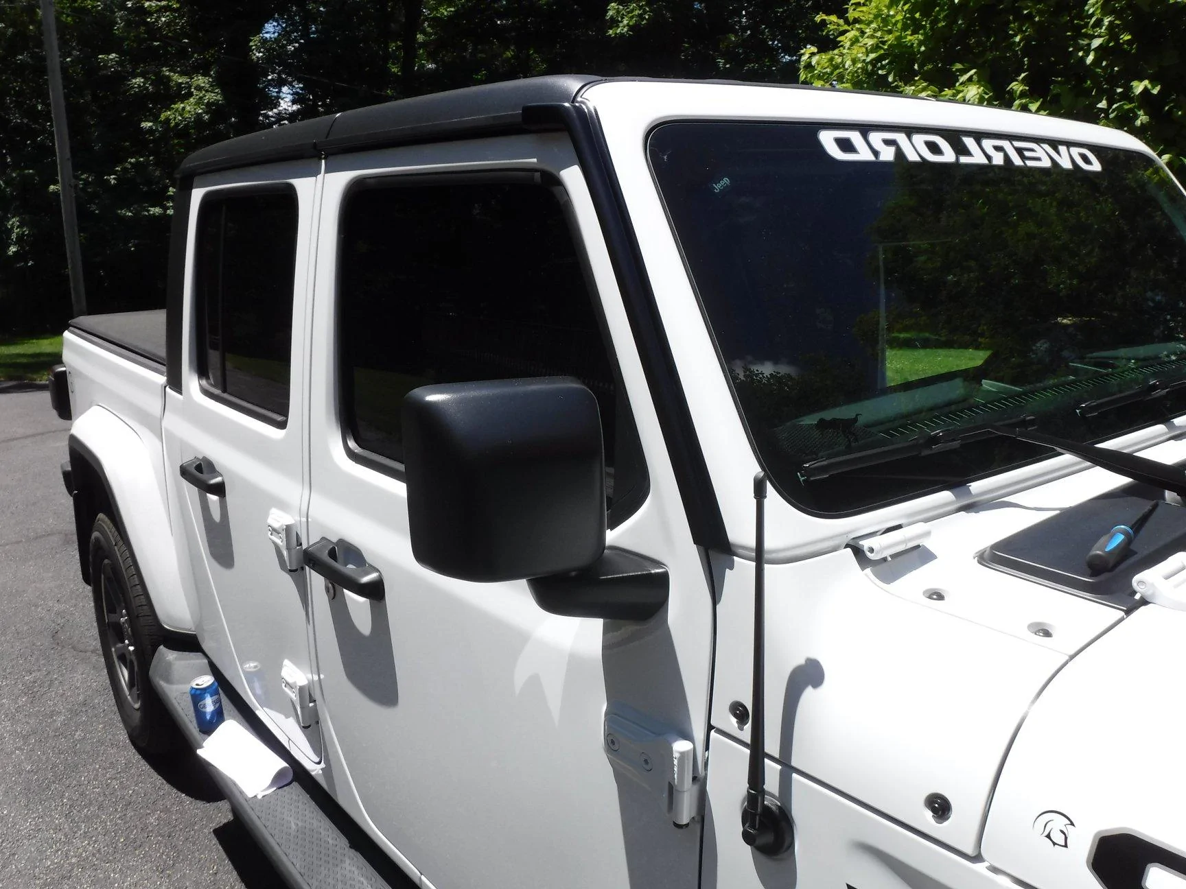

OVERLORD
Don Bob
Sep 23, 2019
131
1,409
2,625
Hudson Valley
2020 Jeep Gladiator Overland
Have tried remounting them a few times always end up with drips. So I decided to try this solution.
No drips, even after conversion to a soft top. I guess the aunti-botics are working, no grabbing the urinal plumbing either.
