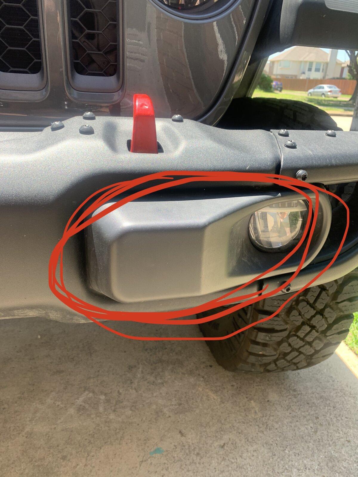

Yeah, this little part is plastic. It is probably to comply with some federal law for 5mph/2.5mph crashes.
The rest is all steel.
aftermarket bumpers likely get away with not having something like this as they might be for “off-road use only”

Hope that red marker you used to circle that will wash off your bumper.....
That part is also cheap - bust it or scrape it up, pop it out, put in a new one (well, there's "crush cans" behind the proper factory installed version)

That was my original point tho. Its a 900 upgrade from Jeep and you still need a 200 dollar winch plate. 1100 bucks buys a pretty bad ass aftermarket bumper and you'll have money left over to start on the winch buy without any plastic on it. And the steel isn't all that thick, albeit it is quite serviceable.

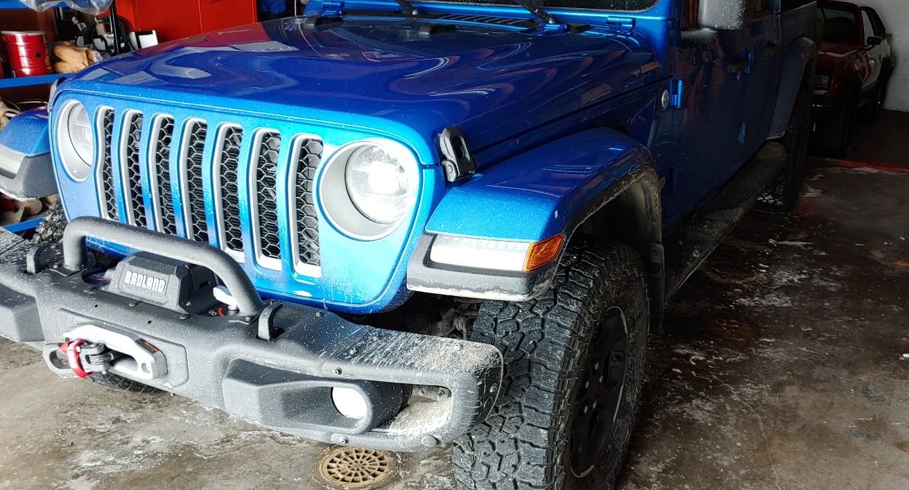

The install is crazy easy. No brainer even with no instructions. Take off original, bolt on new.
I couldn't believe the number of posts out in the Jeep world people having trouble figuring out the front bumper swap. When I was done I asked myself - what's the big deal? Yeah, an air ratchet speeds things up, and a couple of extensions and a flex help a lot, but other than some tools making it easier or faster, it honestly was simple as heck. Even adding the skid plate was no trouble. I did it myself, no helper to hold things.
The only part I don't like so much is the mud, salt, sand and dirt that gets tossed through the middle of the "wings"...........

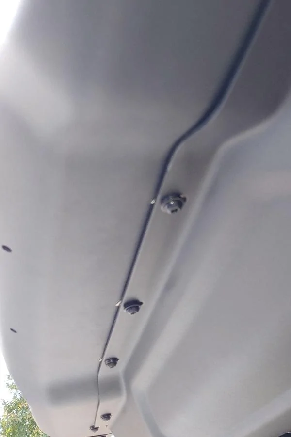

There are TWO different Rubicon skid plates. One for the "plastic" bumper and the other for the steel bumper. The standard basic Rubicon skid plate uses rear brackets and front brackets. IT does not attach to the bumper. You see a lot of those around because when people put the steel bumper on they take those off and put on the other style ->
The other style is the one that comes with Rubicon that has the steel bumper. It does attach to the bottom edge of the bumper. You only see those for sale if someone takes off the Rubicon steel bumper and puts on an after-market front bumper, like some of the short or mid-length bumpers, those with swept up ends and so on.
When you install a steel bumper on the front you need the Rubicon skid plate for the steel bumper, not the one that comes with the basic Rubicon that has the plastic bumper.
You will need the skid plate and the bottom/rear skid plate brackets and attaching hardware.
You can buy the brackets and bolts and such for the skid plate from any MOPAR/JEEP parts vendor, including those who are forum sponsors here.
This is the Rubicon skid plate that attaches to the steel bumper at the front of the skid plate.
It does not use front brackets since it attaches here.
The OTHER Rubicon skid plate doesn't attach because it's used with the plastic front bumper.
(but both are MOPAR because they are Jeep parts. Hope that helps explain)
