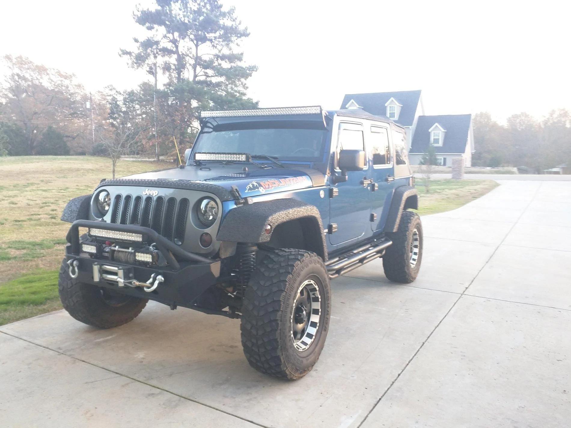

That is a little shocking, I've never had any issues. I'll say this, if Geolander M/T's weren't so loud on the road and if I could get more than 30,000 miles out of them for the price they are I'd be running them. If I had a dedicated trail rig the Geolander M/T would be my tire of choice on it.
Jeep Gladiator 35” Tire Questions IMG_20151125_164022
That's my old JKU with a set of the Geolanders on it. That the first set of 35's I put on it and the only reason I did was because I had a buddy working for Scott Riggs Racing and he had switched tire sponsors from Geolander to Toyo and he had 15 sets of 35's on a trailor and my buddy told me if I brought Scott $400 he'd sell me a set. I couldn't pass that up.
