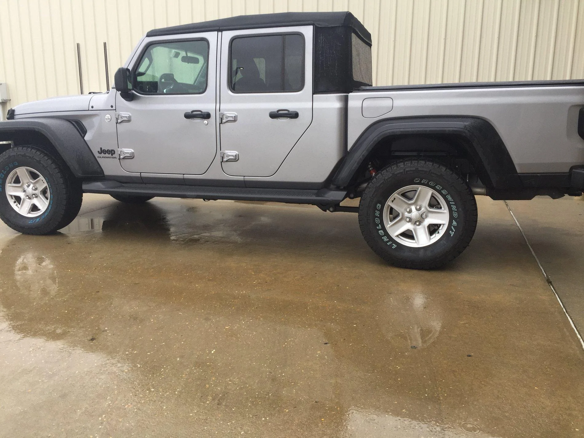

I went with 305/70/17 Crosswind A/T on stock wheels $154 ea. 8 ply....34” actually measures 33” from ground to top of tire. Doesn’t seem to have affected fuel mileage....maybe less than 1 mpg.
Picture not showing on post but does in my quote
So is that just an inch more than stock tires at 32”?

31.5 according to the documents the dealer gave me
The tires I put on were listed as 33.8” but when I put a level across the top of the tire and measured to the ground it’s a flat 33”
