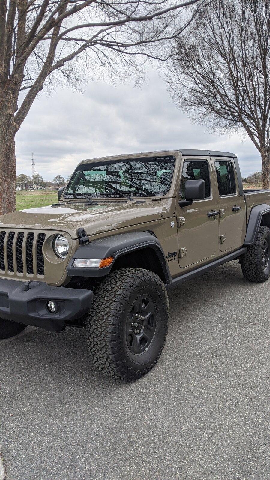

Sure will. My 315 70 17 BFG KO2S cleared with no lift. Mine where 12.4 wide and 35 high, had no issues without a lift and they did and looked great with a 2.5" lift as well. I'm now running 37's with a 2.5" lift. Mines a Max Tow as well
No lift 315 70 17
Jeep Gladiator 35/11.50-17 on stock sport S wheels w/2.5 inch lift IMG_20200213_183121
With 2.5" Readylift SST lift kit same tires
Jeep Gladiator 35/11.50-17 on stock sport S wheels w/2.5 inch lift MVIMG_20200322_105510
On 37 12.5 17 with Rubicon Takeoff springs in the front and 2.5 Readylift SST lift kit
Jeep Gladiator 35/11.50-17 on stock sport S wheels w/2.5 inch lift PXL_20210328_233737820.PORTRAIT~2
No lift 315 70 17
Thanks. I like that look. Now I need to compare 35/11.50 vs 315/70
