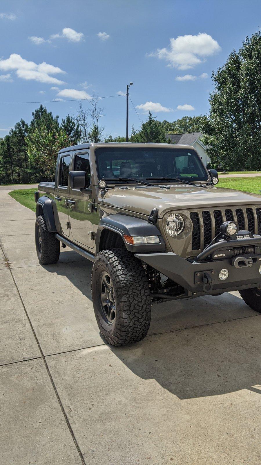

To answer your question, I ran BFG KO2 35" tires on my JKU stock wheels and got 50,000 miles out of them. I'm running 315 70 17 BFG KO2S on my JT stock wheels and I'm 15,000 miles on and they show minimal wear. I feel confident I can get at least 50,000 miles out of them. I run 39 psi in mine and it drives and rides great. I really wish they would wear out faster so I can go ahead and get 37's but it is what it is. Mines a Max tow as well, keep them rotated and you will be fine
Are those the stock silver wheels you painted?

No, they are stock black wheels. They came black from the factory, one of the selling features for me on the Jeep honestly. I am a fan of them
In that case I'll probably put the 35s on the stock 17x7.5 and plasti dip black and later on buy new 17x9 wheels
