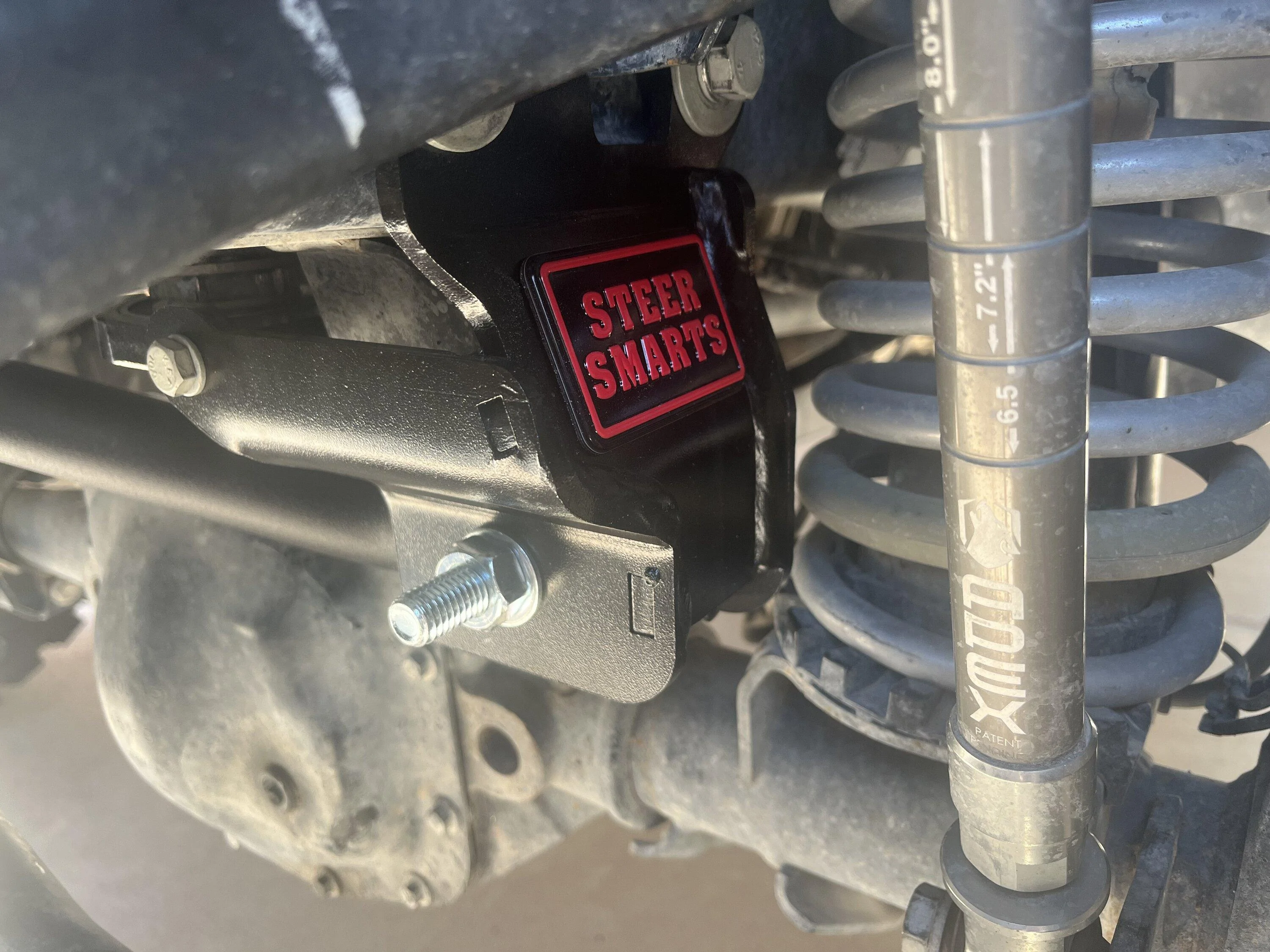

4) Check to make sure you have the steel steering box (you probably do), its black instead of gray. If you do have the steel box, dont bother with a sector shaft brace it wont make any appreciable difference.

4-I do have the black/steel steering box. I was really torn on this one. Lots of ppl agree it isn't needed. The reviews on the SteerSmarts site are a mixed bag- some said it didn't help, but there are some who said it assisted w/ lurching/deflection issues over potholes and things. idk! I already ordered it from quadratec and will throw it on - if it doesn't help I guess I will have at leat beefed things up.

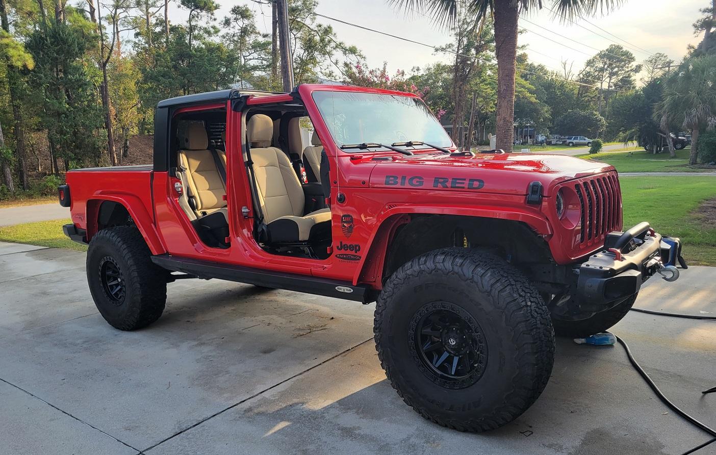

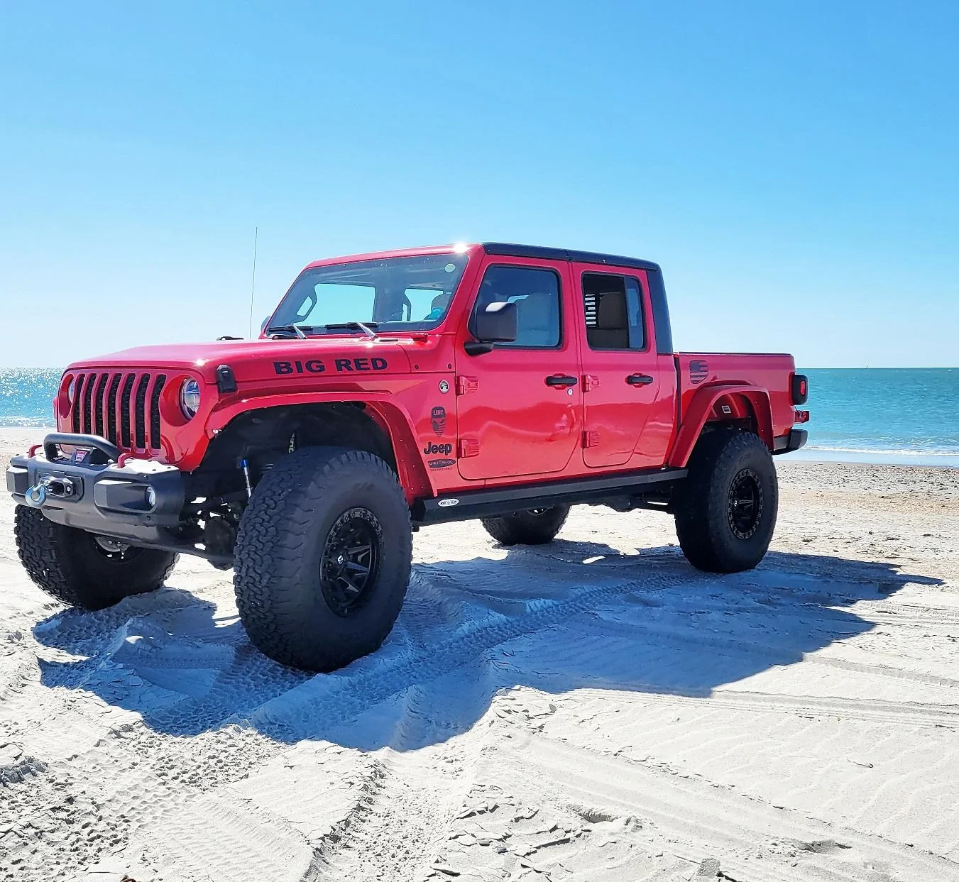

Can you post a pic of your truck with the 39s. I have the 37k02s and was questioning going to the 39s since they run smaller when mine wear down.

Going to add the Steer Smarts and will follow up in a few weeks or as soon as I get to it.
I am really happy with them other than the rev hang issue mentioned above (and it's rare I accelerate fast enough to cause the issue anyways). Everyone asks about them. I just did some mild trails for the first time this weekend and this went over all obstacles w/out bottoming out on anything. I just bought diff skid plates but tbh I don't even know if I need them. lol
