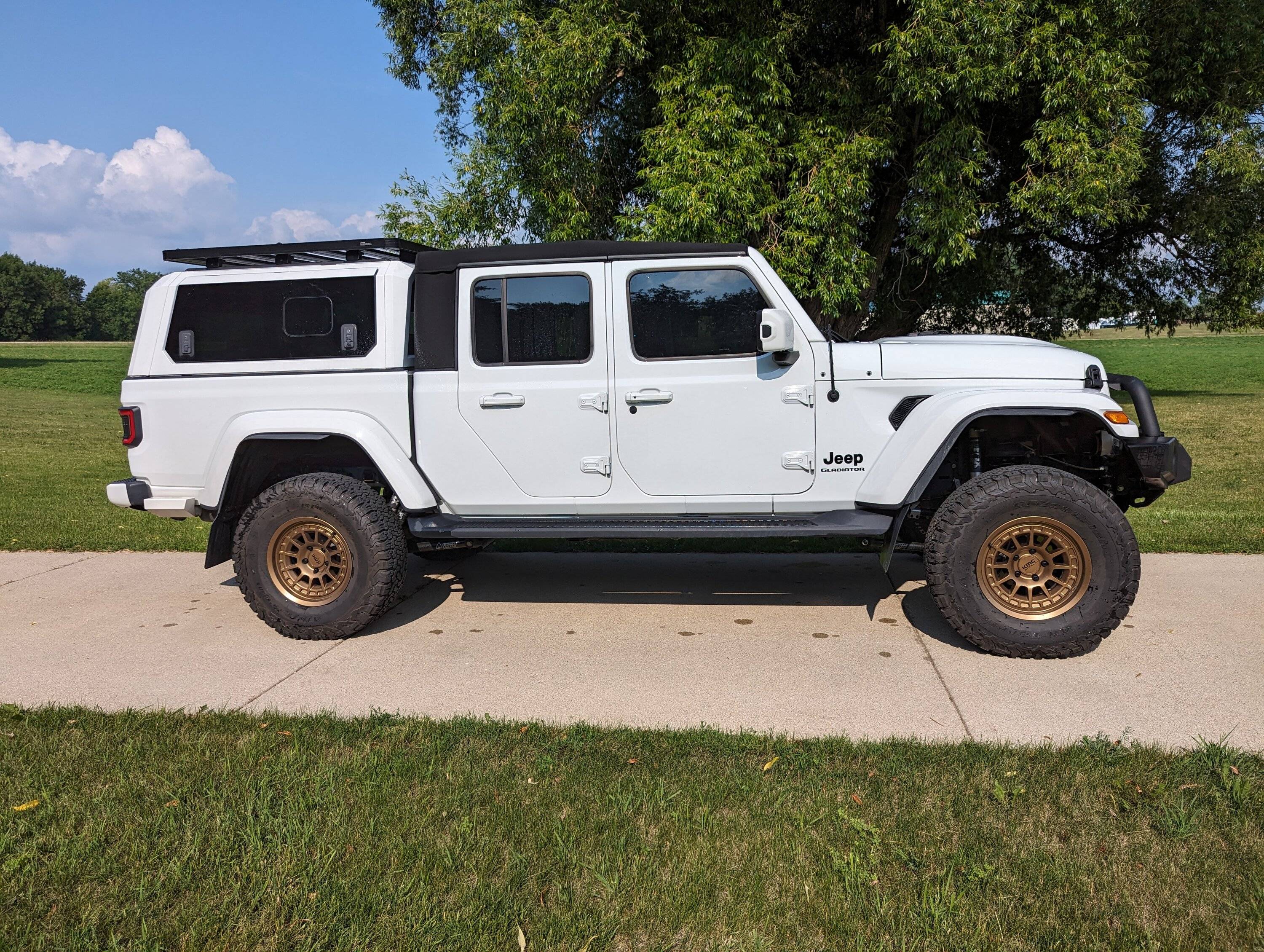

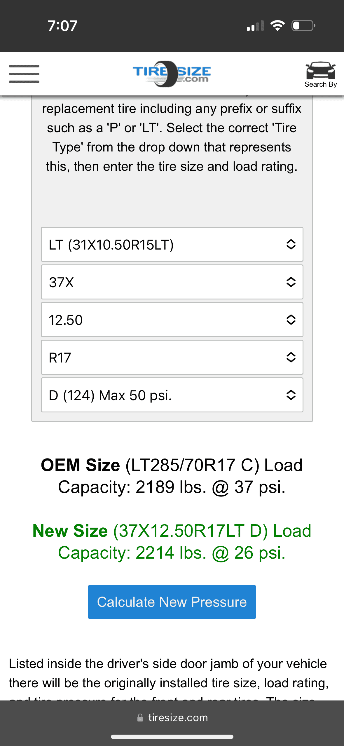

Call Mickey Thomson to ask them. They told me 27psi cold, and they’ve been perfect. I air up the rears a little when towing.

When I got to that same point with mine, they appeared to have slightly more center tread wear than on the outsides. So I called Mickey Thomson. They asked for all the details on the door sticker, including weights and Oem pressures for Oem tires. Based on that, and the exact specs of the new tires, they gave me that recommendation. I’d call your tire vendor and ask them. Yours will end up being different, I’d expect, as you have much less sidewall on 20” tires. I’d be interested in what they say. What tires do you have, and what load rating are they? Mine are load D.

tell you somewhere in the 30 range. I’m guessing based on a friend with them in 35x12.5x17. They told him 30. I can’t remember what his load range is, but his sidewall will be similar. Just take a picture of your door sticker and call them. They’ve got a calculator for their tires.

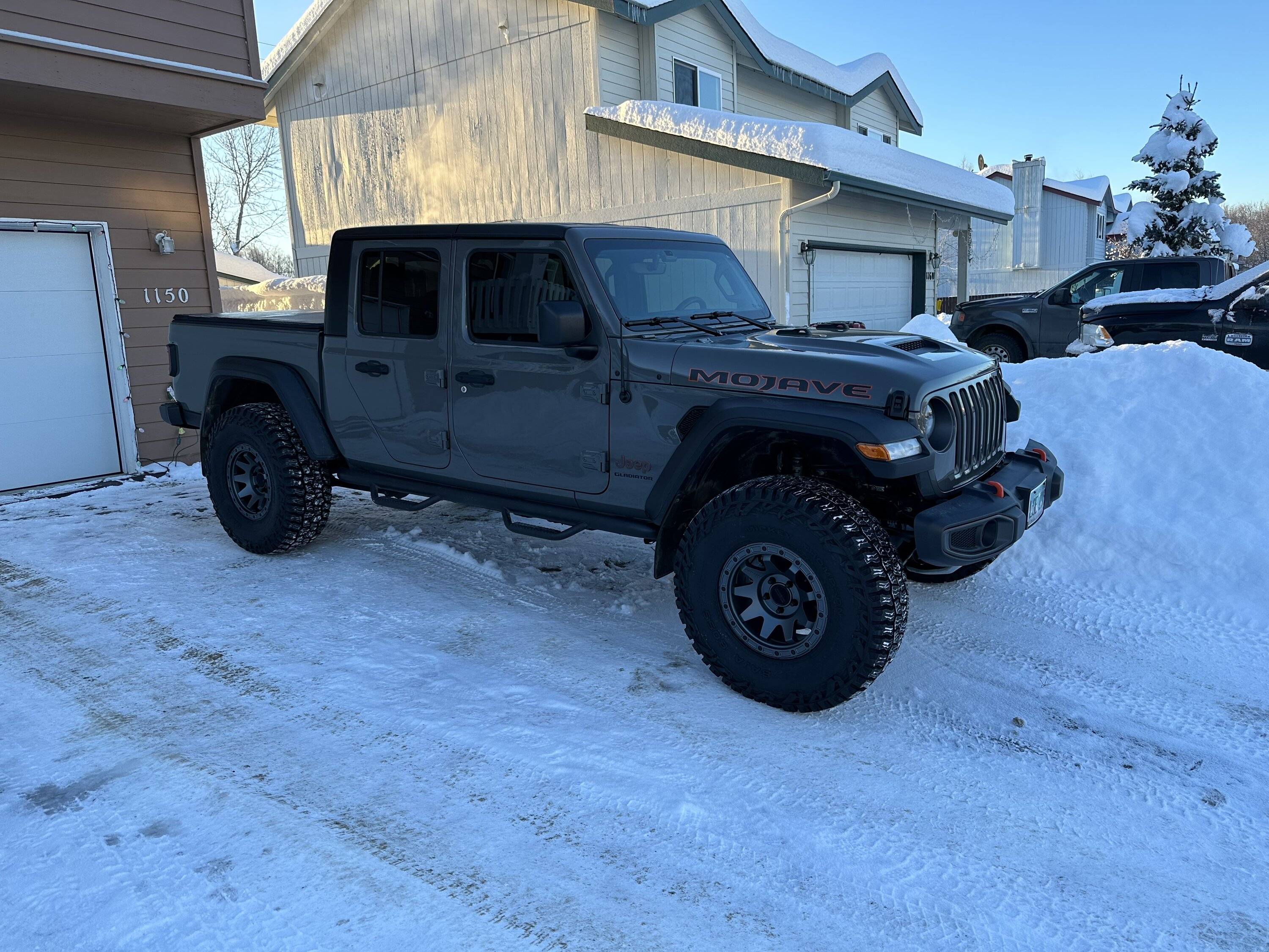

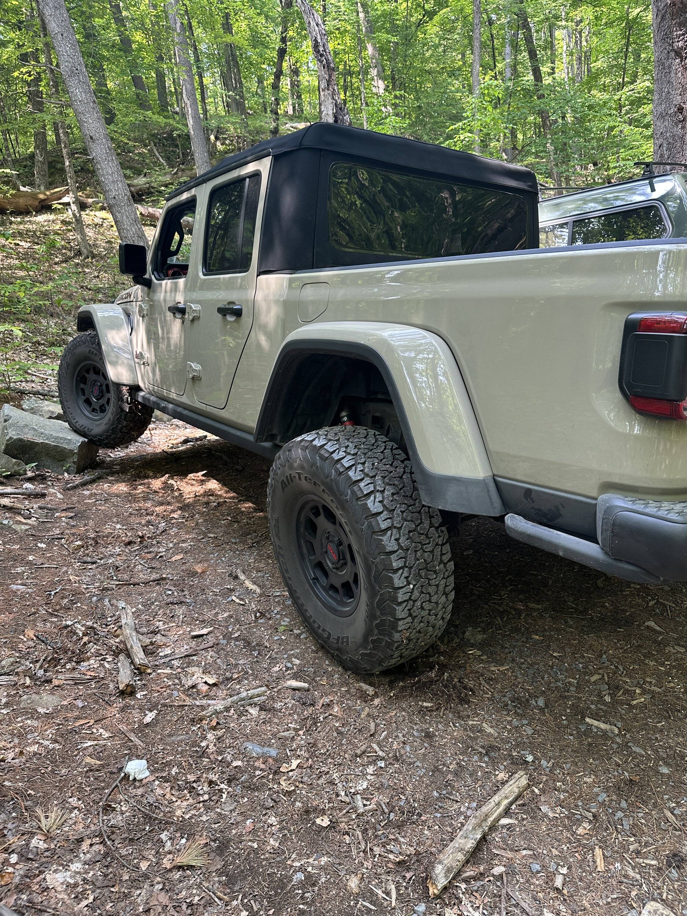

Another vote for the Mickeys. Ive ran multiple sets of Falkens AT3W's, Ko2's, Coopers, Yokos, and every Nitto known to man and nothing compares to the BajaBoss AT's imo for winter driving/ road manners and snow performance (as well as rock performance). That being said I will always run a Nitto Trail Grappler (40x13.50r17) on my JL but its on rock crawler duty only.
Use the Mickeys all winter long for 4x4 S&R with 0 complaints.
