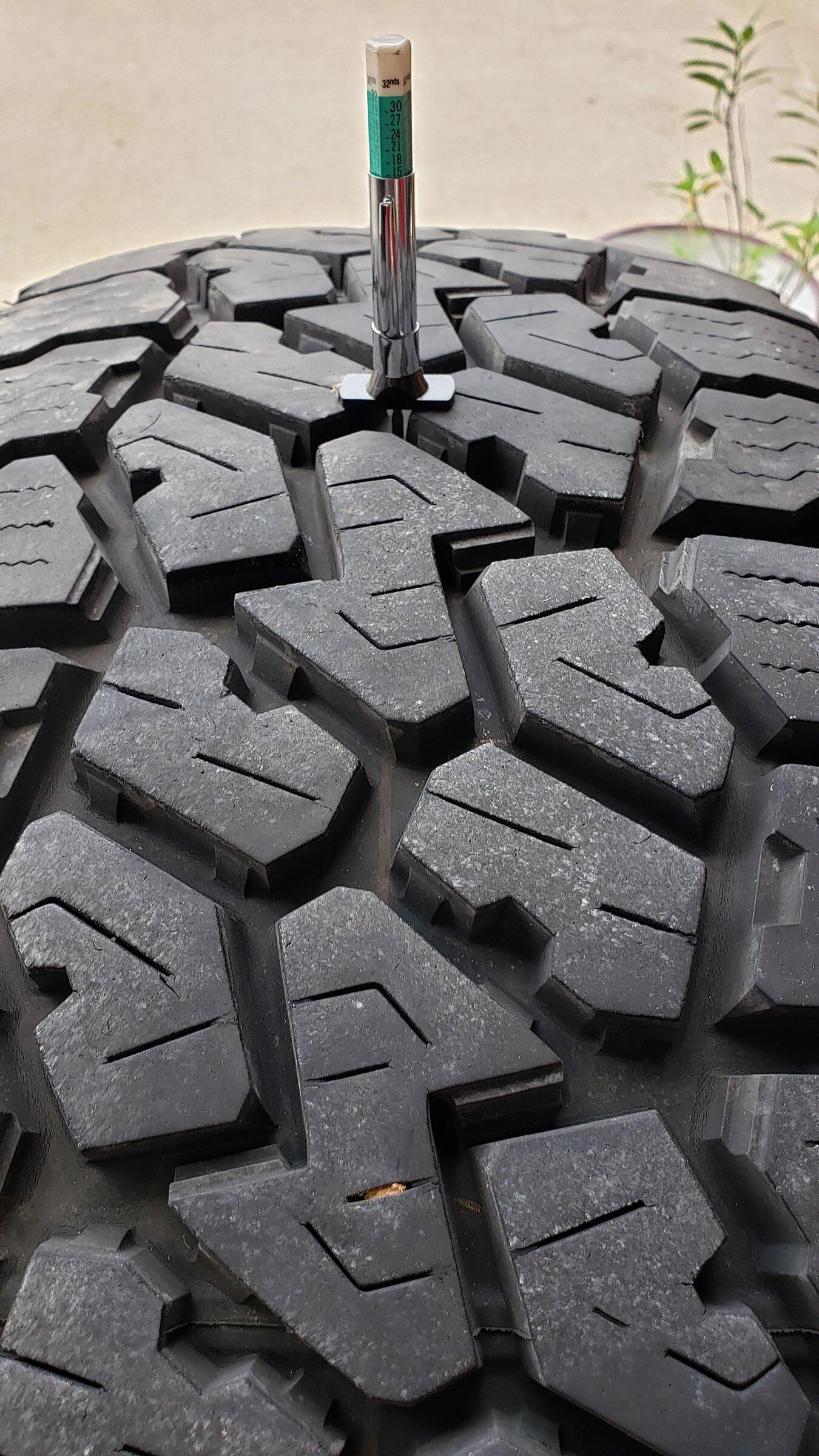

We have had 37x12.50x17 Falken AT3W on the Gladiator for just over 25k miles now. I am really pleased with them. They seem to be wearing really well. I just rotated them this past weekend (5 tire rotation) and they have 15/32 of tread left. 19/32 from the factory.
@HoustonGobi now that it's probably been a couple of years, how did these hold up for you post 25k miles? I'm looking at either getting new KO2s or going with AT3W's in the next few weeks.
