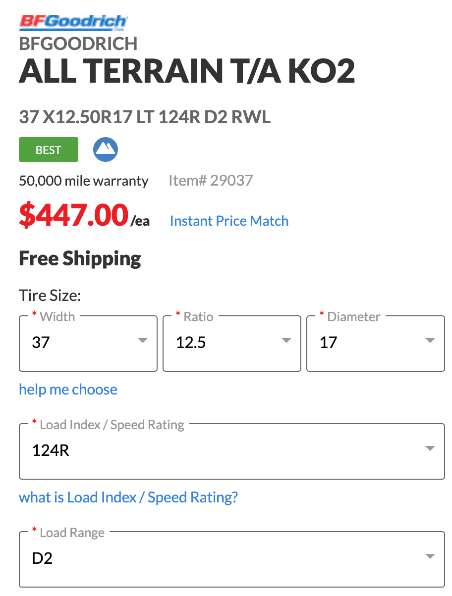

I was planning on ordering the BF KO2 37" tires in Load C as they weigh less than load D. However I noticed the Load D currently cost less. I was under the impress that Load D is a better tire but weights more. I will offroad but nothing major. 90% of the time on the road. Any advantages going with either or?
Just curious what load most folks are going with when choosing the 37" KO2's
Thanks!
Based on your 90% onroad-- load C, they are way more comfortable, lighter and less stiff. That's what I did...
