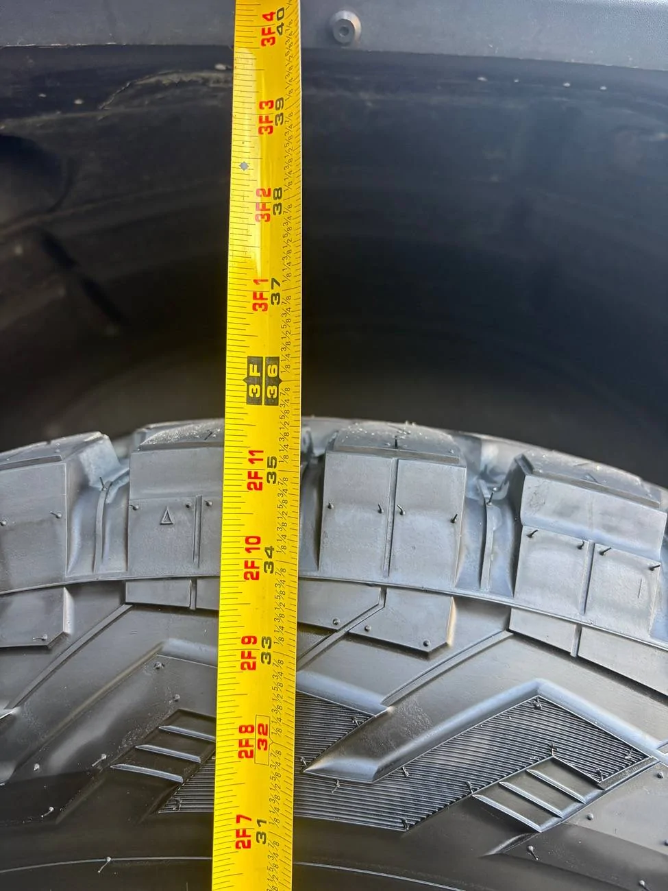

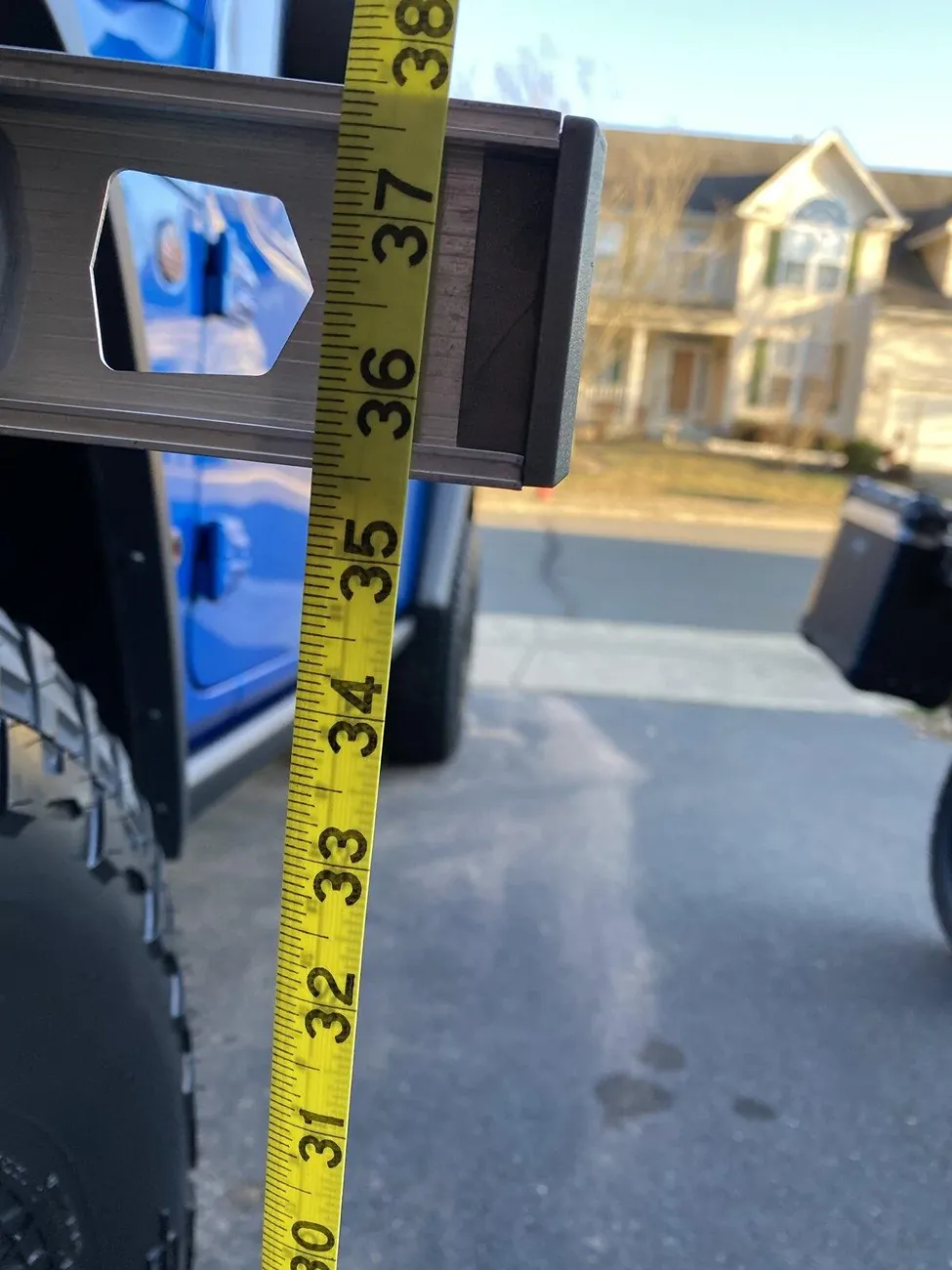

Exaclty I agree with you, it is all tire brands that measure up smaller to get an accurate speedometer. Heres two examples of 37x12.5R17 tires, Top is a falken 37" measuring at 35.5 and bottom is a Toyo (a brand everyone says runs "true" to size coming in at 35.5.) This is perfectly in line with my 37" Ko2's measuring up at 35.5 with the weight of the vehicle. I just fail to see how they uniquely run small when people call out the Ko2 specfically.
Jeep Gladiator 37” BFG KO3 Load C 126886-d69db83de35441844e3381defaa8aa9
Jeep Gladiator 37” BFG KO3 Load C 402105-542a7311d3458d66fd9444a0722bcc54 (1)

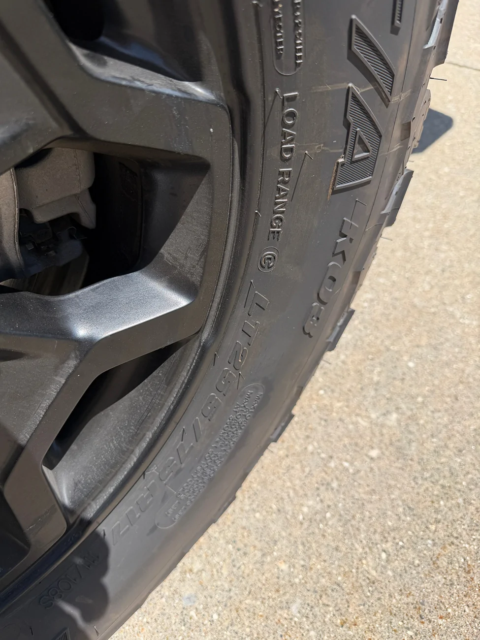

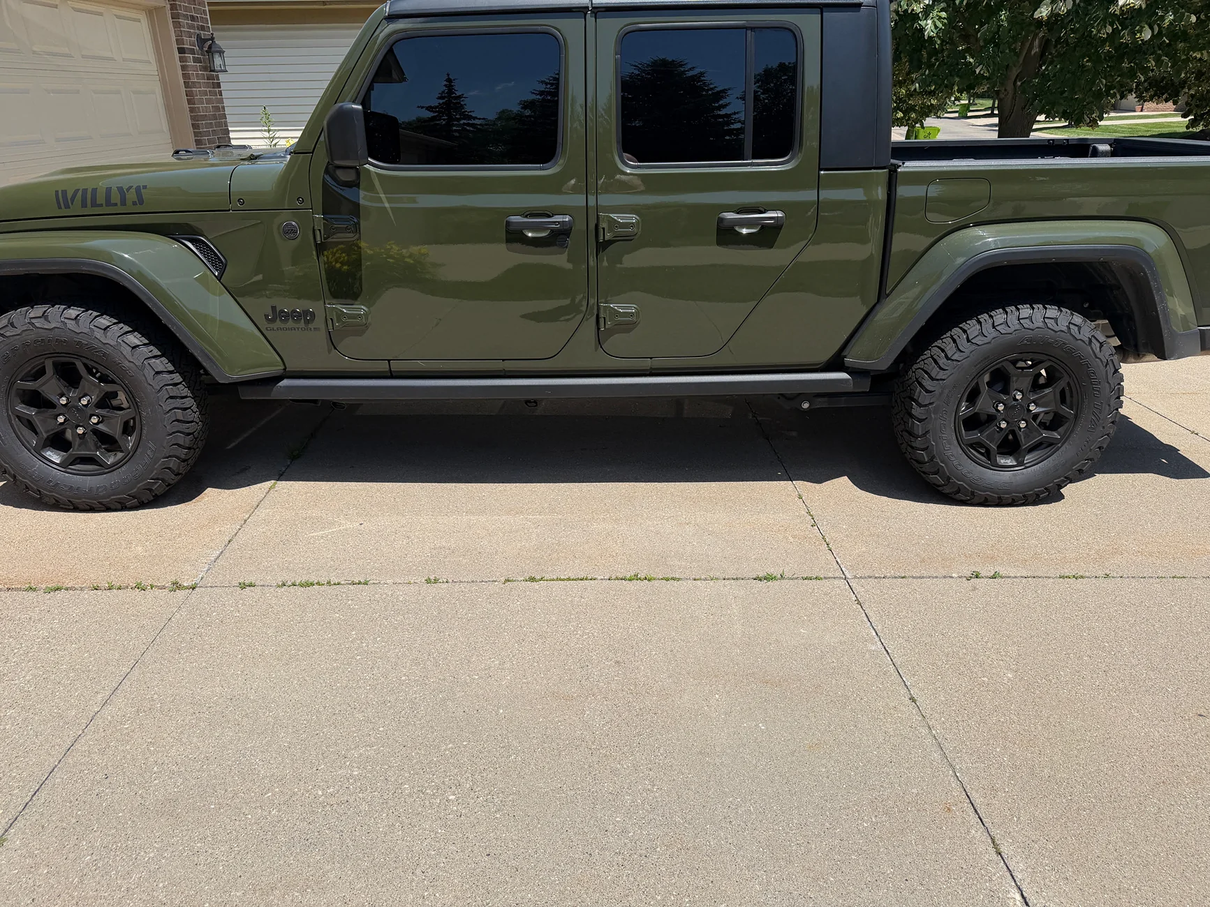

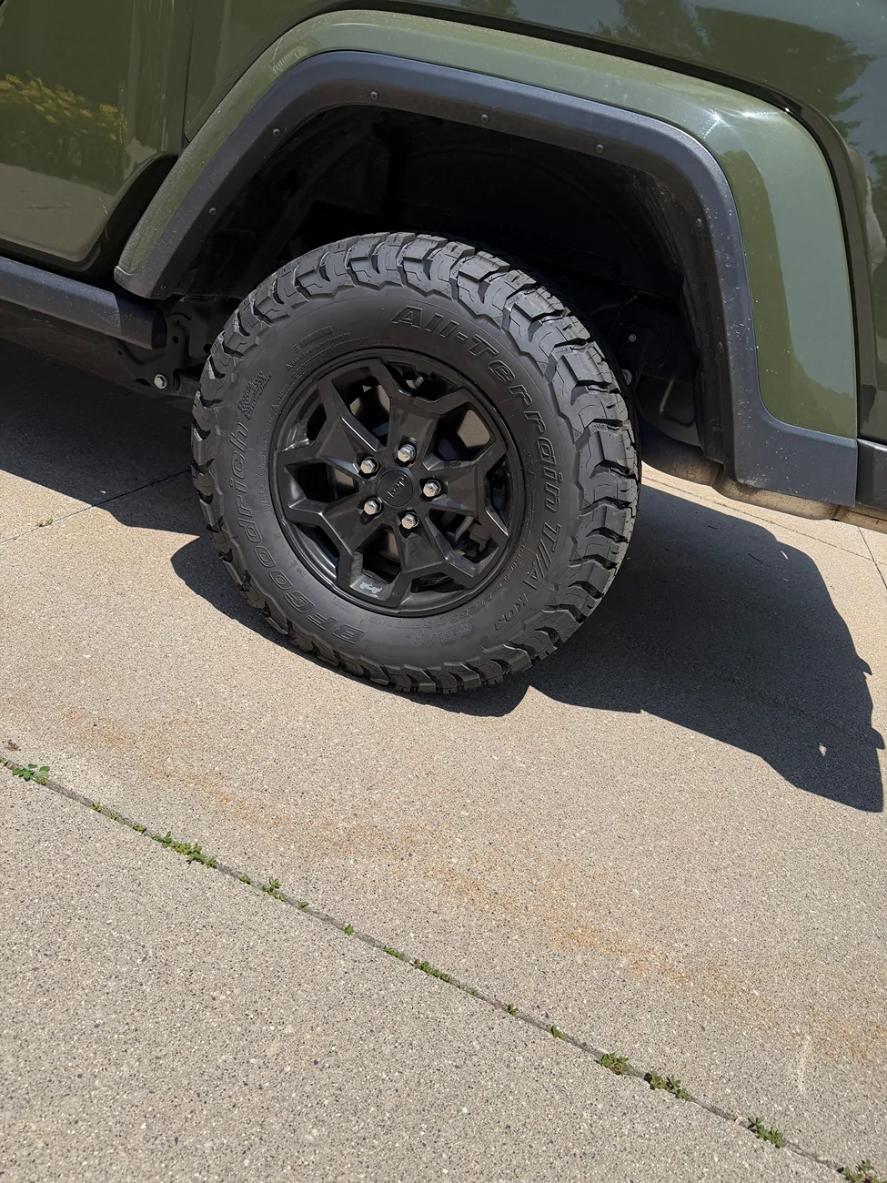

I just got the KO3s stock size for the Willys:
Jeep Gladiator 37” BFG KO3 Load C IMG_1696
Jeep Gladiator 37” BFG KO3 Load C IMG_1698
Jeep Gladiator 37” BFG KO3 Load C IMG_1697
UTRocky
Rocky
Jan 15, 2025
171
120
Toledo, OH
'23 Jeep Gladiator JT - Willy
Idk I feel these are bigger than the stock BF Mudders it came with.
