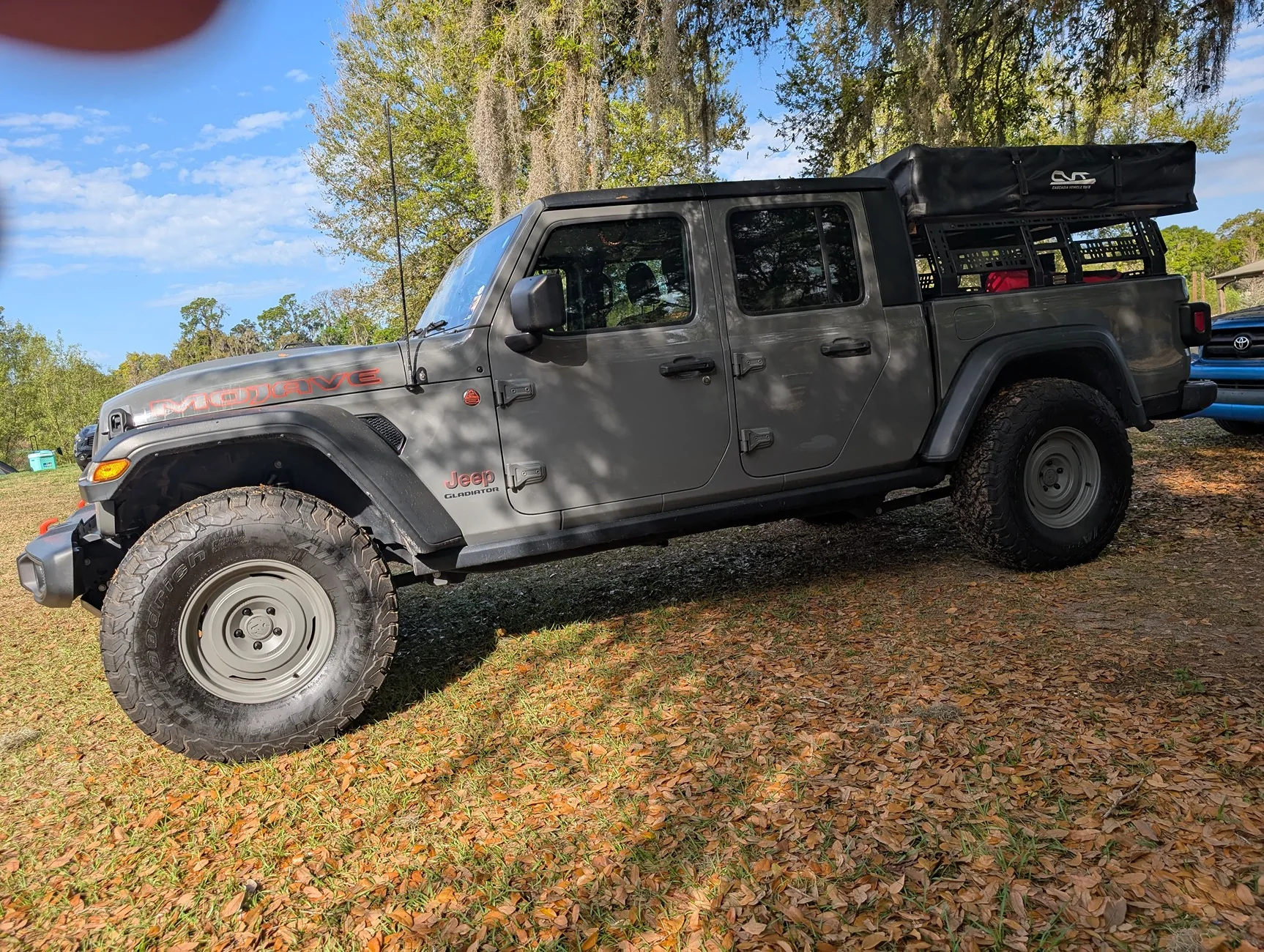

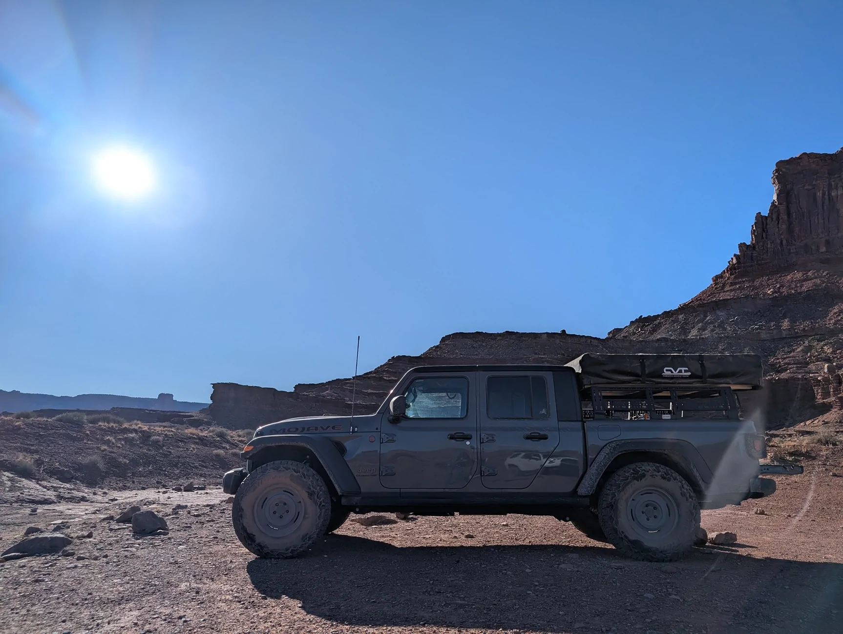

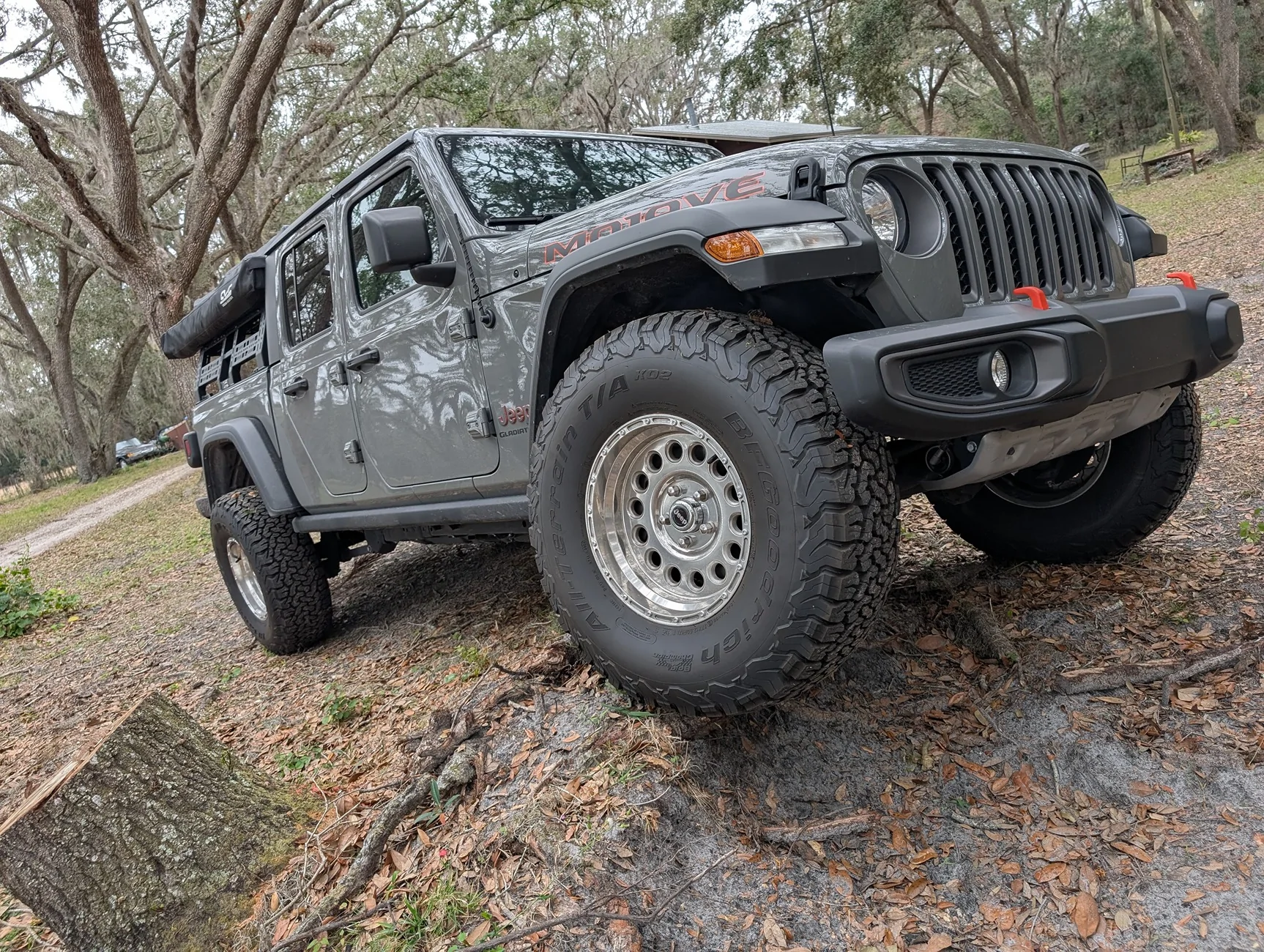

Stock mojave (non x) ran 37 bf Goodrich on stock, raceline, and now fifteen 52s...standard offset. No rubbing but never had need to disconnect swayvar.
Looks great with both wheels.
