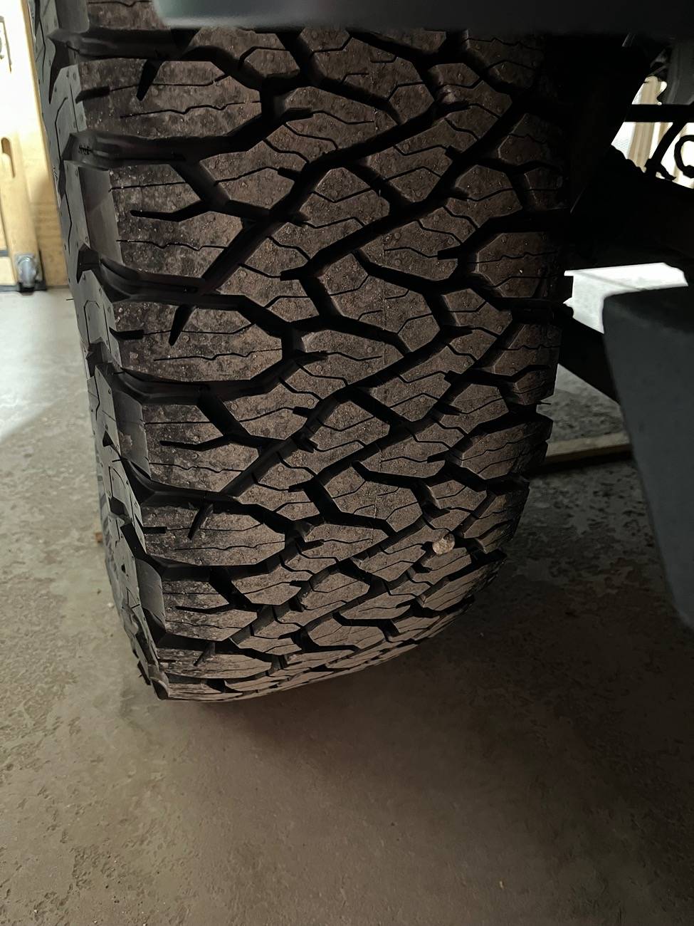

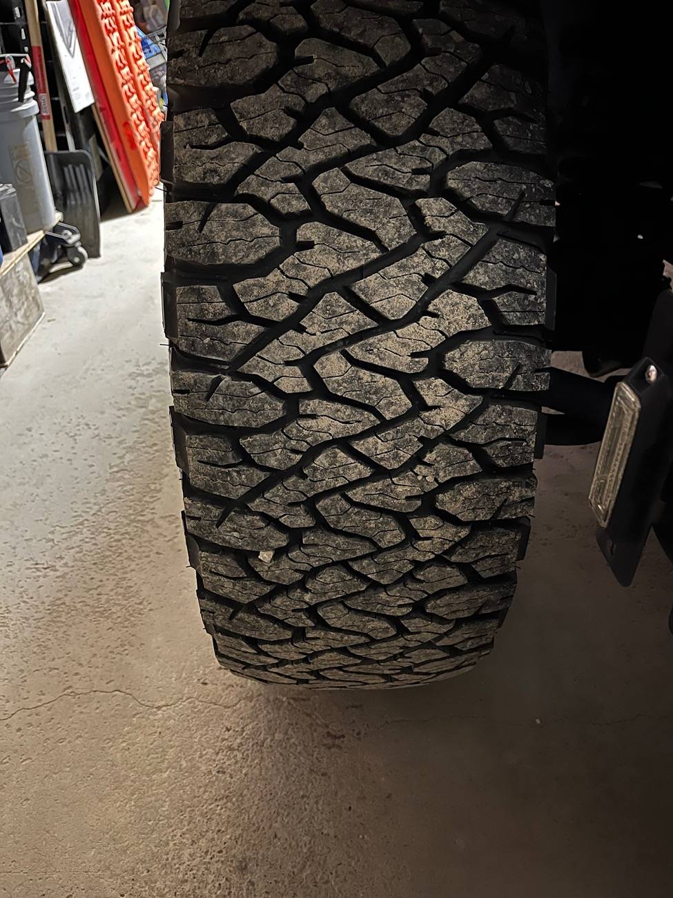

So my understanding with chalk testing is that if you’re seeking long life and even wear with your tire, chaulk testing and of course frequent and religious rotating is essential. So I’ve done both and did very well with having long life experience with the KO2’s.
Now the KO3’s are a bit different. Here’s a photo of front and back, cold, where there’s obvious road contact right across the front tire @30psi and the tread at the back doesn’t have that contact @29 psi.
I think, with 12 ply, there isn’t enough weight in the back to sit that tread down unless you take more air out, which I don’t want to do, and because of the engine weight up front, its just enough weight to show the outer edge meets the road.
At 35psi you’ll lose 1.5” of tread, easy, to both sides and have uneven wear.

Indeed, outer edges of my lugs haven’t hit the ground as far as I can tell by the dust patch on my tires … I gotta get my lazy butt to reprogram the TPMS for 30psi. I’ll check the tread depth for evenness every rotation …
