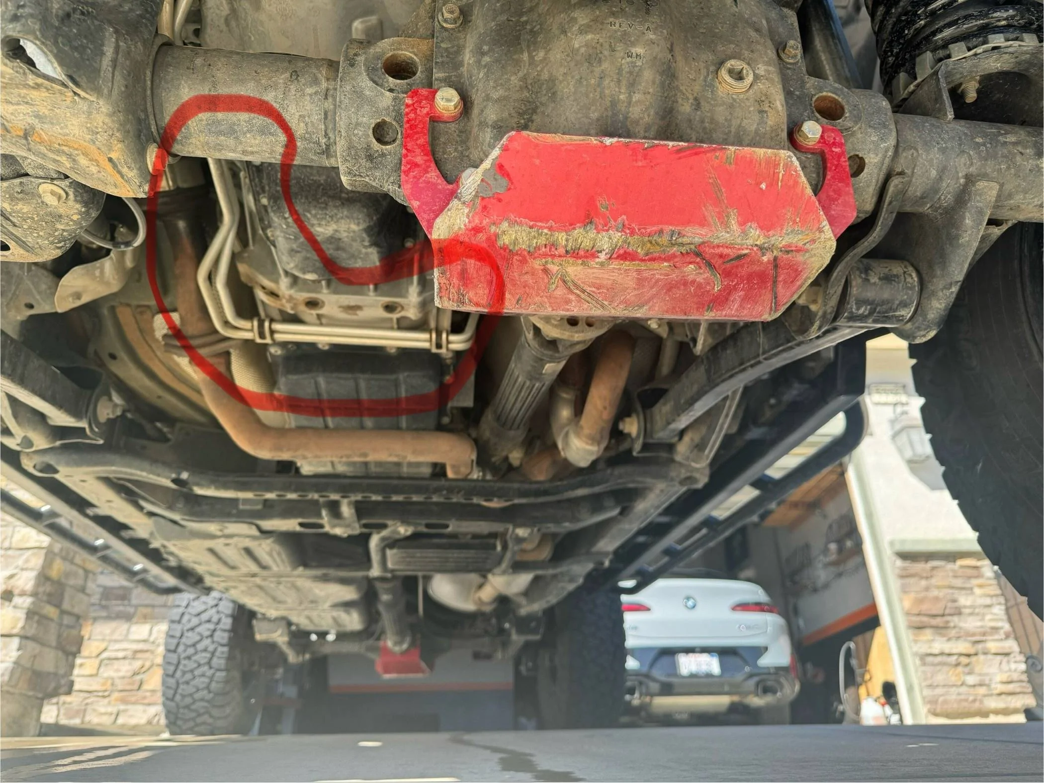

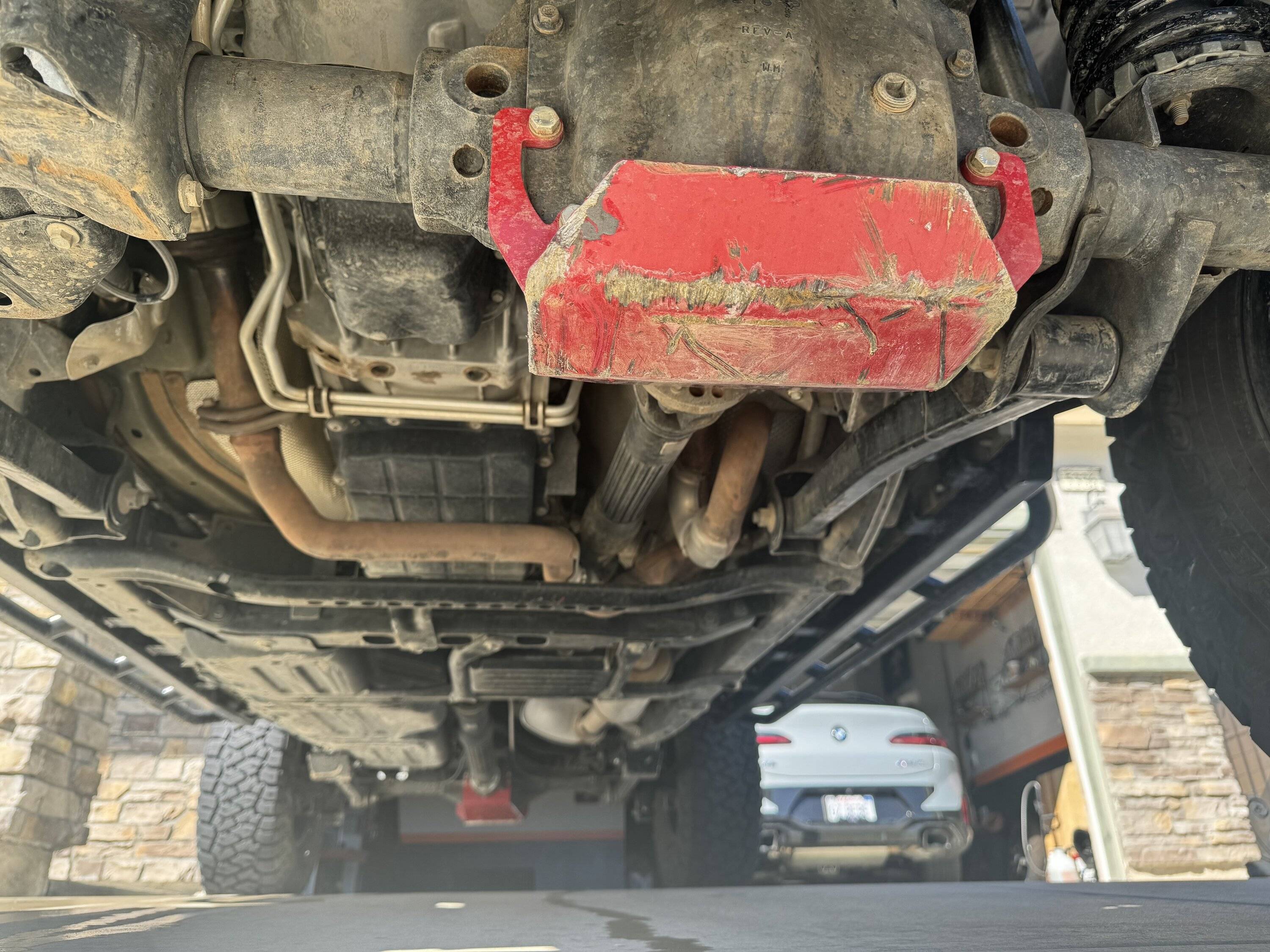

Yes sir! They are quite stout but they took a beating on Mottino wash. It made them look like they've been on for a couple years when I jut got them for Christmas. I have their rear control arm and shock skids as well. Will be doing fronts soon.
Nice! They dented but didn’t bend, it looks like.
I put an engine skid because I was worried about ripping these off somewhere and getting stranded.

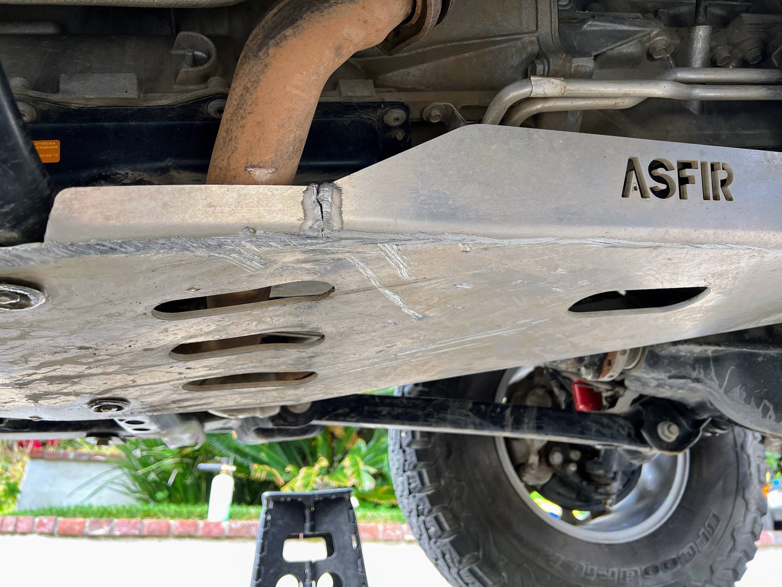

What skid did you go with? I've been contemplating one as I scraped the exhaust right there already.

A few of us have the ASFIR skid. Inexpensive, aluminum, seems totally fine for its purpose. I have a few scratches on mine especially back where the bolts are but seems perfectly sturdy. The bolts in the OEM transfer case skid are more torn up since these have the beveled washers protecting them.

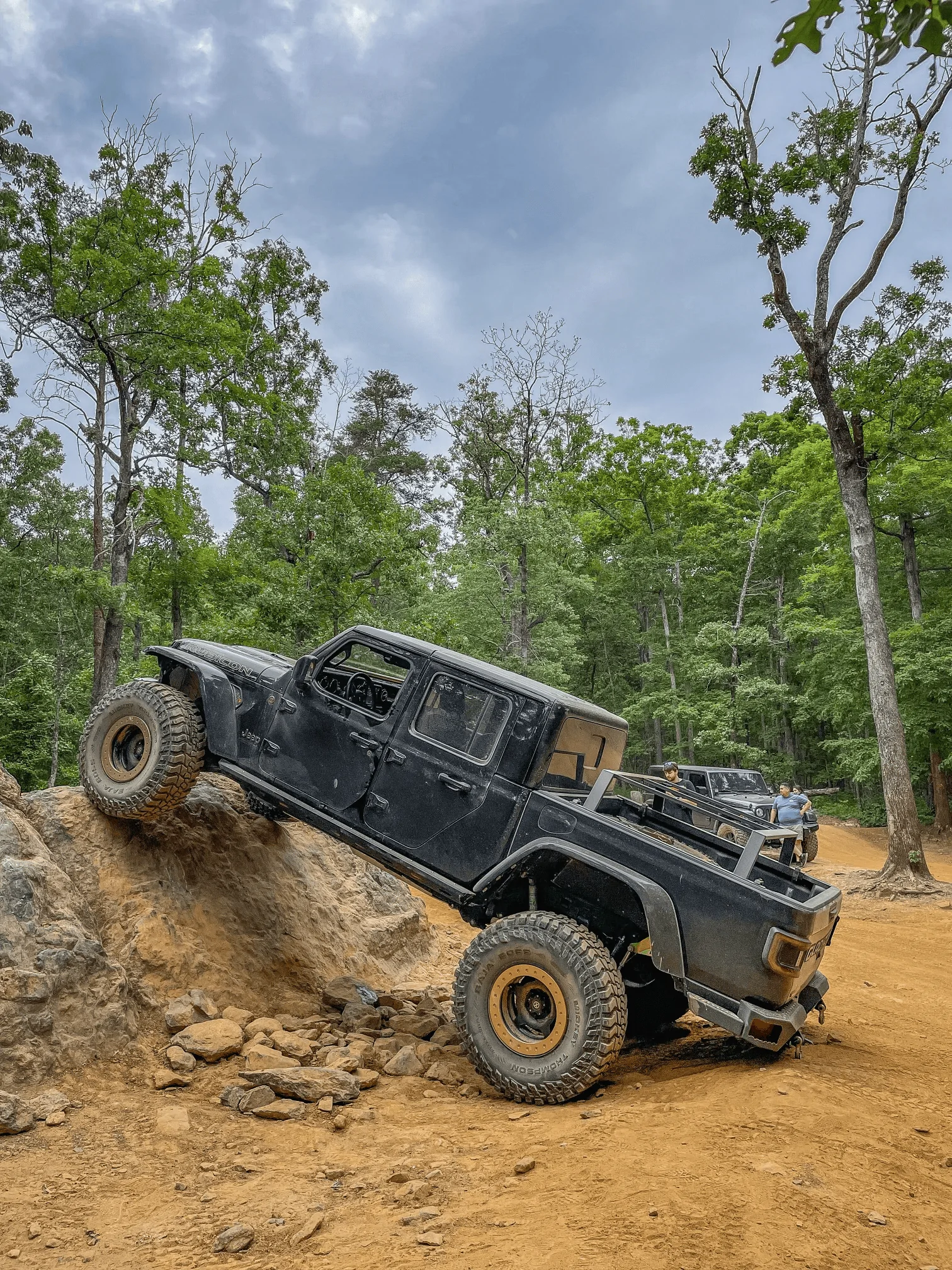

Craigger on wrangler forum posted this, that’s the most I’ve seen any damaged. Said he slammed down on something in big bear and cracked a weld.
