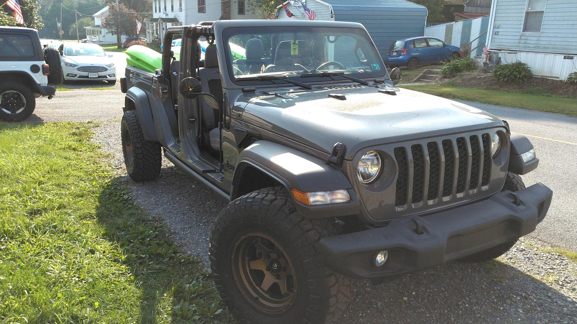

35 x 12.5's on my Sport Max Tow w/ no lift (yet). No rubbing, and rides and handles almost better than stock, feeling more stable than before.

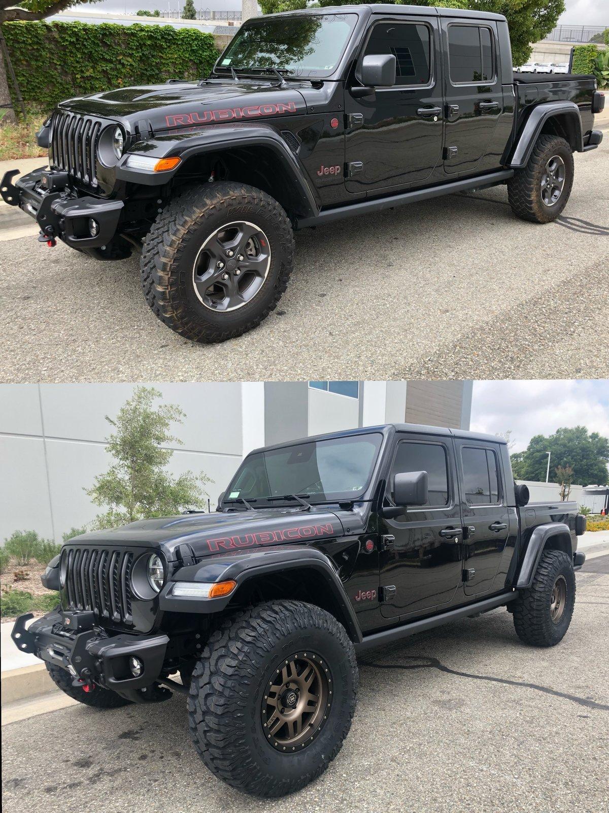

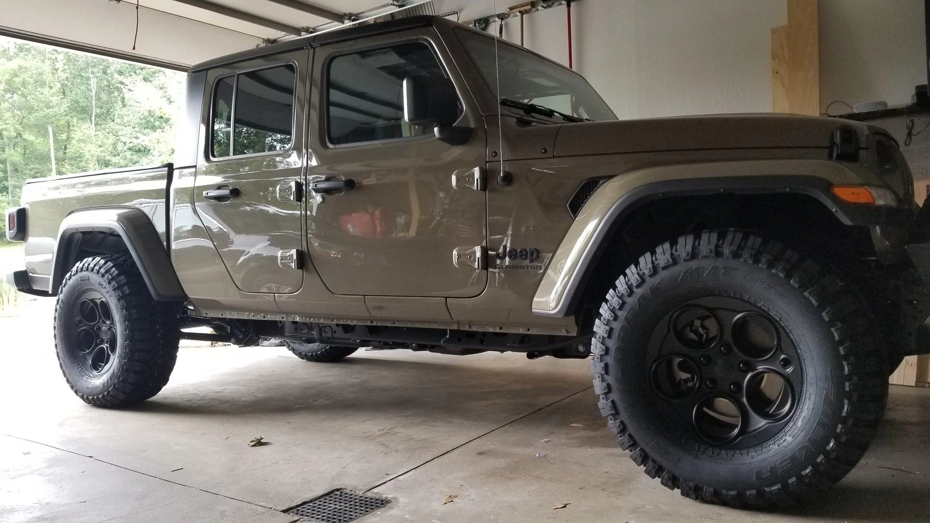

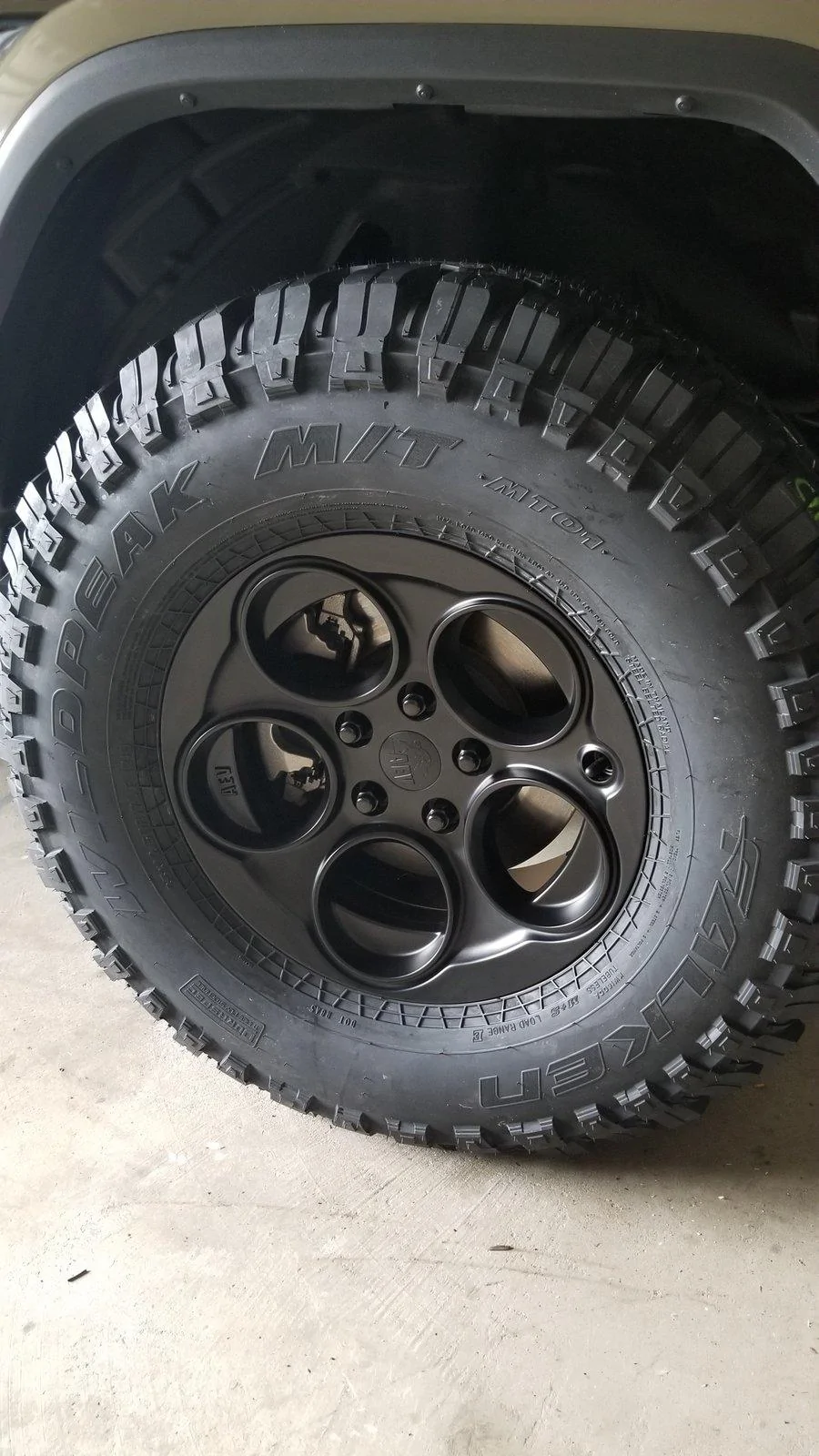

Sport S on 35x12.5x17 Falken MT. 1.5" Teraflex level spacer. I like the look for the street but pretty sure they will rub when stuffed. Looking at 2-2.5" lifts now, but the AEV wheel BS is causing some fitment issues. No rubbing now on the street so thinking Mopar lift will be the best solution. At least until AEV decides to release a lift.

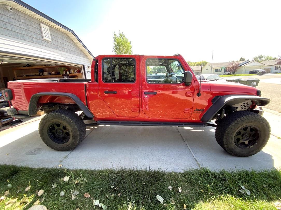

The diesels were announced with taller gearing, which already changes things to fit the diesel. So a major change in tire size still might need a gearing change, depending on your usage and terrain.
The diesels are come with 3.73 gearing. According to my official youtube watching research 37" tires work great without regearing and still use 8th gear plenty on the Diesel JLUR so far. I had 37" on my JLUR with 4.10 gearing and lost most use of the 8th gear with any type of wind. It still ran around great though and pulled my boat. This engine change is moving from 260 lb ft of torque to 440 lb ft of torque. My 37" STT pro tires on my rubicon would still just touch the fenders with swaybar disconnected with a 2.5" dynatrac lift and bump stop extensions. On some tougher trails at Moab the tread did catch a front fender liner and pop the plastic push rivet out. Easy fix and the combination was perfect for a low center of gravity but plenty of tire for way more than I had planned to do on the trails. A heat gun can help reshape some of the inner fender to a more desireable shape with less contact if needed.

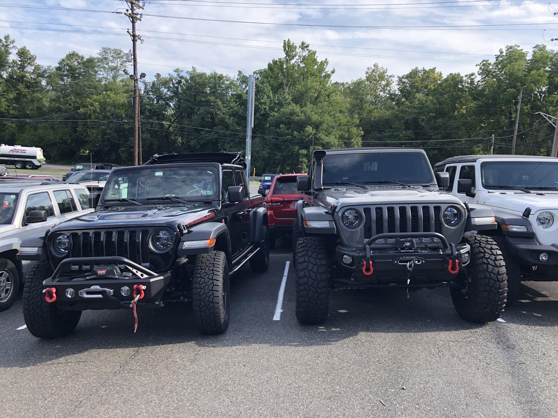

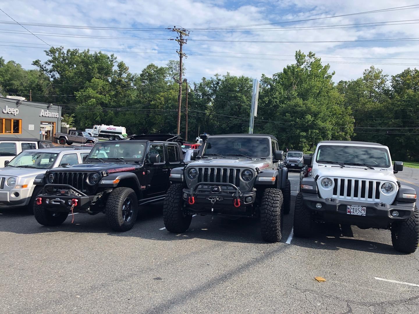

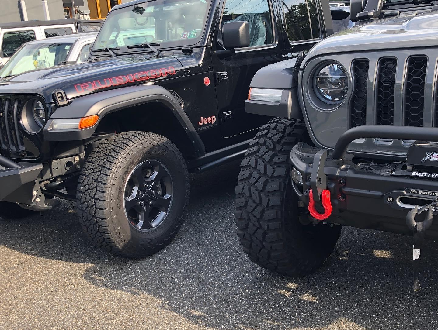

My contribution ....Mine is the black stock height Rubi on the left as you look at it. The one in the middle is on 37s. The white one in the right is on 35s

Can you share what the bumper is on the middle grey JT. Thanks.
