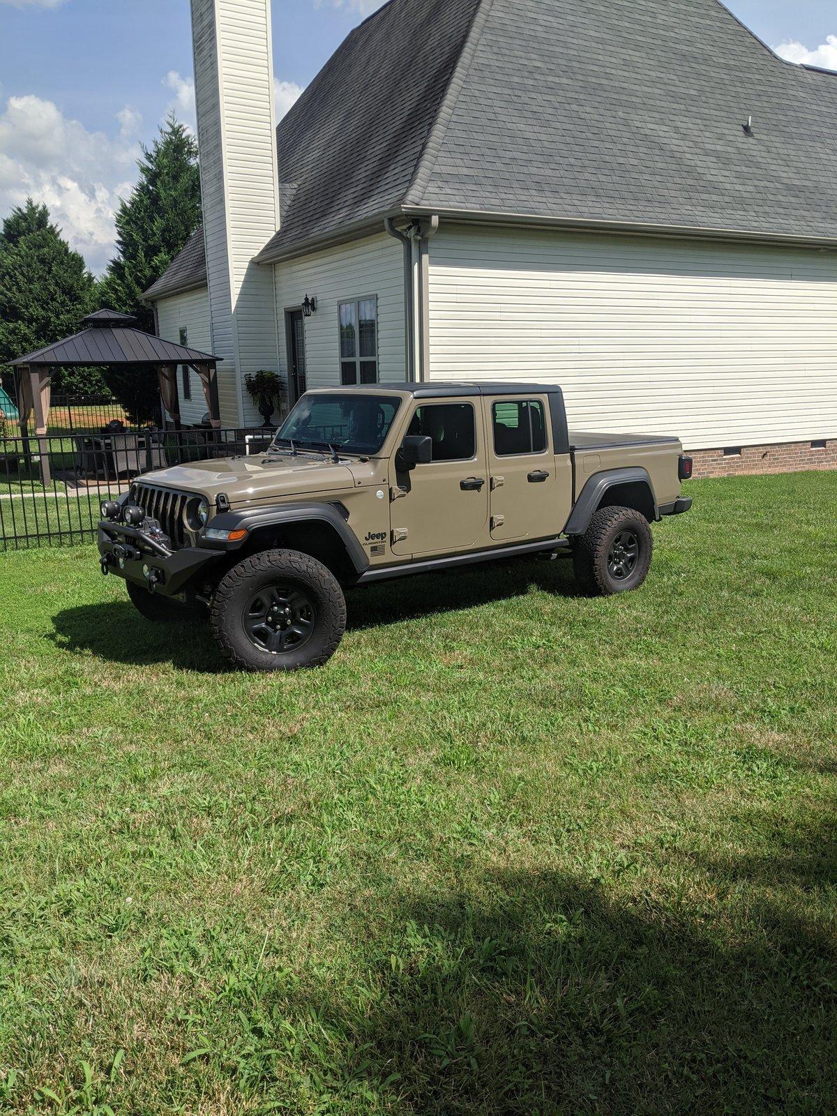

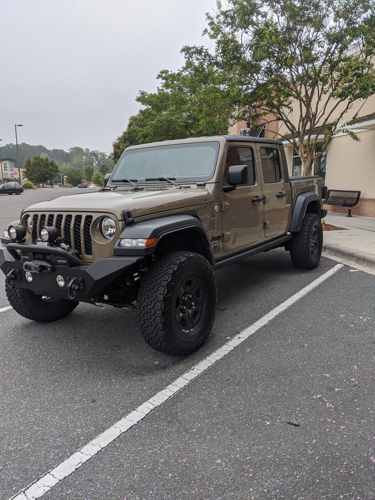

I got 315 70n17 BFGs on my Max tow and regret not going with 37's now that I'm still able to maintain 19 MPGs on 35's. That said if I had 3:73 gears I would not consider 37's unless I was going to regear. A guy I talked to at the gas station has 37's on his with 3:73 gears and his average on the dash was 14.6 MPGs and he said his speedo was dead on. I believe I could still get close to 18 MPGs on 37 12.5 17 BFG KO2s on mine and that's why I regret not going ahead and getting the 37's. If I did it and got below 16 I'd be disappointed. Here's mine on 315 70 17 with 2.5" Readylift sst lift kit and Rubicon take off front springs on a Max Tow
Jeep Gladiator Awful time deciding! 35 vs 37! Help! IMG_20200808_071524
Jeep Gladiator Awful time deciding! 35 vs 37! Help! IMG_20200801_160223

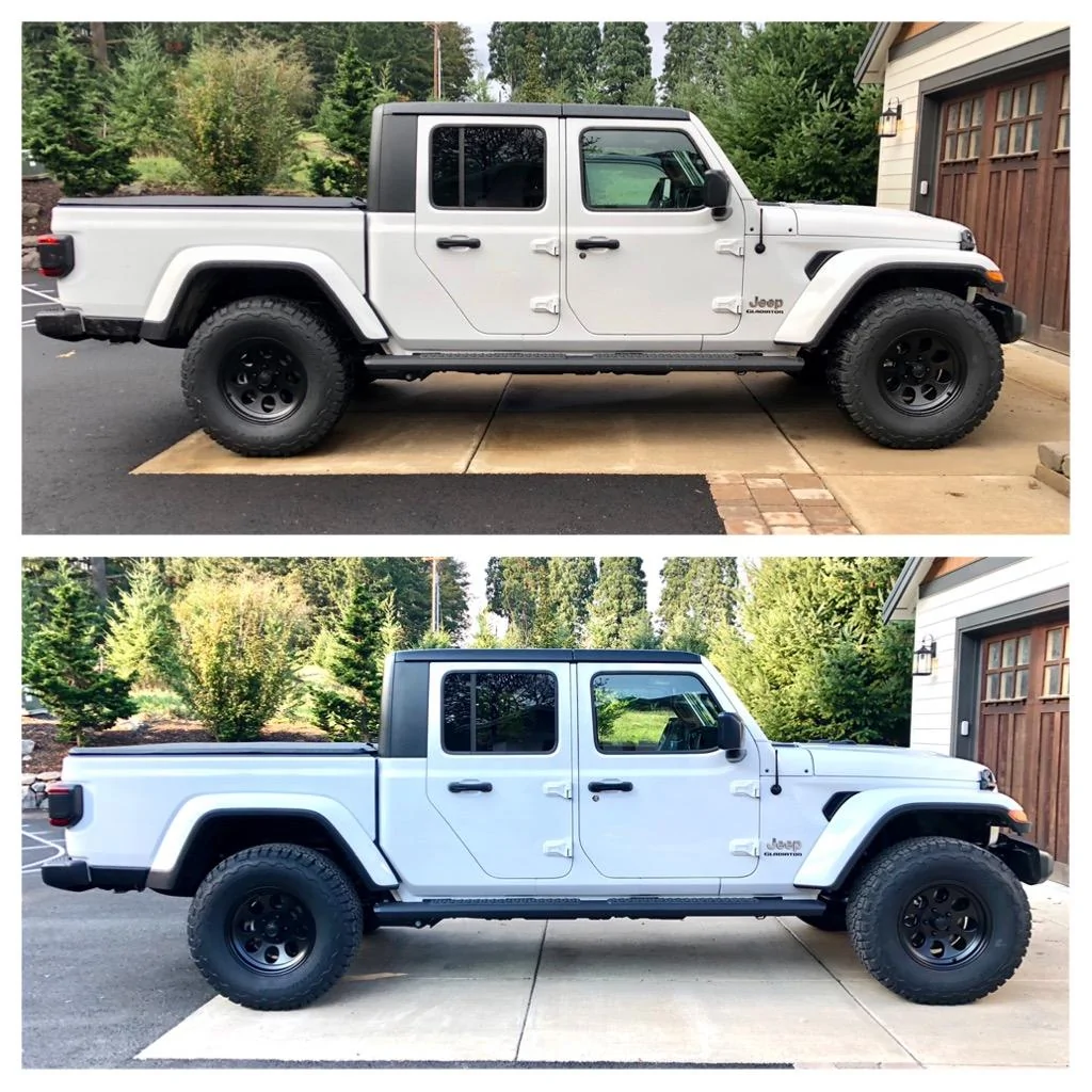

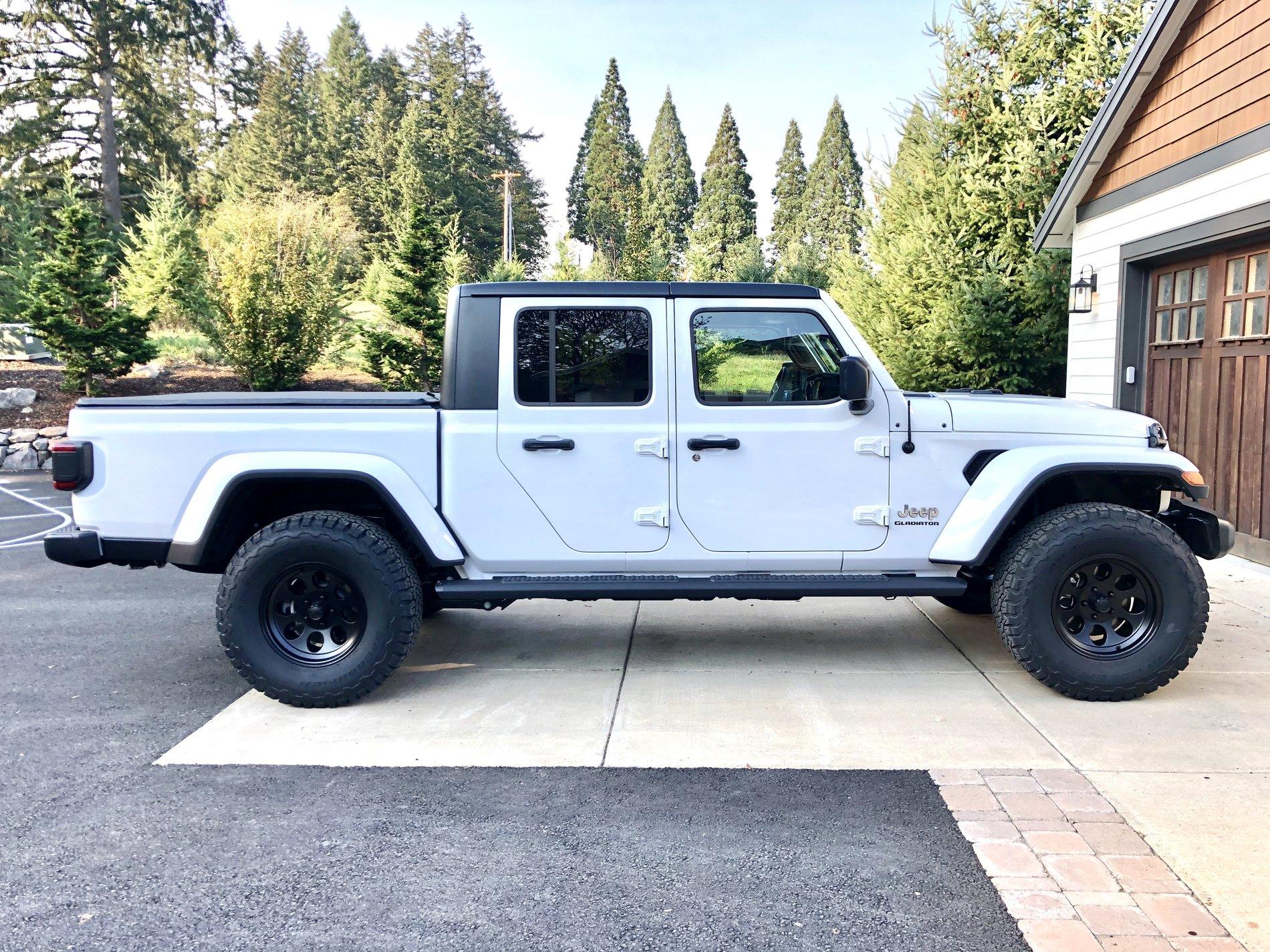

Funny enough one of my 35 pats failed the day after writing this and Iā€™m now on 37s. So to follow up, Iā€™m now on 37ā€ KO2s which are on the smaller side of 37s and itā€™s right on the line of what Iā€™d consider acceptable highway performance. 3.6L, 8 speed automatic, 3.73 gears with the Speedo recalibrated and itā€™s okay around town. Just okay. However it takes a lot for her to get going at high way speeds. Iā€™ll definitely want to regear before heading into the mountains later this year and Iā€™m expecting that towing a trailer this weekend is going to suck. (Iā€™ll add a picture so everyone can tell her sheā€™s pretty ā˜ŗ)
