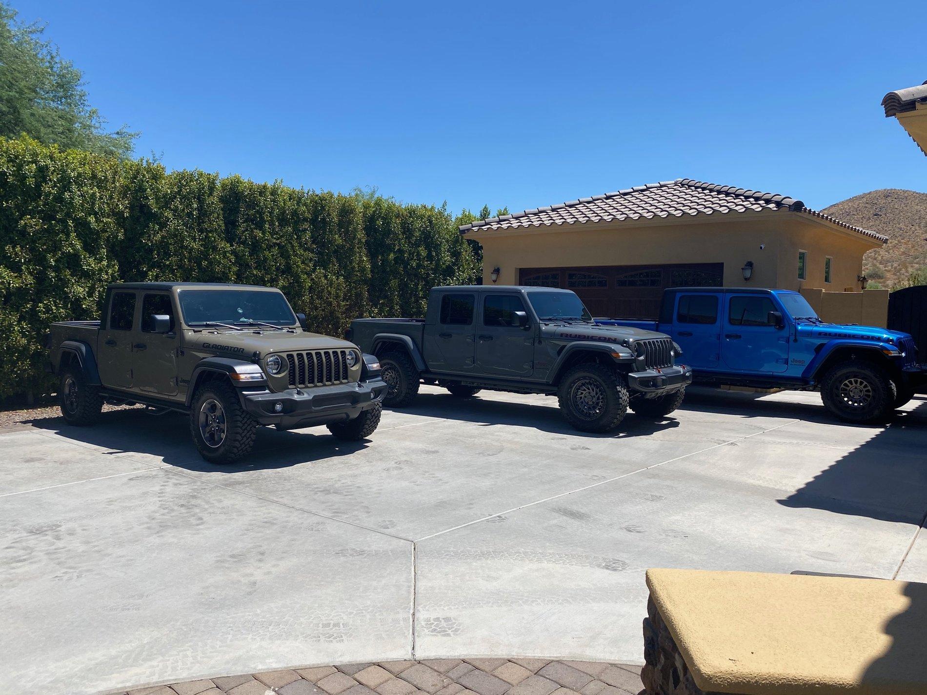

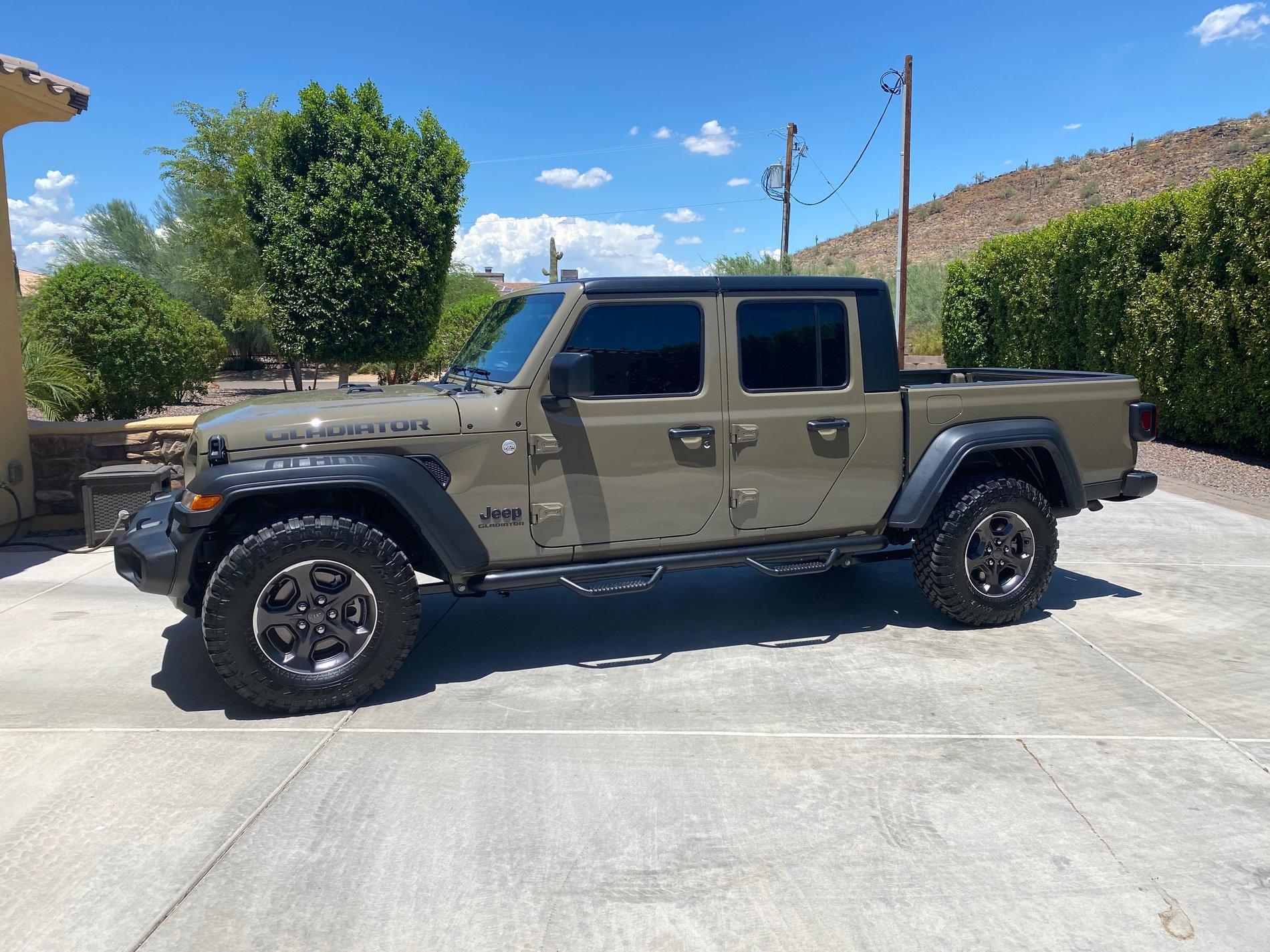

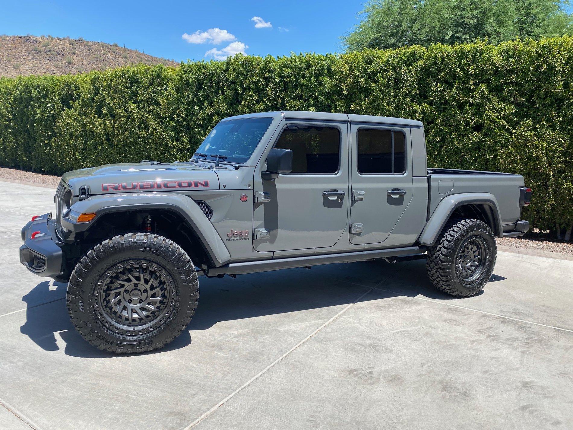

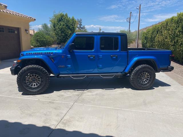

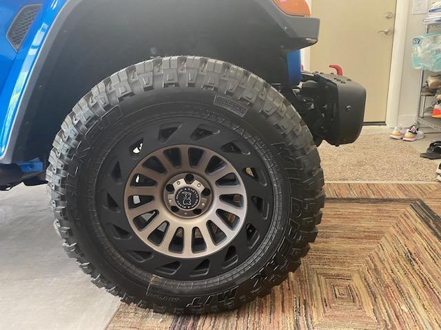

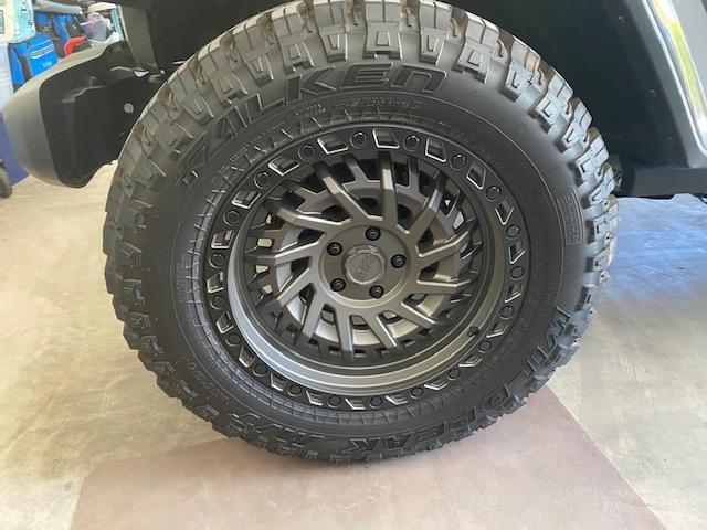

Well Im gonna disagree....
We have two Rubicon Gladiators and both are stock height. When I bought mine in July I went searching for wheels, with COVID, there were no 17" available that liked. All the ones I wanted were backordered with no estimated date for shipping. I always knew that I was going with 35's M/T because at the Rubicon stock height, to me they look perfect... so Ive been told dozens of times. So I decided to look at 20's when I couldn't find any 17's and many of the ones I liked I could get shipped and receive in days, so thats the route I went.
Im so happy I did. It looked so good, when I got home my wife said "I want that!!!".... and a week later she did. Both are 35" M/T on 20" wheels. I a side note, we have a Gator Max Tow and its on my old wheels which are the 33" M/T and I also think it looks fantastic compared to stock.
To squash some of the haters that dont like 20's....
Look at the pictures... specifically, look from the top of the wheel to the top of the tire... there is 6 1/2" of side wall, thats plenty for everything I plan on doing at home in AZ.
I think the 35's are the way to go.

This has won me over. Thank you for helping me make my decision. I'll be going with 35's. I don't necessarily want to mess with re-gearing (not yet at least) or killing my gas mileage. I think the 35's look GREAT with 20's on your Jeeps. Thanks man!

You have no lift on either?

The grey, blue, and gator pictured are all 100% stock height the exact way they came out of the factory. No spacers or modifications of any kind.
Heres a different picture of them if that helps better to show the height.

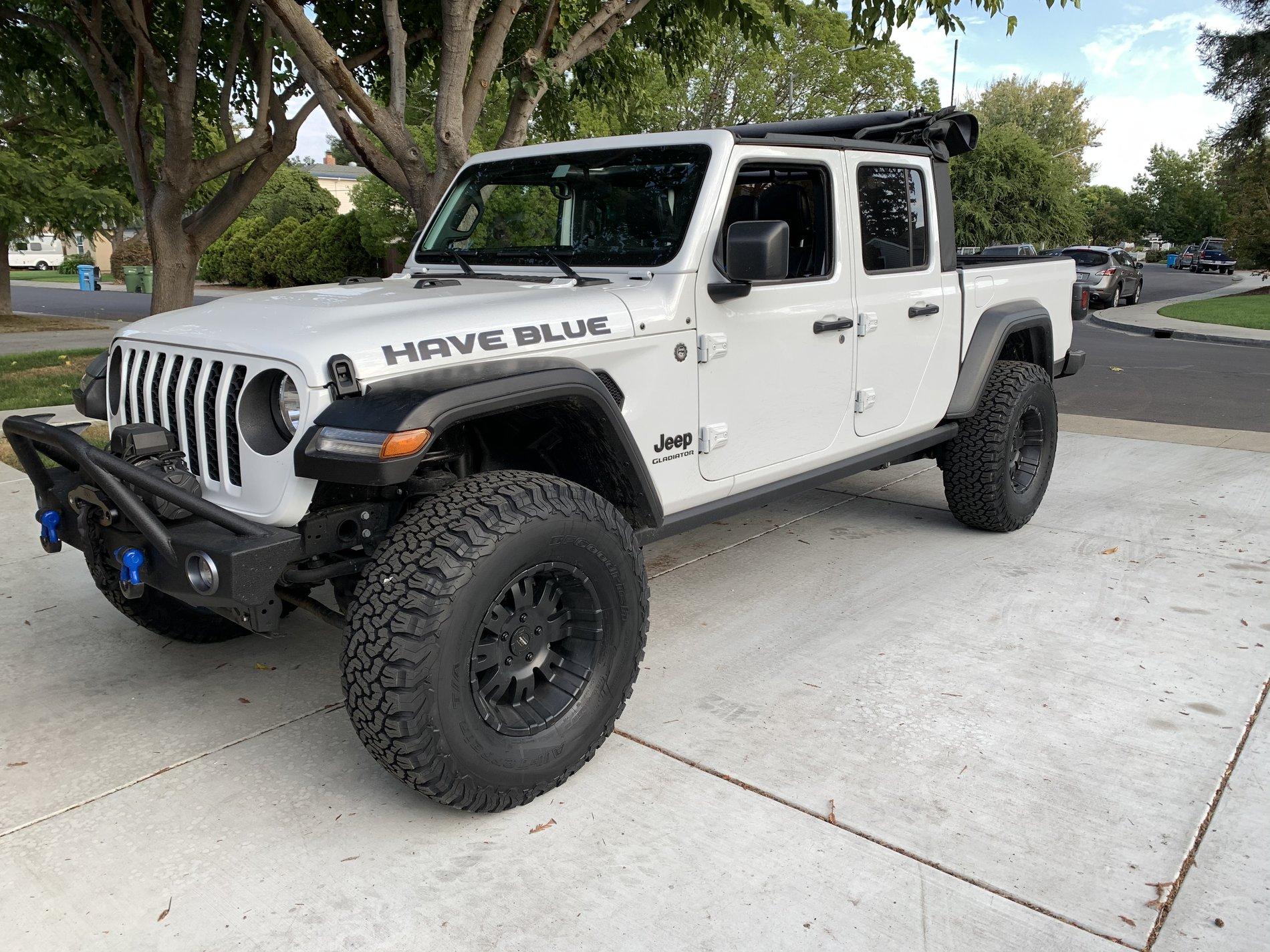

Where do you live? Like mostly flat highway driving or hills, mountains etc? Also do you plan on towing much?
I’m on 35s and 3.73 and it’s perfectly adequate for city/ flat highway driving, But as soon as I get up into the hills I can feel her struggling and jumping around gears. I’ll end up going 4.88s when I do 37s and recommend it to anyone who wants to maintain drivability in these cases. 35s are tolerable on 3.73 but 4.10 would definitely be the sweet spot here.
Funny enough one of my 35 pats failed the day after writing this and I’m now on 37s. So to follow up, I’m now on 37ā€ KO2s which are on the smaller side of 37s and it’s right on the line of what I’d consider acceptable highway performance. 3.6L, 8 speed automatic, 3.73 gears with the Speedo recalibrated and it’s okay around town. Just okay. However it takes a lot for her to get going at high way speeds. I’ll definitely want to regear before heading into the mountains later this year and I’m expecting that towing a trailer this weekend is going to suck. (I’ll add a picture so everyone can tell her she’s pretty ☺)
