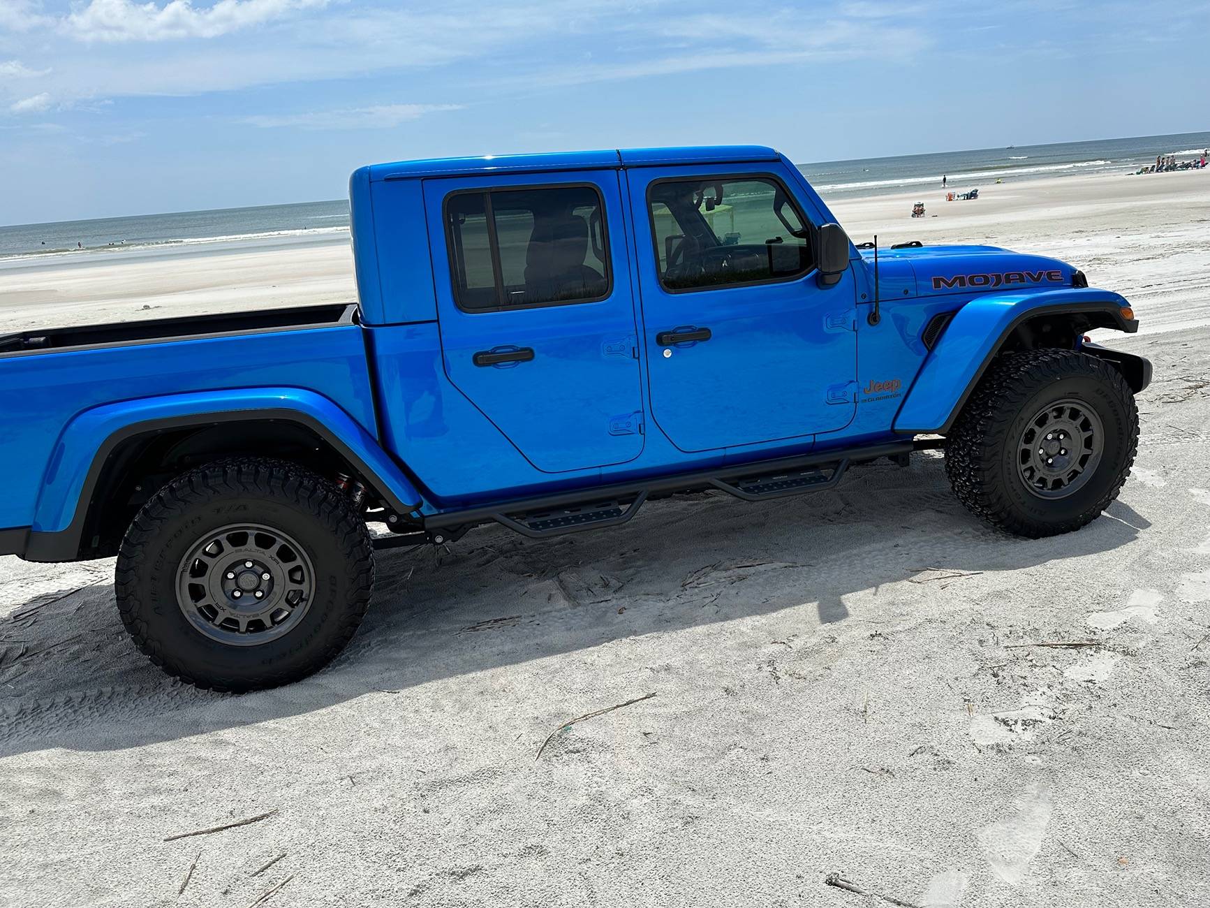

My 2 cents. 35/12.5 all terrain on AEV Salta II Wheels works for me on the beach and around town. I also pull a 20’ boat.

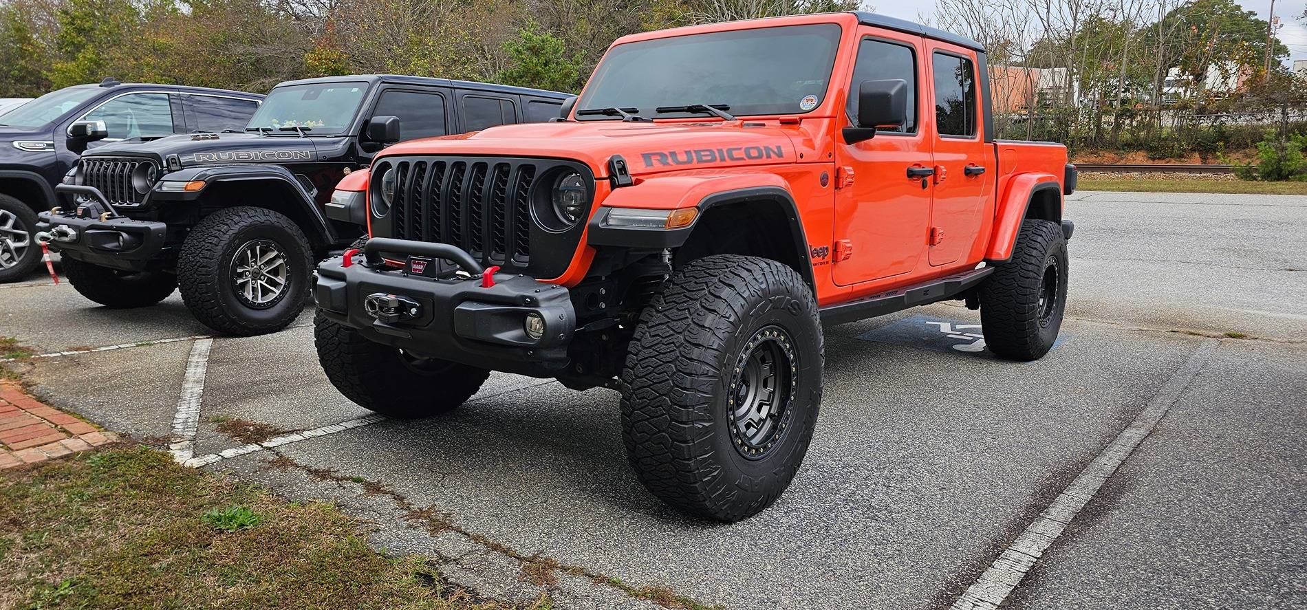

Mojave on 37s all day. Looks spectacular in my opinion. I was going to go 35s but when people in here said they got 35s and then regretted not getting 37s there was no way I was putting my pocket book in that position lol
I'm going to install the same tire but went with 11.5" with the stock wheel.
