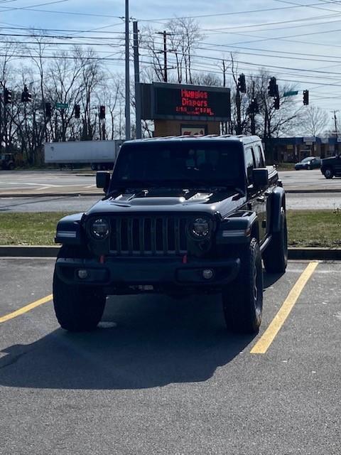

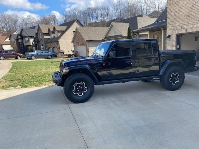

I installed 37x12.5x17 on my stock Rubi this weekend. I had a little rubbing at full turning on the skid plate up front, once I removed the skid plate I have full turn travel with no rubbing. Going to replace the factory steel skid plate with a OEM cut skid plate. Tires are Nitto Terra Grappler. During my first few trips I noticed that the speedo was off from my cell phone speedo app. Took her on the highway yesterday and it seem to be spot on speedo and speedo app. On my way to work this morning city driving still spot on. I am trying now to get my PSI down to 37 psi when cold. Overall ride was nice and no complaints. Gladys has 20030 miles currently.

If you phone was plugged in while measuring the speed, it is drawing the data from the Jeep instead of measuring on its own. Unplug it and you should see that it’s about 12% off after moving to 37s.
