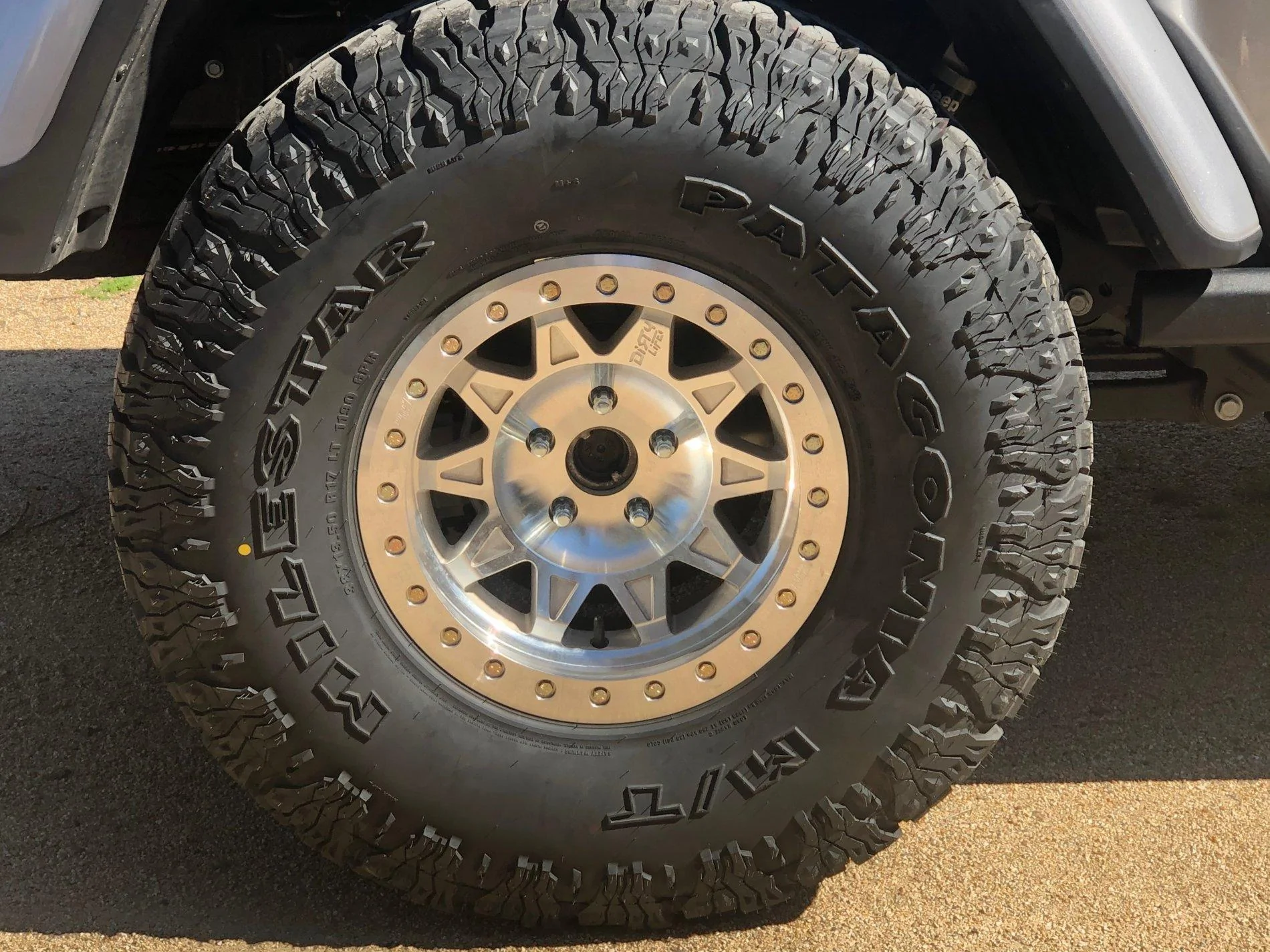

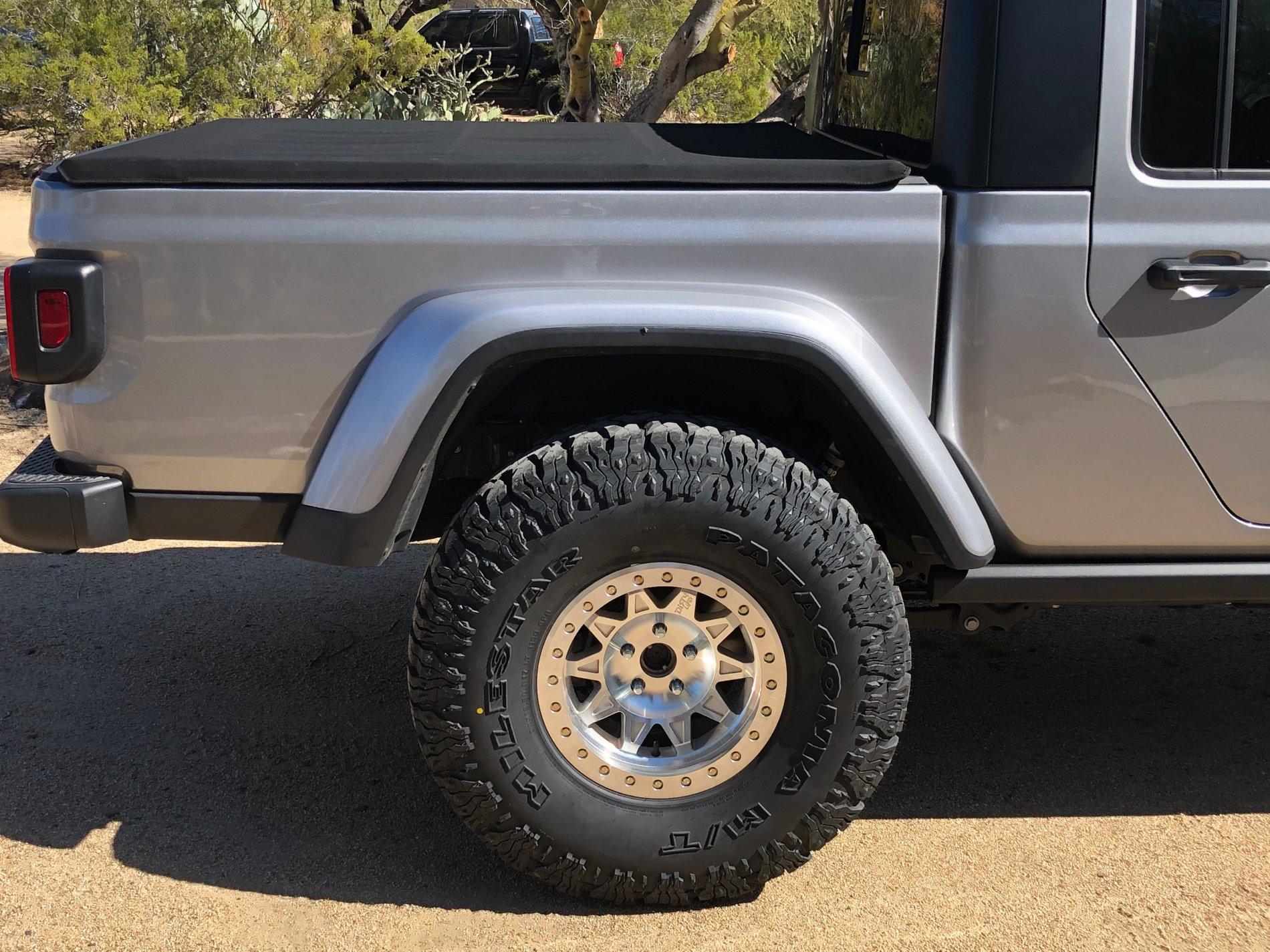

I have a friend that runs in the Everyman Challenge at the King of the Hammers and he has been sponsored by Milestar the past several years. He has never had a tire issue, even under such grueling circumstances. We put these on my son's JK last year and realized they were not noisy and handled well compared to the prior tires he had. I recently put the Milestar Patagonia M/Ts on my Gladiator and I am pleased with the noise, handling and price of these tires. They are also much less expensive than the other brands with Discount Tire carrying them for $255.
https://www.discounttire.com/buy-tires/milestar-patagonia-m-t
Below are a couple pictures of the 38x13.50R17s I mounted on my Gladiator.
