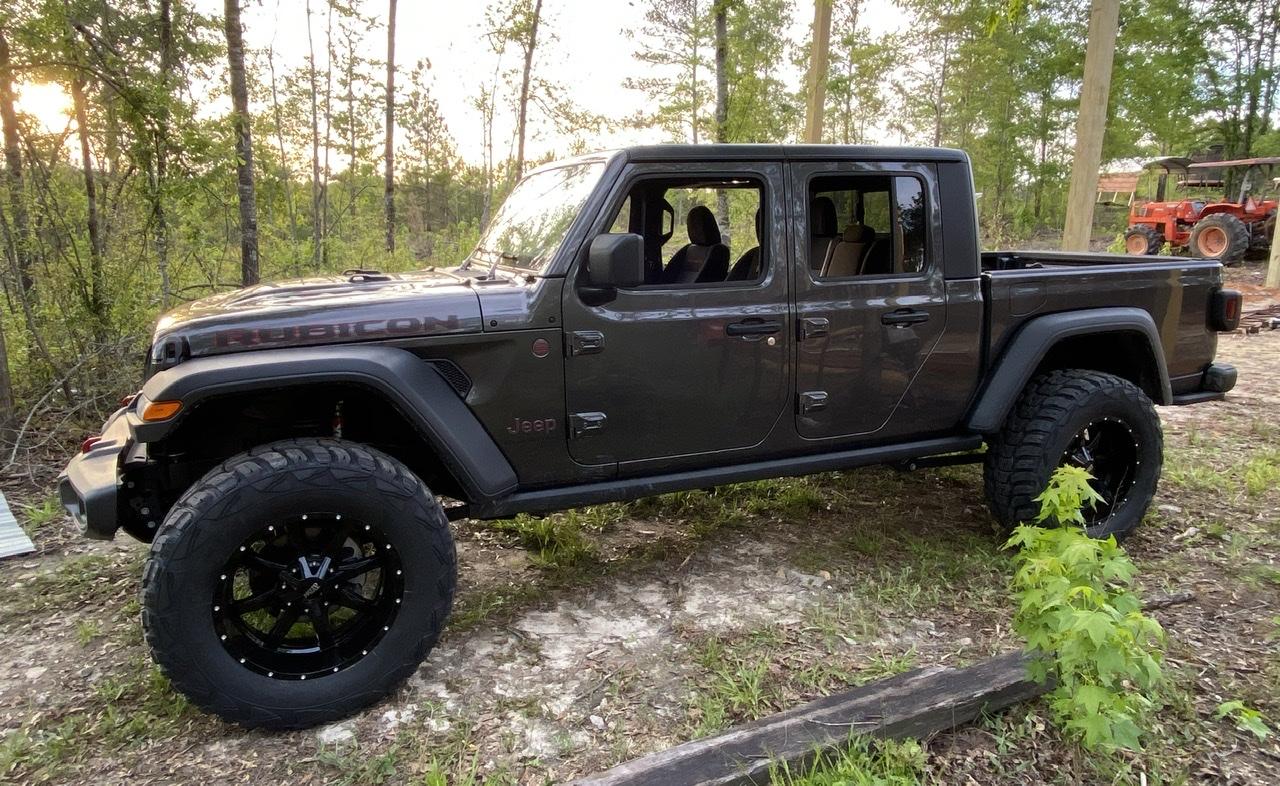

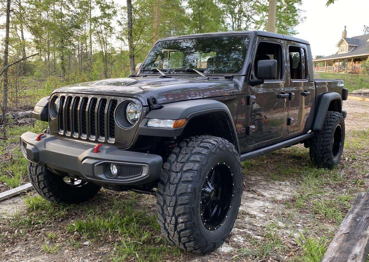

37x13.50r20 on 20x10 -24 offset... :like:

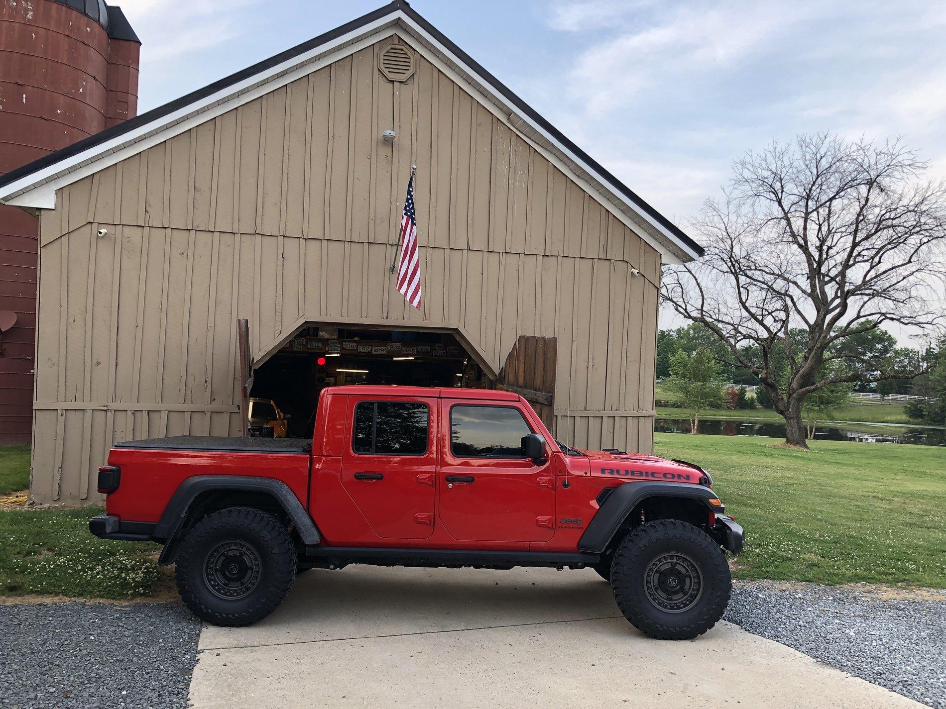

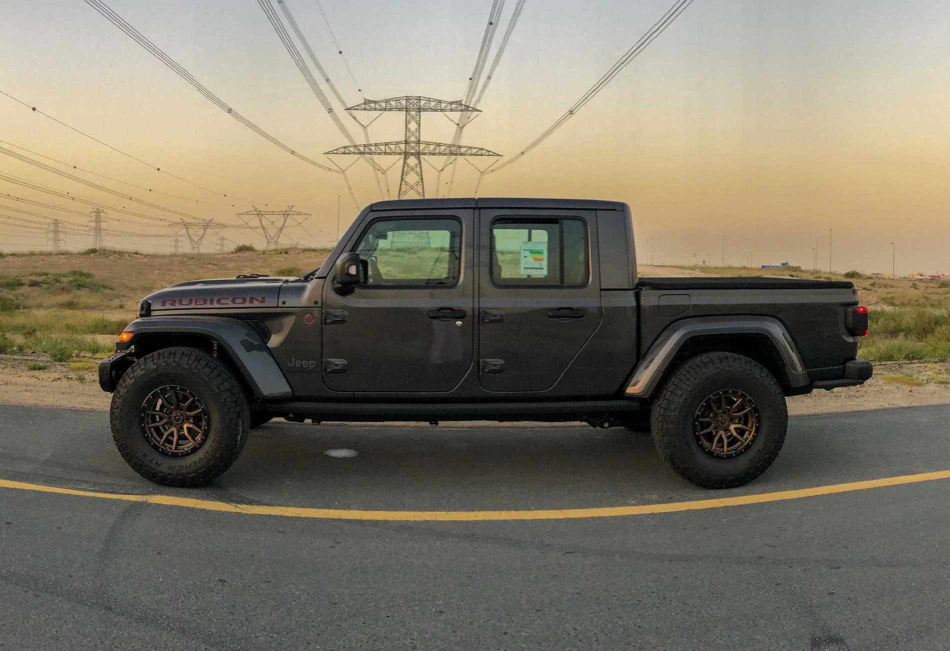

Love my 37s and drove from FL to Va 1000 miles in one day and 75-80 mph like nothing. And the beefier brakes being a Ram 1500 rear suspension definitely makes a huge difference over the JLs and JKs really can’t compare.
Jeep Gladiator 35 or 37`s What To Do? 3F10E742-510F-41D2-9DB4-FB761CE75A96
Looks great.... no lift right?
