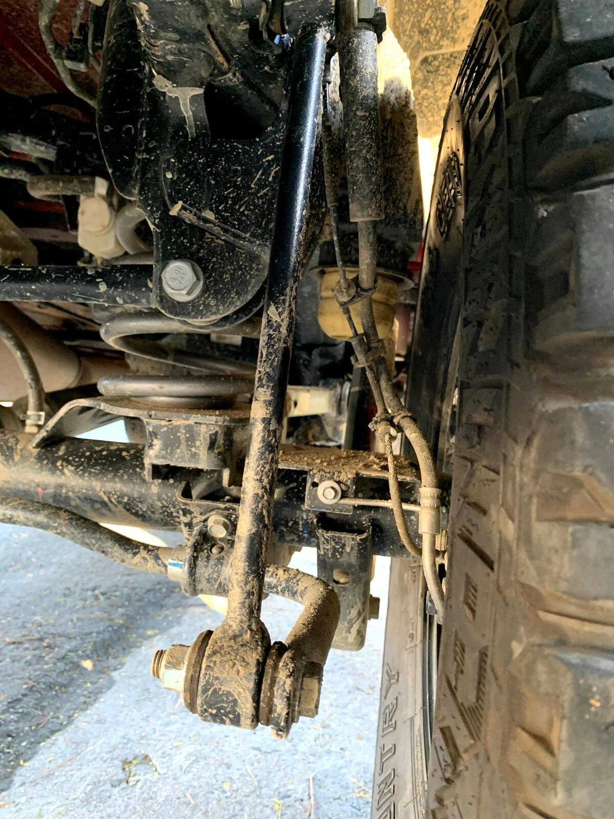

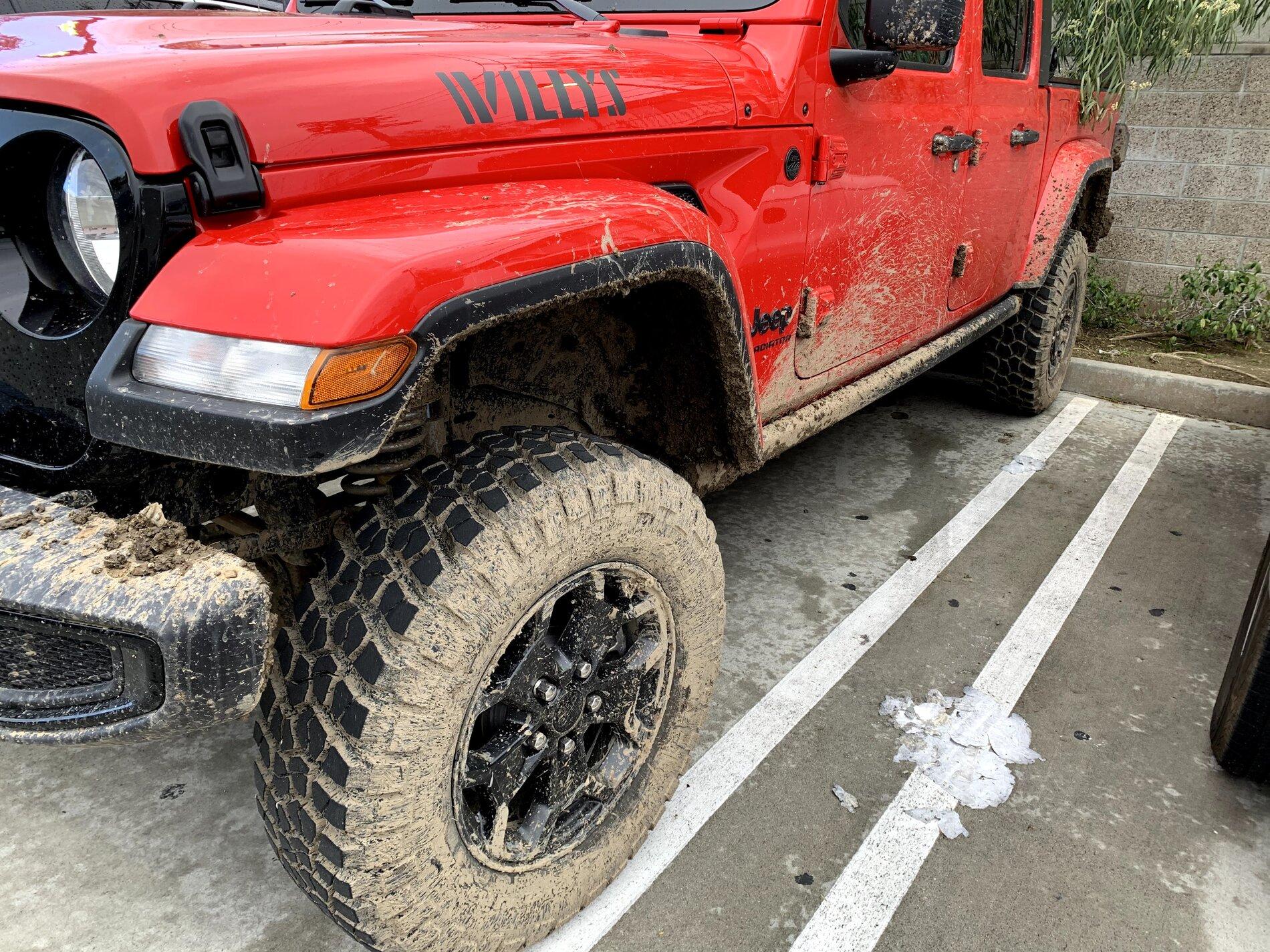

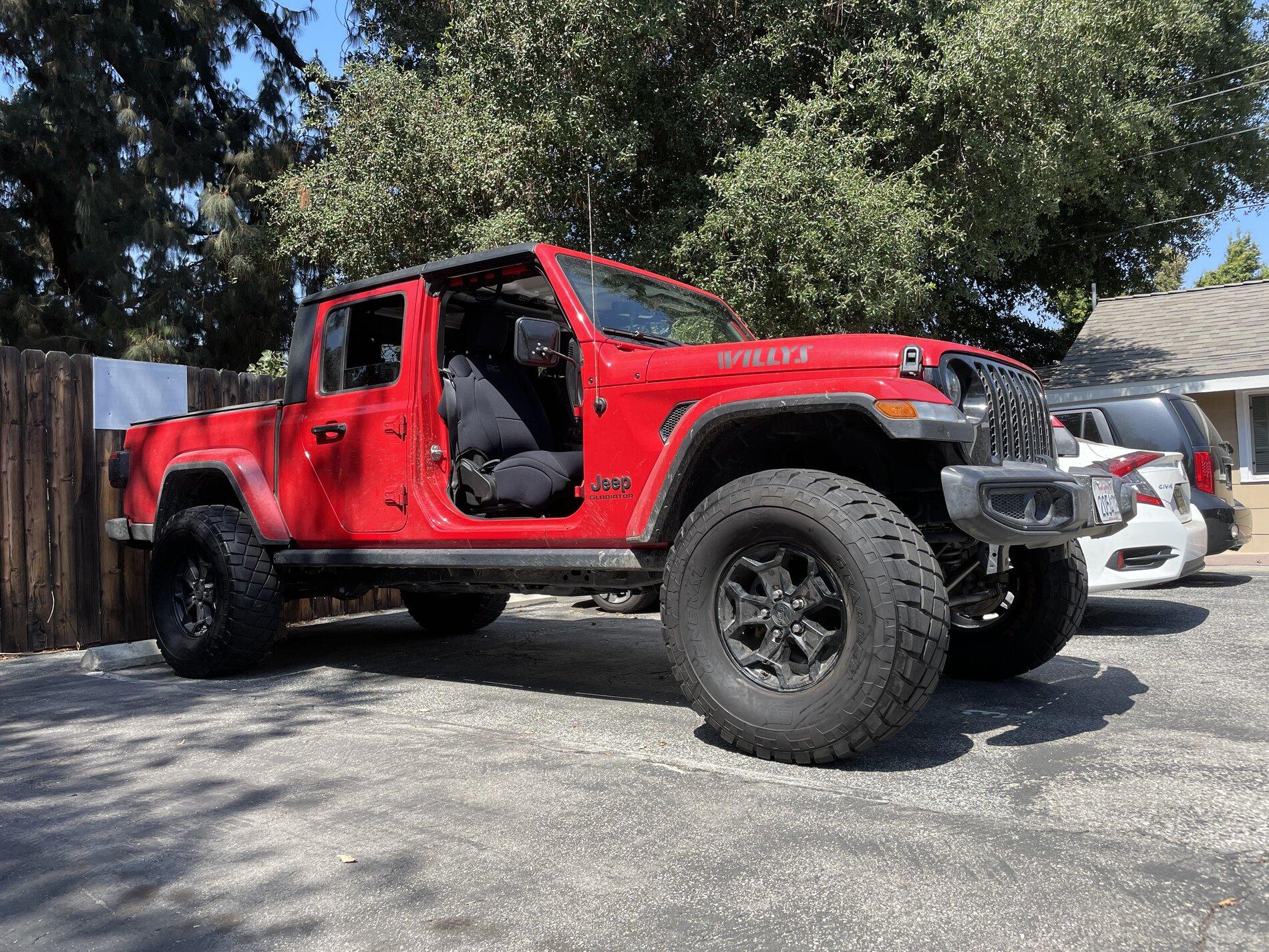

First thing I installed was a RC 3.5 in lift. I know; not the best. It doesn’t the job for ME. When I installed the 35s my rear tire was barely missing the frame. This is why I went out and got the spacers. Had I gone off-roading like this, I am positive there would have been contact. I’ll try to find a pic of that. I took one a while back. By the way, I bought my 35s used. And my current 37s used. No issues and dirt cheap compared to paying $300 each tire.

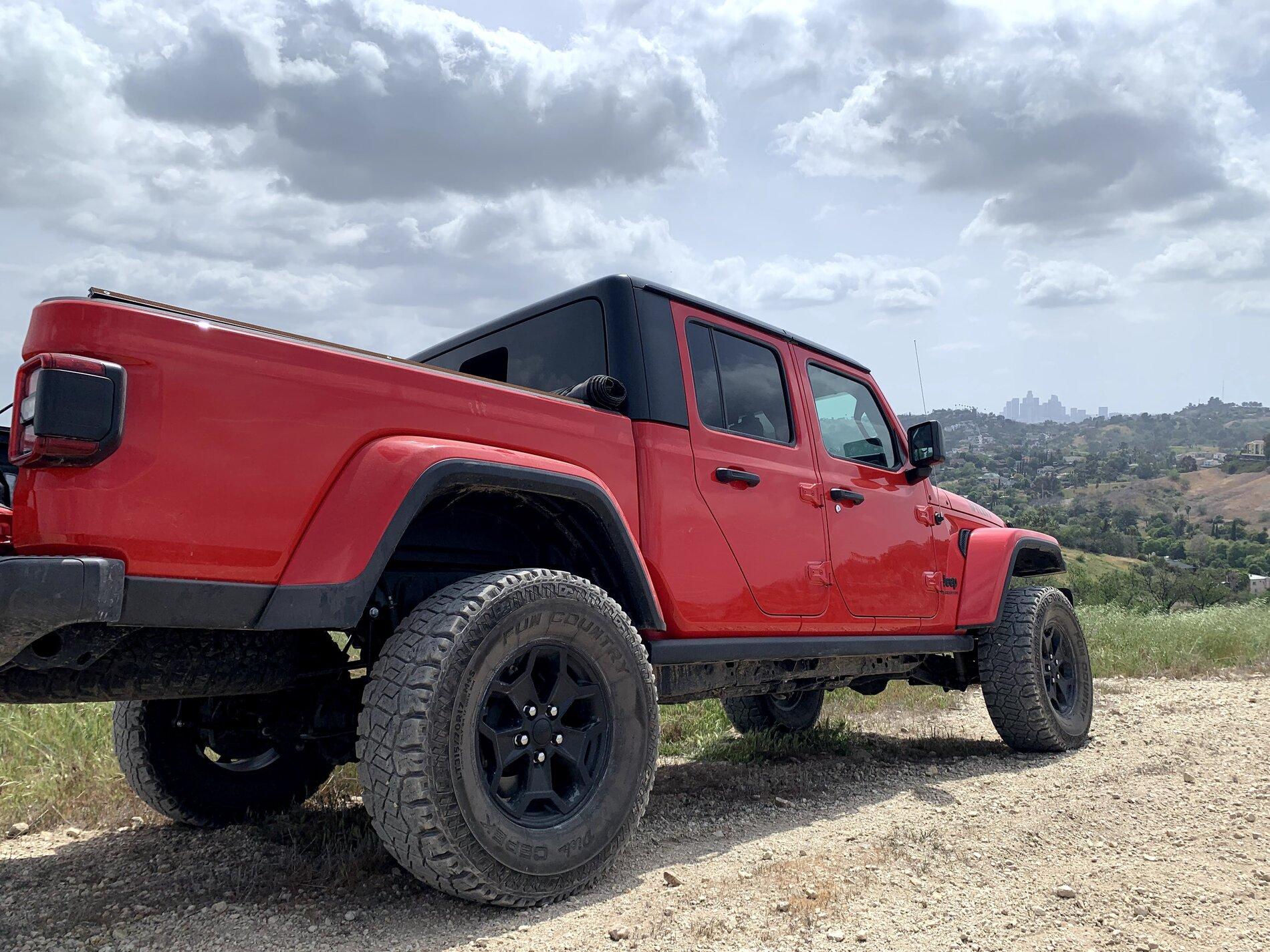

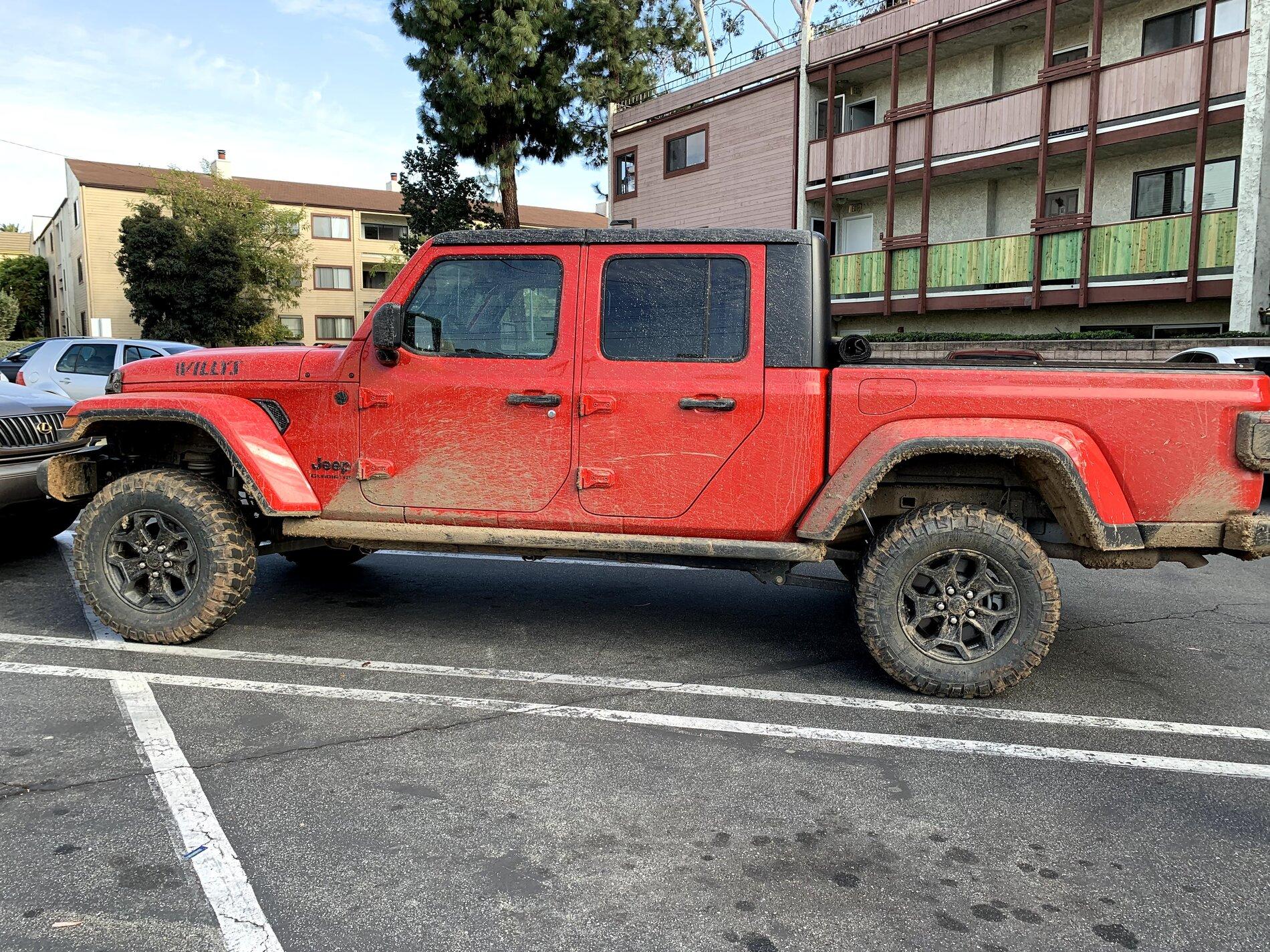

I included 2 photos on stock tires with a 3.5 in lift before I got the used 35s.
And the 3rd is the rear tire.
