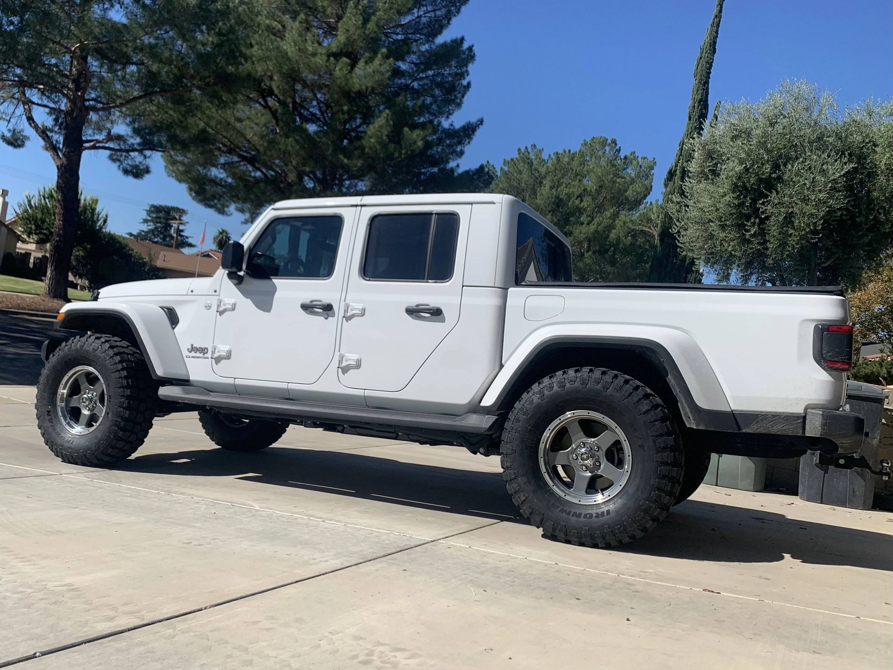

I have 37Ă—13.5s with an AEV 2" spacer lift for now. 16,000 miles on this set up and it's been great been to 12 different states and a fair amount of wheeling and has done me well.
I'm going to finish out my Metal Cloak 3.5 Game changer lift and 5.13s in the coming months.
Bottom line are 37s on 4.10s doable and easy to live with, I say yes. And I'm coming from build GM trucks that were geared, cammed and stalled. I'm not disappointed at all. Works surprisingly well. Expectation management is key. Yeah I'm not hitting 100mph in 3rd gear.......but it's a different platform and use
Take my opinion for what it's worth. Either way I don't dread or hate road trips, I enjoy them
