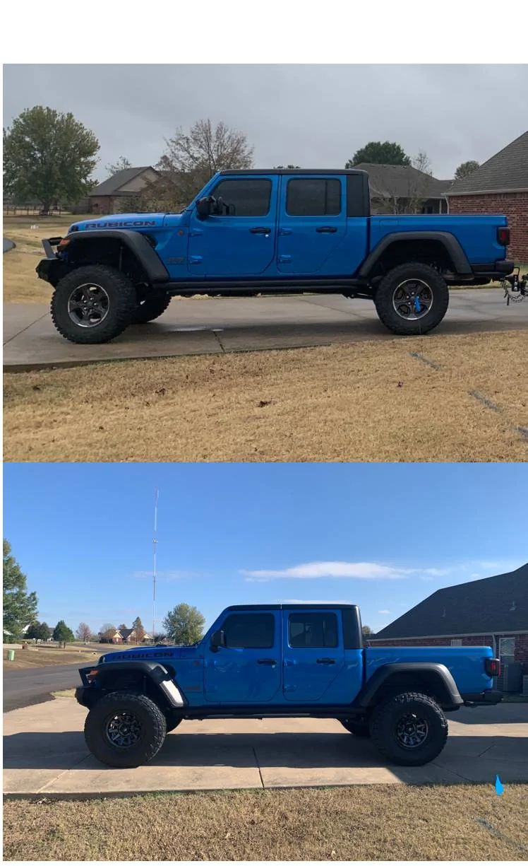

Jeep Gladiator 35's vs 37's? IMG_7118
35x12.5x17 Mickey Thompson Baja Legends MTZ to 37x12.5x18 Nitto Recon Grappler. 3.5 inch Metalcloak lift.
Had no issue with 4.10’s. Recently went to 4.88’s because of towing a travel trailer - definitely notice improved performance towing. Noticed improved performance when not towing (it is really nice) but the coin you gotta drop to regear I would not have done if not needing improvement for towing.

I have a rubicon diesel on 37’s. Going on 40k ish miles. They run great Yokohama geolander MT’s. Getting a little loud in the last 4k miles. But nothing crazy. Will get another set when due for replacement.
- 18-21 mpg loaded.
Is that an ARE camper shell you have there? If so is it the standard or HD? How much weight are you putting up there? Love the look! Thanks!

Looks good! How heavy is your travel trailer? Who did your re-gear in OK?
