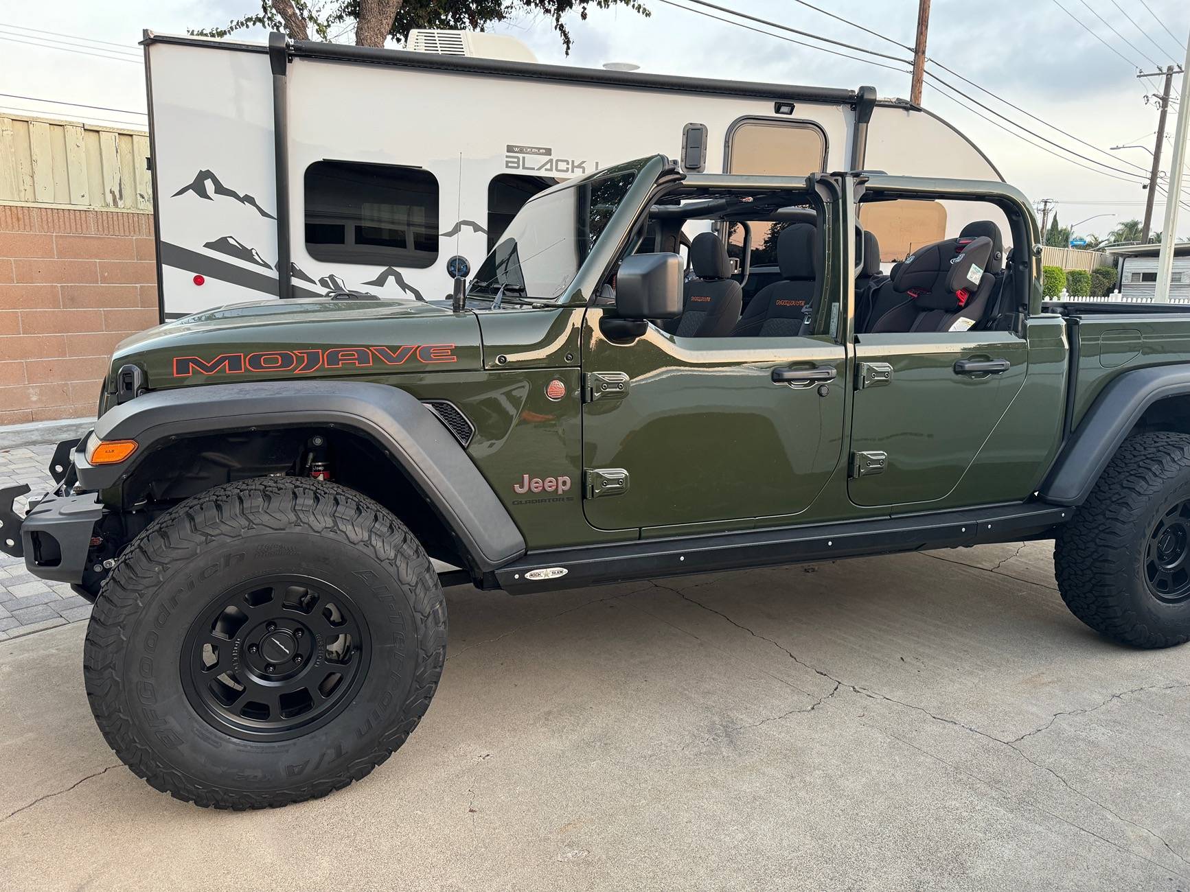

nope... still stock 410s here on my Mojave with 37s... spent some time to find the lightest weight tire and wheel combo I liked... super happy with my set up! I did put some Synergy springs, little heavier rated front and rear, and a two inch longer rear spring to compensate for weight (winch, steel bumper, sliders, Decked with gear) now it rides a TINY bit higher than stock in the rear, perfect for towing the trailer in the pic!

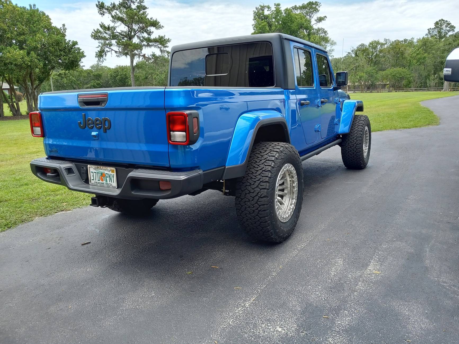

‘21 JTRD - '08 Dodge Ram 2500 4x4
Since the Mojave has an upgraded suspension I used the AEV 2” spacer for mine to retain that suspension. When I wear it out I’ll decide then whether to rebuild those shocks or go with a bigger lift but at this point I think I have plenty of clearance.
I also think you’ll like the 37s better but you’ll also need to get 9” wide wheels to get a wider 37 than 11.5” which is kind of skinny for 37s.
8.5’s will help save the rims. It’s the minimum recommended wheel width by most tire manufacturers for a 12.5” tire.

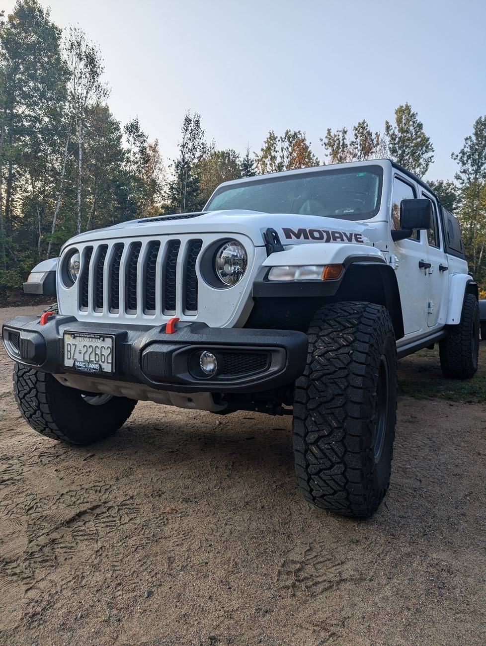

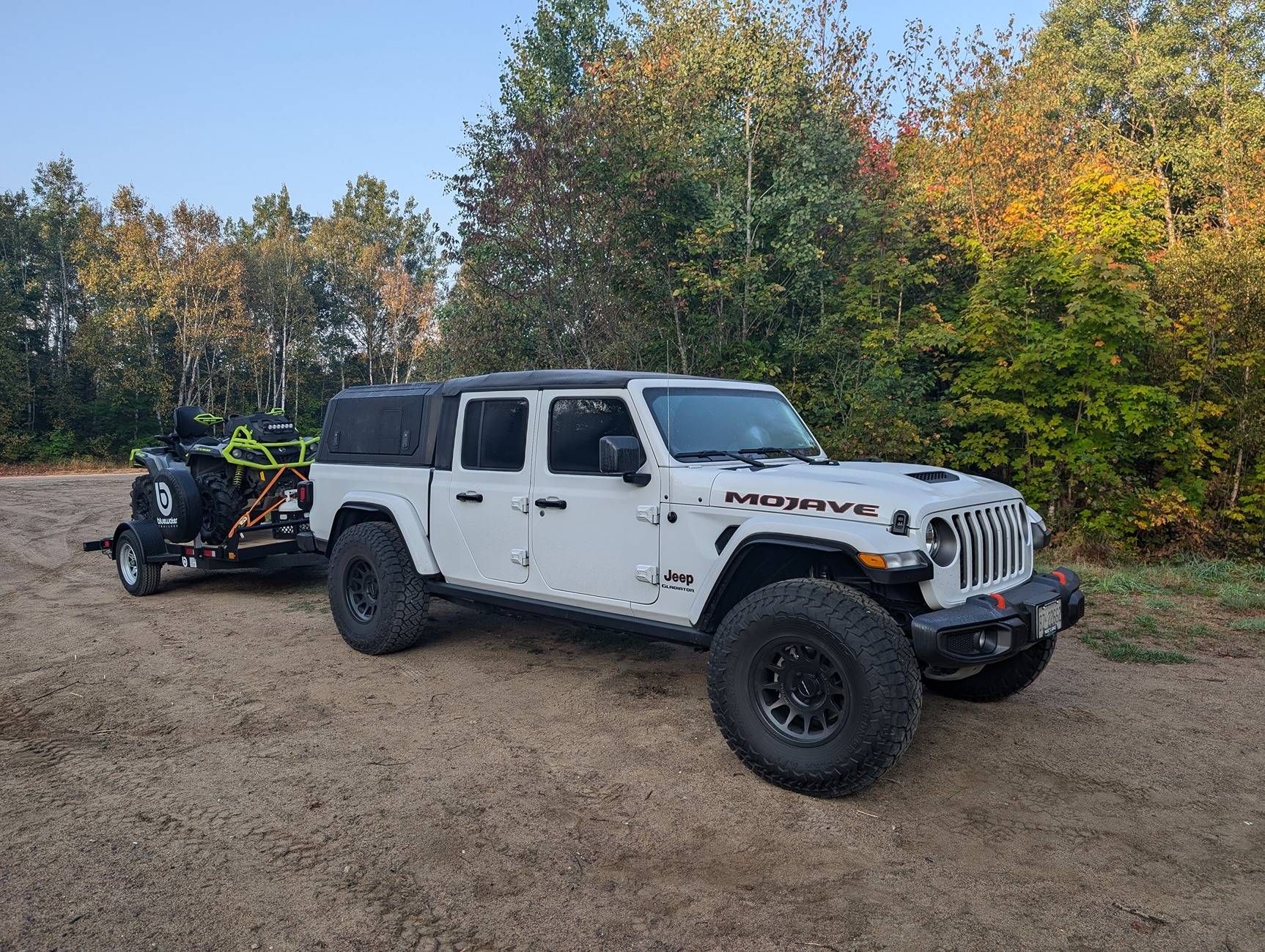

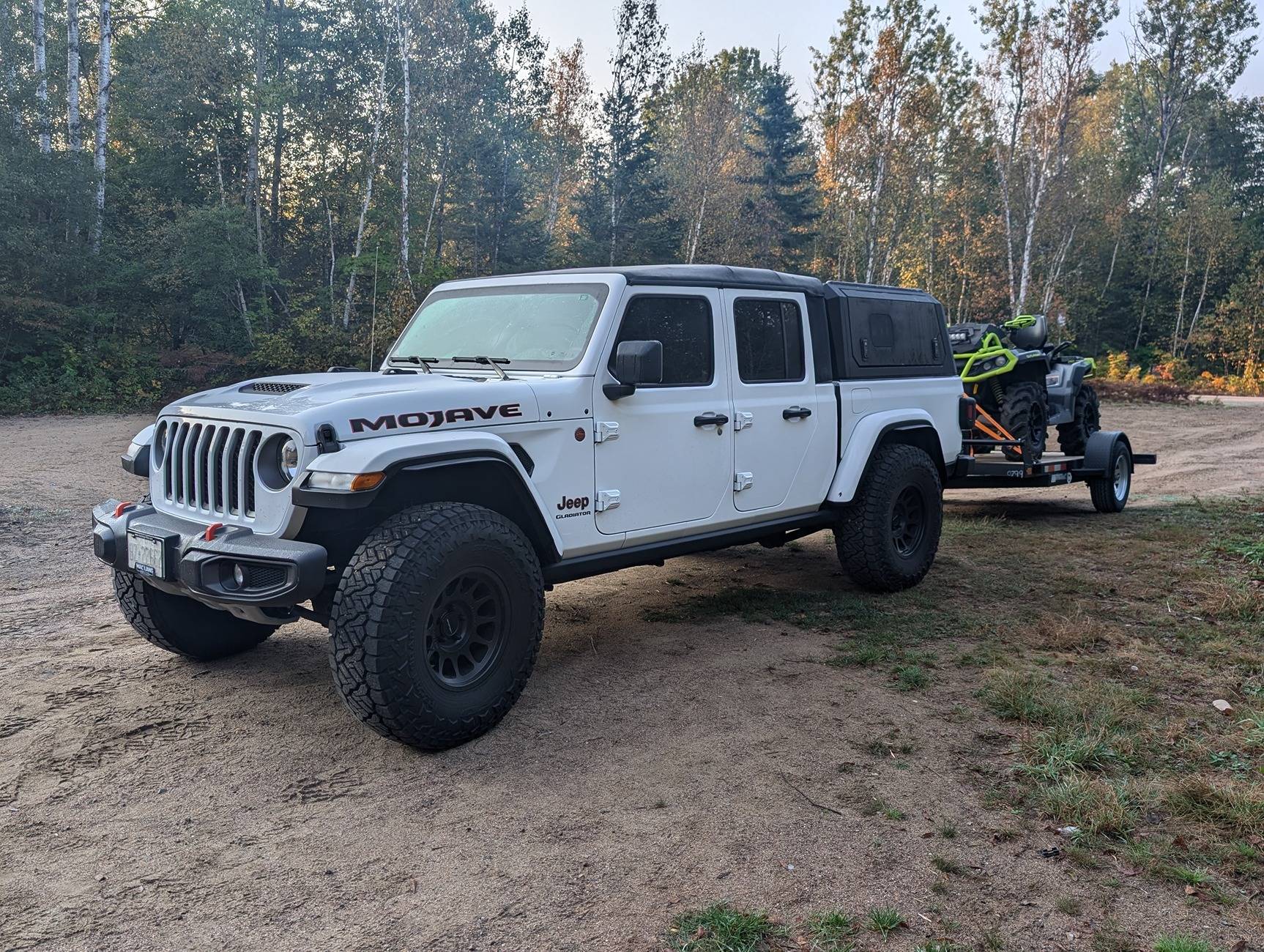

2023 Gladiator Mojave
Thank You guys! The Glad looks great! Mind is white as well! I think there is no doubt that the 37's look better! Glad to know you used the spacer lift as well. Did you have much reduction in power? Other guys recommend of course re-gearing. I do very little off road so really prefer not to due to expense of course. I'm not much of a mechanic to do anything on my own.
I didn't regear mine. Still have the 4.10s and for everyday use it runs fine. My fuel mileage hasn't changed. I do feel a difference towing my ATV but for the amount of times I tow with it I can live with it. Fun fact I can still chirp the 37s with my 4.10s so it can't be that bad. Obviously the regear would be better but for my needs it's fine the way it is for now.
