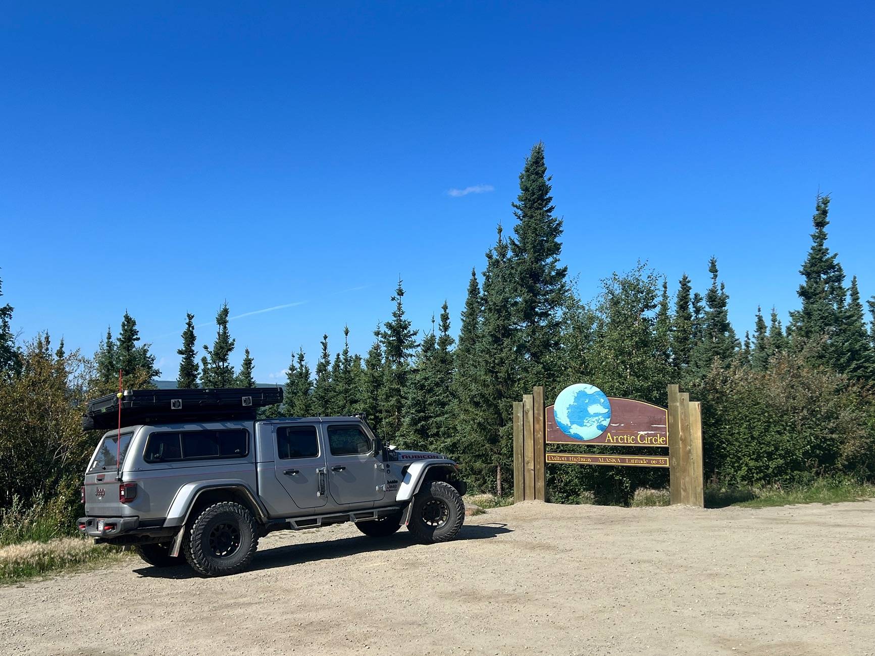

I have a rubicon diesel on 37’s. Going on 40k ish miles. They run great Yokohama geolander MT’s. Getting a little loud in the last 4k miles. But nothing crazy. Will get another set when due for replacement.
- 18-21 mpg loaded.
