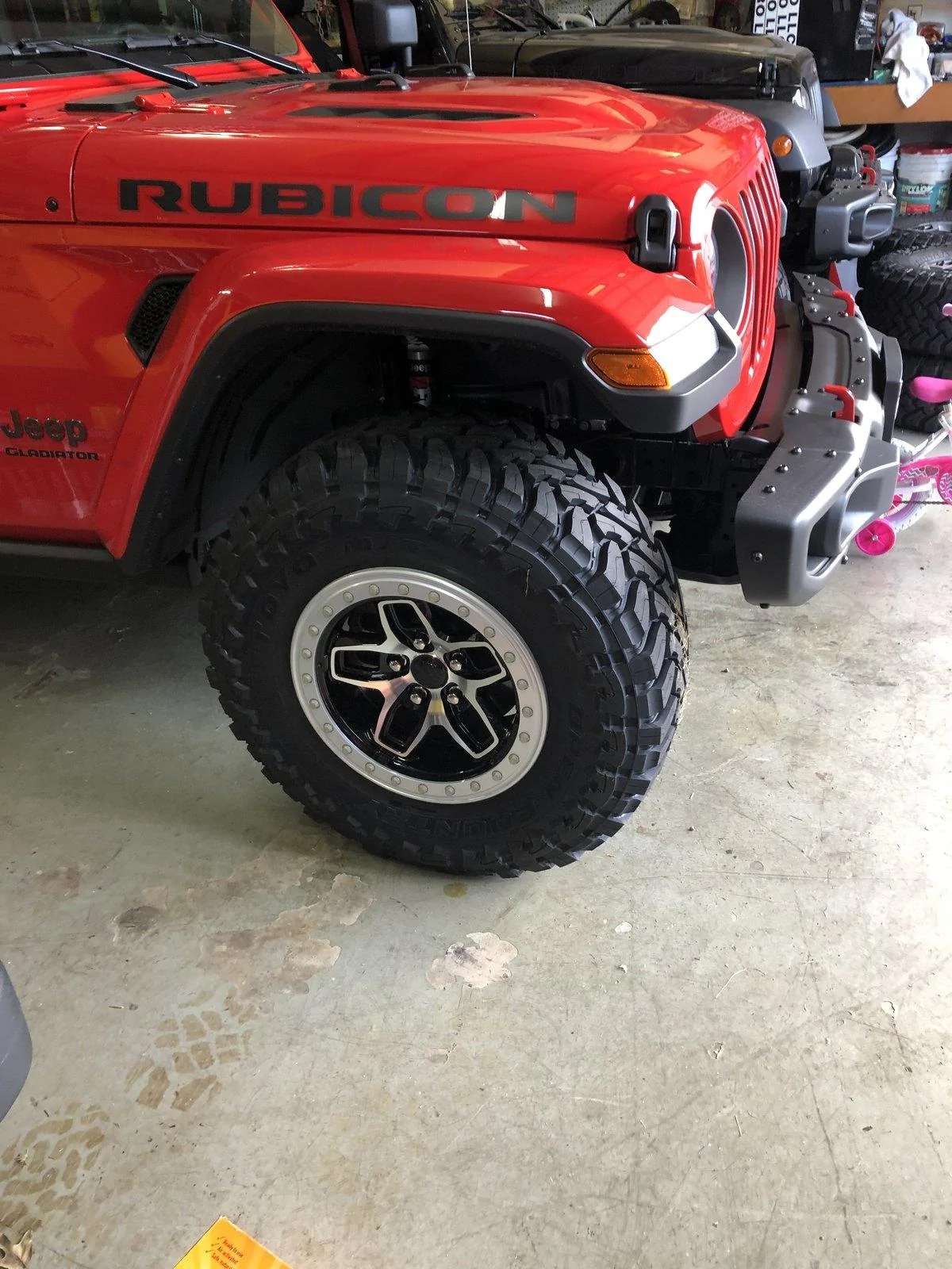

Don't forget the D44s in JTs are larger and thicker (by 10mm) than JLs. I run 37s on both my JTR and my JKUR and have never seen a problem, and I DD them, rock climb them and have been around plenty of 37s on stock D44s for years....rarely ever seeing a problem. Any problems I have seen have been heavy feet, avid offroaders or accidents. Both my JTR and JKUR axles and axle housings are completely stock...except the rear axles on the JKUR that ended up with bend axle flanges while running 35s several years back. So it has forged axles back there now.
I didn't hesitate for a second to add 37s, which I added 30min after driving off the lot. I've put 4600 miles on it and its been on road trips to CO from TX (20mpg) and rock crawled in Texas....all without an issue at all.
I think if you're wanting 37s then you'll regret going 35s. With KO2s I have no audible road noise over stock, admittedly I only had about 10 miles on my stock tires but I paid very close attention on the freeway knowing this was the case.

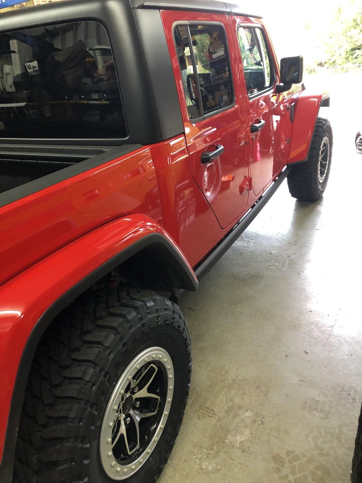

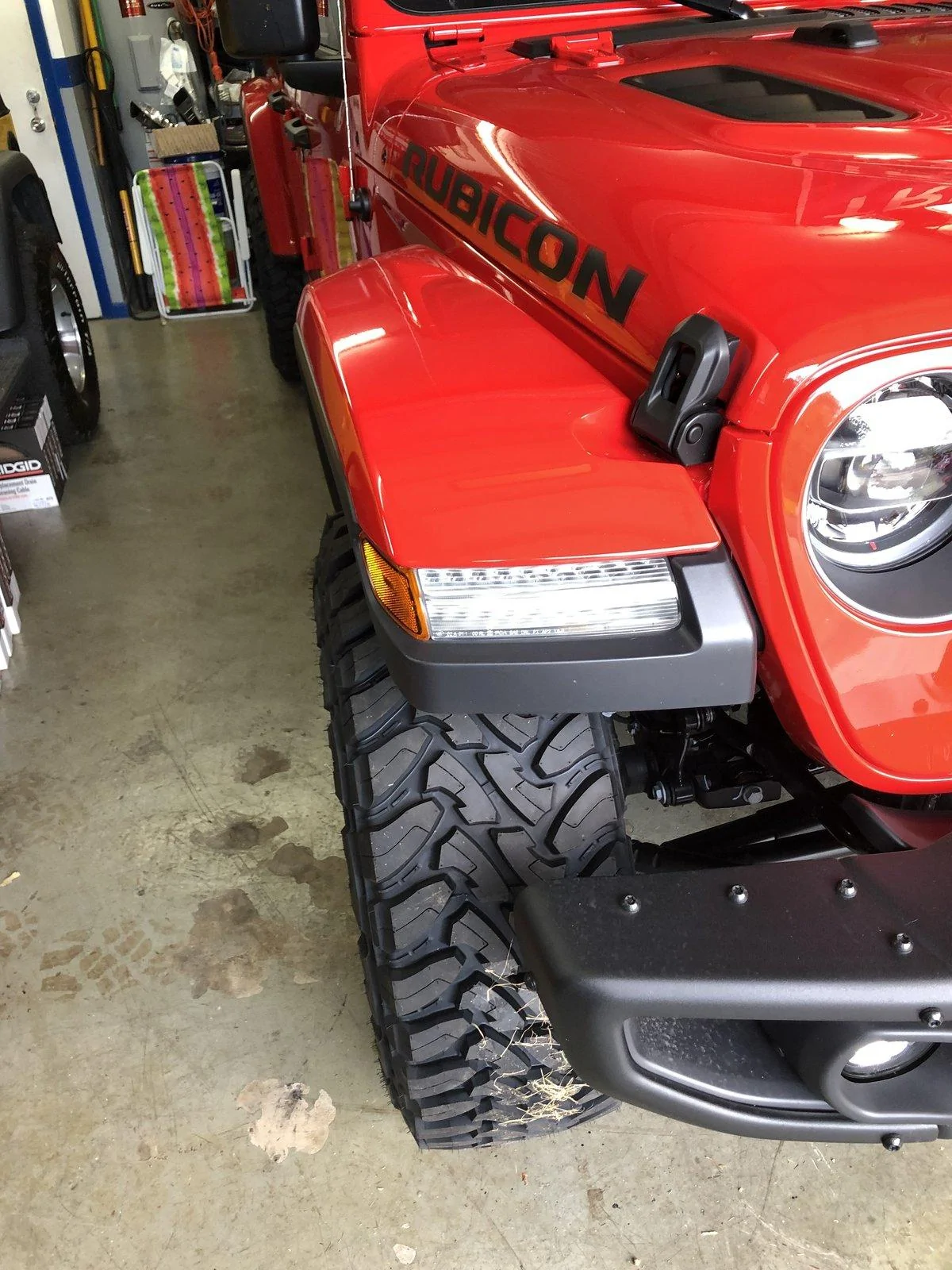

Couple of pics with current stock suspension
I like this, the tires are not sticking way out beyond the fenders which is a no no here in California. What are the specs. on your rims? back space, off set. Would 35`s be a good idea on stock Rubicon rims?
