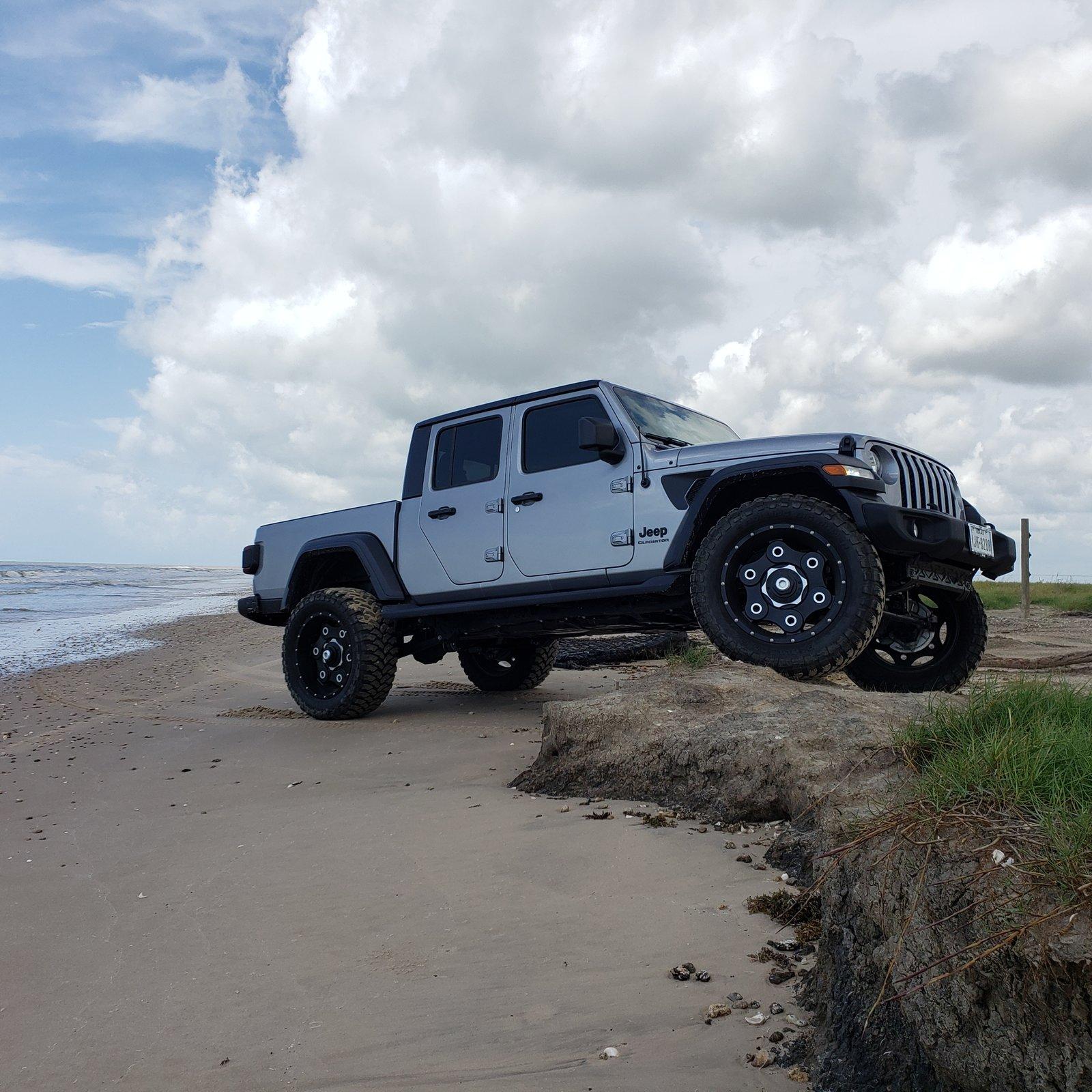

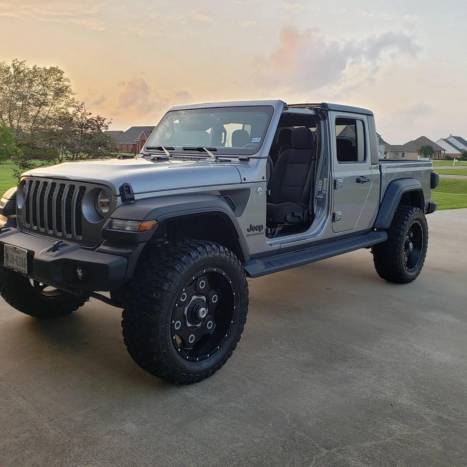

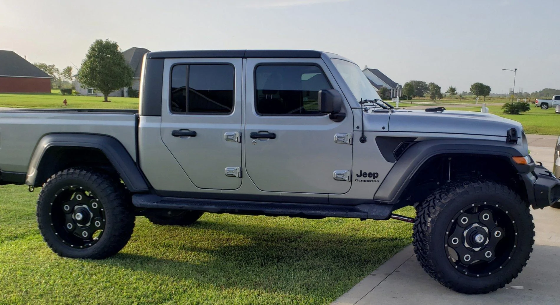

A lot of Billet Silver people like lifts! I'm running a 3.5" coil spring lift with 37x13.50 RBP Repulsors on 22x10 Moto Metal Link wheels. I DD and do very little off roading and love my 37's!! I had the same wheel/tire setup on my JKU and the Gladiator is substantially better suited to handle them with the Max Tow pkg.
