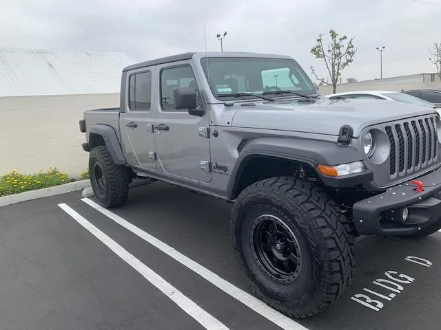

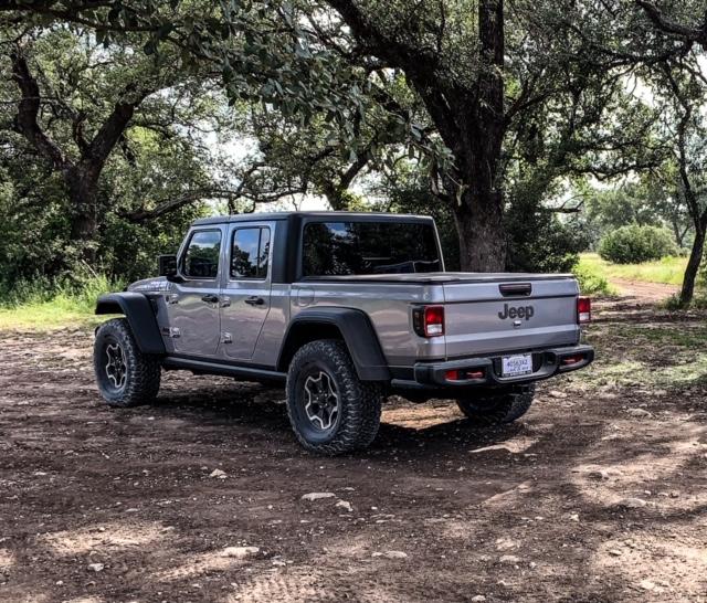

Don't forget the D44s in JTs are larger and thicker (by 10mm) than JLs. I run 37s on both my JTR and my JKUR and have never seen a problem, and I DD them, rock climb them and have been around plenty of 37s on stock D44s for years....rarely ever seeing a problem. Any problems I have seen have been heavy feet, avid offroaders or accidents. Both my JTR and JKUR axles and axle housings are completely stock...except the rear axles on the JKUR that ended up with bend axle flanges while running 35s several years back. So it has forged axles back there now.
I didn't hesitate for a second to add 37s, which I added 30min after driving off the lot. I've put 4600 miles on it and its been on road trips to CO from TX (20mpg) and rock crawled in Texas....all without an issue at all.
I think if you're wanting 37s then you'll regret going 35s. With KO2s I have no audible road noise over stock, admittedly I only had about 10 miles on my stock tires but I paid very close attention on the freeway knowing this was the case.

Did you do any spacers or modifications to get the 37s there and fully functional? I've heard people say you need to get rid of the front bumper "wings" and possibly put some spacers for full articulation and the wheel turned.

I did not use spacers. For DD'ing it doesn't rub anywhere at all. I have a stock lift too, for now. It does rub some at full articulation when wheeling, but not enough to damage anything...just leaves rub marks under the front fenders, which is nothing spacers would help with...in fact they might hurt if they get the tire rubbing on the outer lip of the fenders. Nothing needs to be done to the bumper at all.

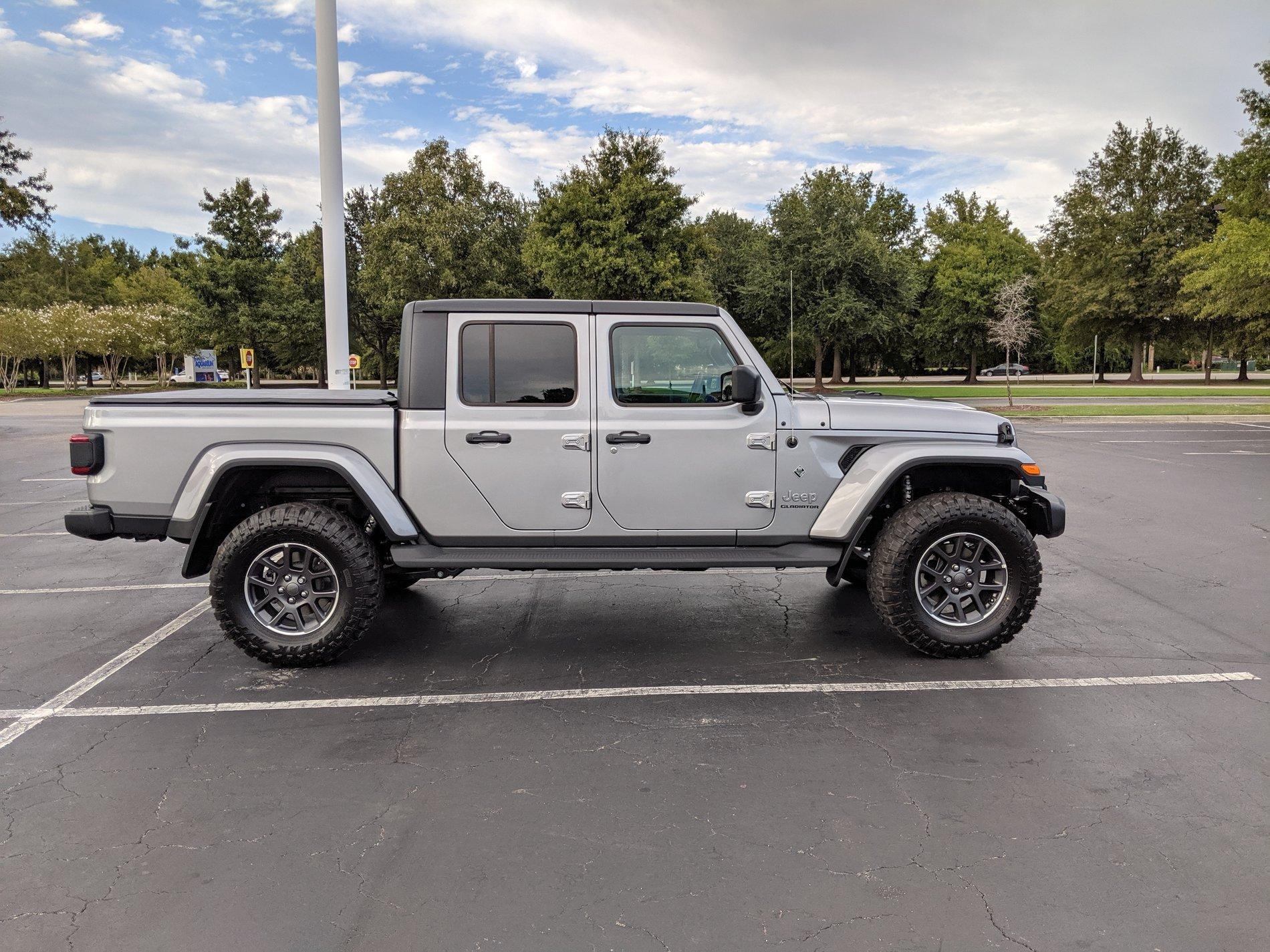

I have 35s and they run great. They look substantially better than the 33s and did not sacrifice any comfort in the ride at all. I have the Rubicon and did not make any adjustments to the ride height (leveling or lift). I have no issues lock to lock. I did lose a little fuel economy but not too terrible. I too was concerned with the ride of the 37s. I don't think you get any substantial increase in capability or looks by going to the 37s as compared to the drive comfort loss.
