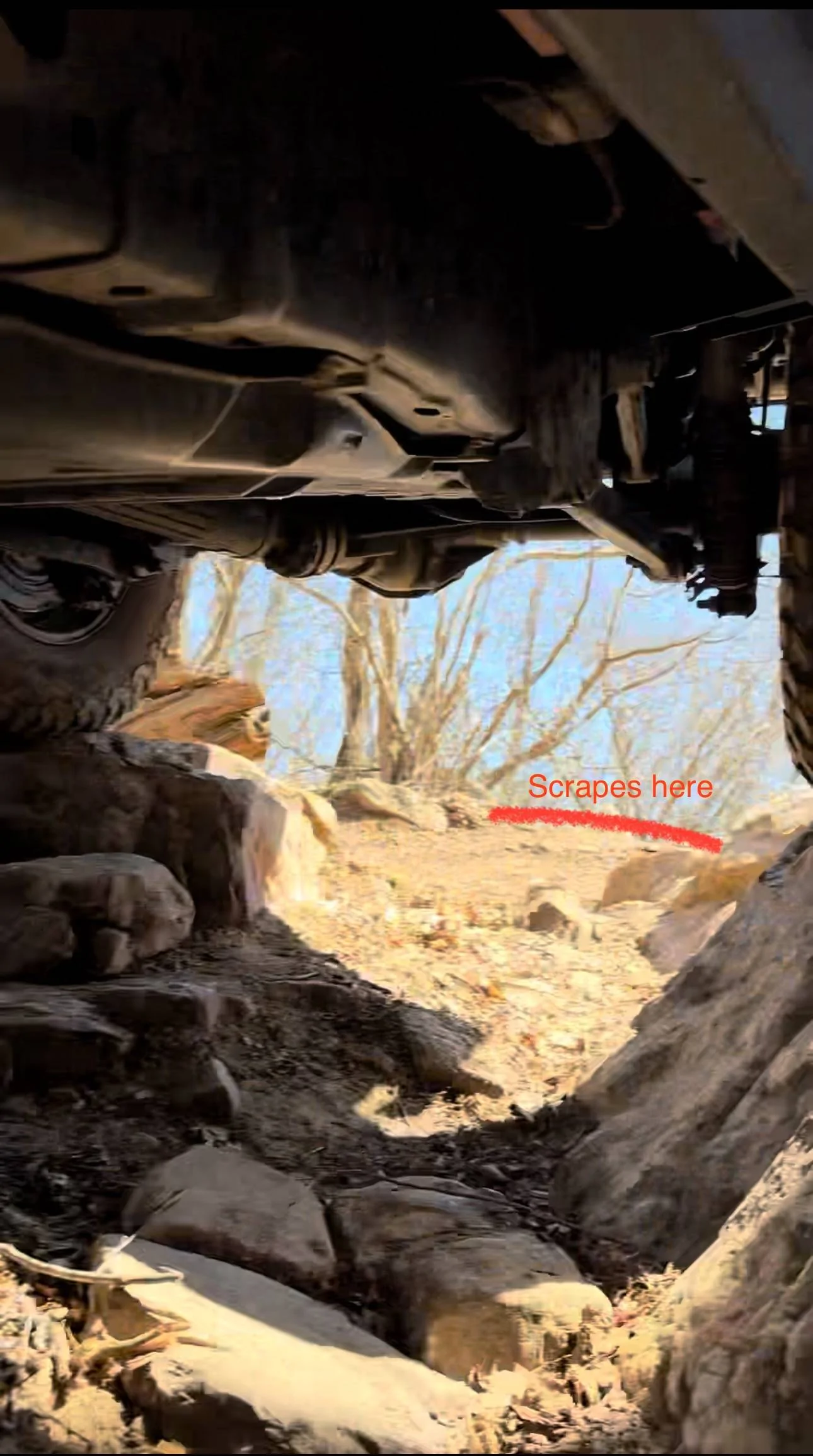

I took my stock Mojave thru big levels and it was super easy and a blast. Also did Poser Rock with no issues. went right over like it was nothing. first time i didn't take the bypass. with my 37s I'd like to try the side by side shortcut up. I saw a gladiator on 40s do it quite effortlessly.
CJ’s and TJs on 40+ tires, and buggies break driveshafts attempting to go over poser rock at Uwharrie, but some make it. Any vehicle with decent approach angle can drive up one side. Zero chance you “went right over like it was nothing” in a Gladiator. ?. I’m throwing a flag on that claim.
A stock Gladiator is fine at Big Levels. I made a wrong turn and ended up on a wash (I hadn’t been there in years). Still l, I’ve done the washes between switch backs in other vehicles without any issue. I almost high centered (stopped before it was too late) on a side trail at Flagpole. The stock truck just doesn’t have the breakover it needs for my comfort level and its length is a liability. But I’ve seen forest rangers drive 2 wheel drive trucks drive up Big Levels. You can do a lot of trails in a bone stock truck if you’re spending someone else’s money.
I did Potts Mountain alone on 37s, despite watching the videos. I didn’t find it as difficult as the they imply but I did scrape a lot at the rock garden. Although even there I seemed to have less issues. I didn’t get stuck at the big rock climb/descent at the entrance/exit to the garden which hates long wheelbases but I was going South/down it and scraped center entering from the top. I’m not sure if I’d have had worse luck going up. Potts Mountain was the final straw that made me decide to get a full belly skid prior to going out west. On a Wrangler there’s this sense that almost as soon as the front tire leaves an obstacle the back tire is hitting it. On the Gladiator, there’s this loooonngg transition which reminds you it’s not like a regular Jeep. Of course, I would never had been able to justify bringing an Ooni pizza oven and Ukeg up a trail, so the Gladiator wins.

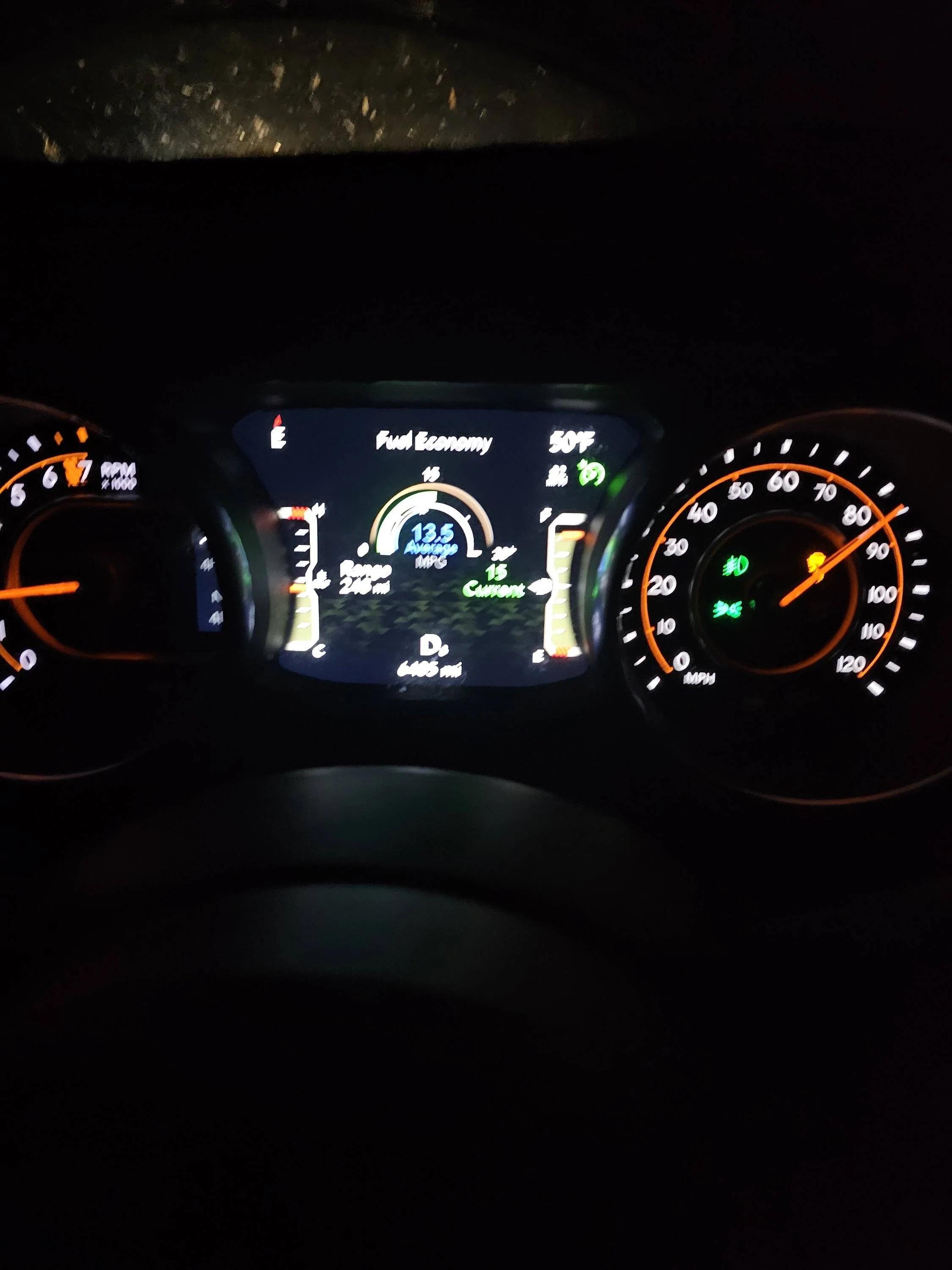

As far as gearing and 37s, stock 4.10s and about 1300lbs of gear, people, dogs, water, wood, etc. Pic came our a bit blurry, but cruise control set at 85mph, flat freeway, ~2050rpm, 8th gear no problem. Yes it downshifts for hills, etc like it's supposed to, it's a double overdrive transmission. Maintains 85mph for 8 straight hours even on the steepest grades, might downshift all the way to 5th gear there. 5.13s in 8th gear are just 4.10s in 7th with nowhere to upshift under light loads.

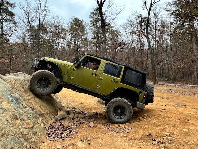

That’s not poser rock. That’s just along the trail at BL. I don’t think mine scraped that. I only scraped, and almost got stuck along some wash my confused ass went down. Poser rock is at Uwharrie in NC. No Gladiator is making it over that.
I haven’t gone since adding my lift, but I was also kinda confused when he was talking about going over poser rock. I have been to Uwharrie many times…

I haven't been to NC to wheel yet. And quite frankly I dont think id go for that rock
You'd have fun at Uwharrie National Forest in NC! There are a lot of trails, some with obstacles, some without. Most big obstacles have bypasses. I don't think anyone goes just for Posing Rock. That's just a fun place to take pics.
