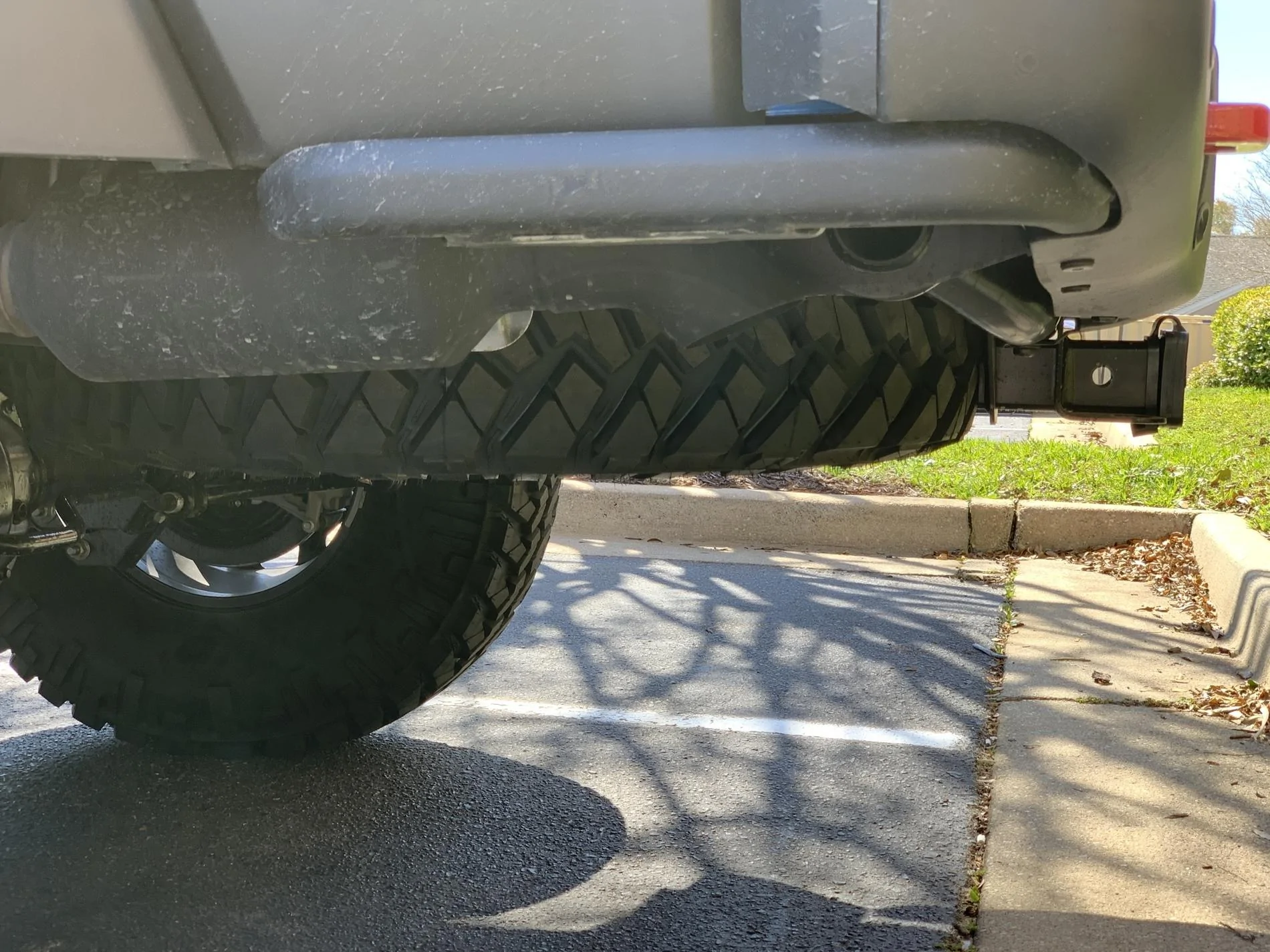

Nitto Ridge Grappler 37x11.50R18LT D 127Q tires on Fuel® Off-Road D564189073 Beast Wheel In 18x9 +1 offset black with dark tint fit fully aired up.
Jeep Gladiator 37” spare tire - list of tires that fit under the bed IMG_2757.JPG

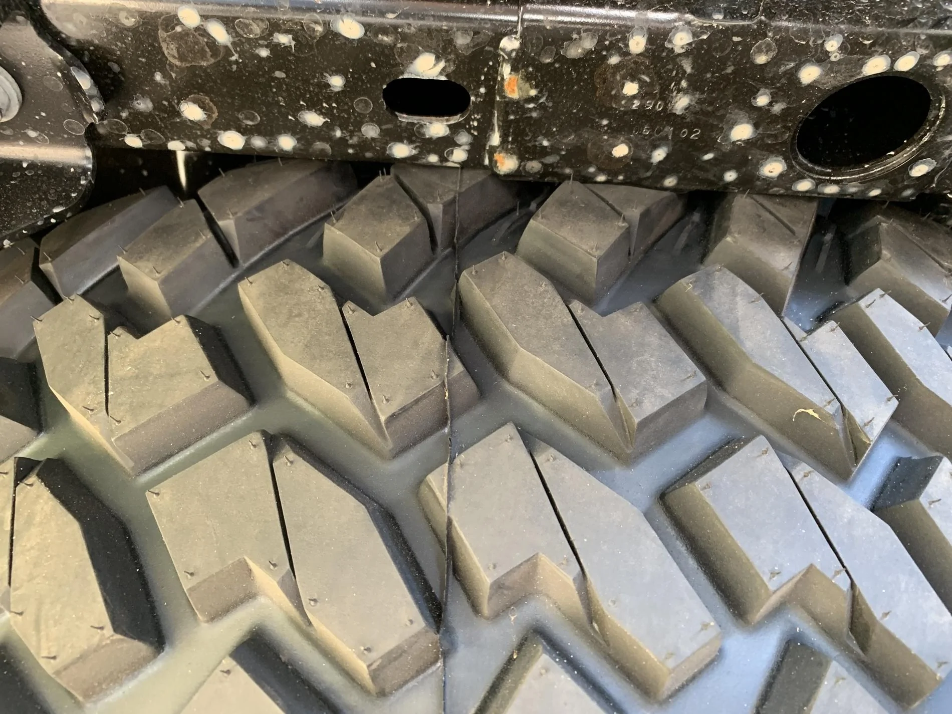

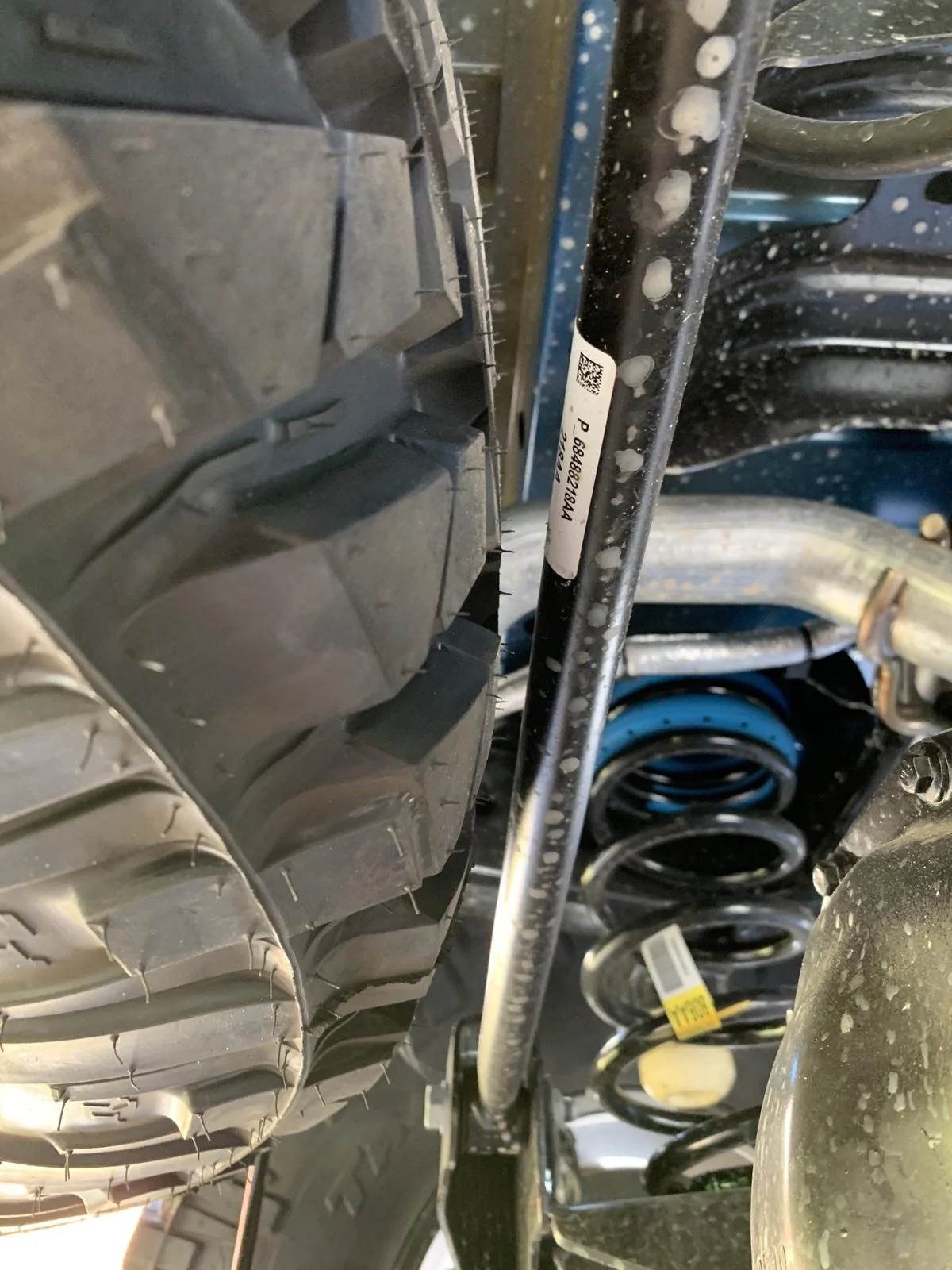

I see Nitto Trail Grappler listed but I had yet to see a picture of anything other than a Ridge Grappler. So today I decided to see if it would work. I had the 37x12.5x17 tire mounted on the factory spare wheel. It "fits"... for the most part. The tire had to be forced between the frame rails a bit and I set the tire pressure to 30psi. If I were to remove or trim the heat shield on the left side I think it would fit perfectly. Either way its up there with plenty of clearance on the track bar!
Jeep Gladiator 37” spare tire - list of tires that fit under the bed iOQHKA3
The right side. You can see the tread is a little deformed where I used the tire-iron to help the tire slide up between the frame rails:

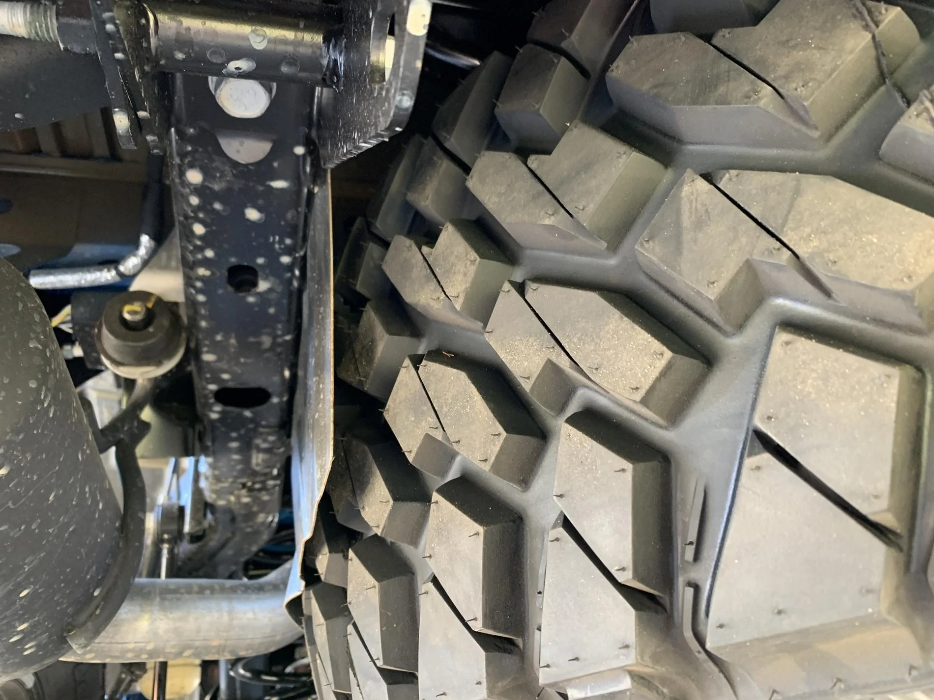

On the driver-side you can see that the tire sits about a half an inch to the right due to the heat shield... I think I can trim the back half which should allow the tire to sit evenly between the frame rails and make getting it up there easier.
Jeep Gladiator 37” spare tire - list of tires that fit under the bed Pr12BPx

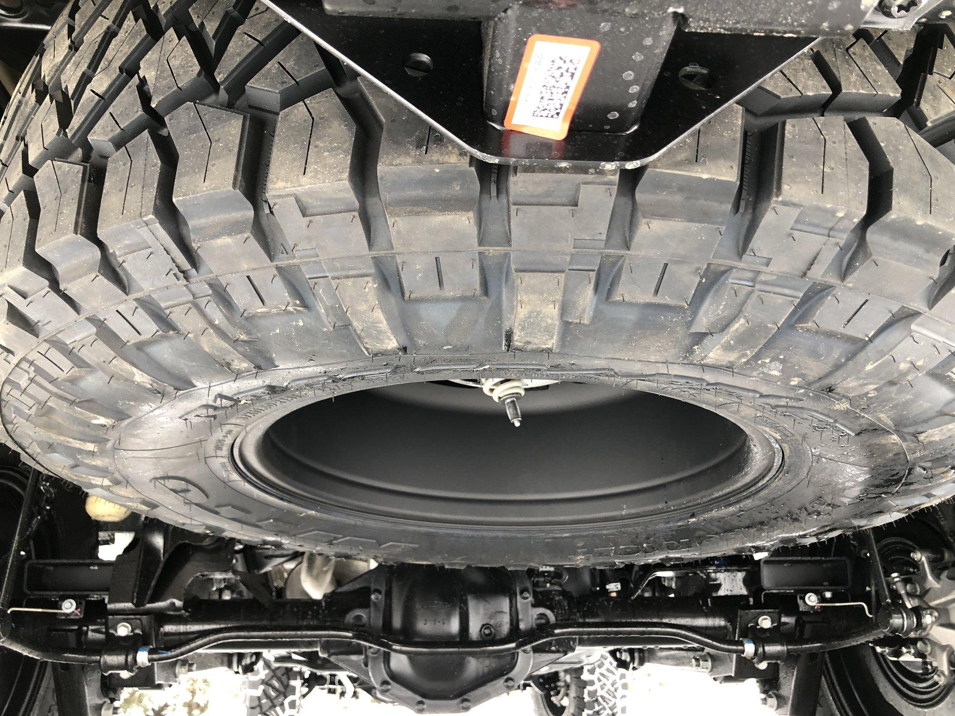

It only sits about an inch maybe inch and a half lower than the factory spare
Jeep Gladiator 37” spare tire - list of tires that fit under the bed oKzH66u
Jeep Gladiator 37” spare tire - list of tires that fit under the bed IKYCa3n

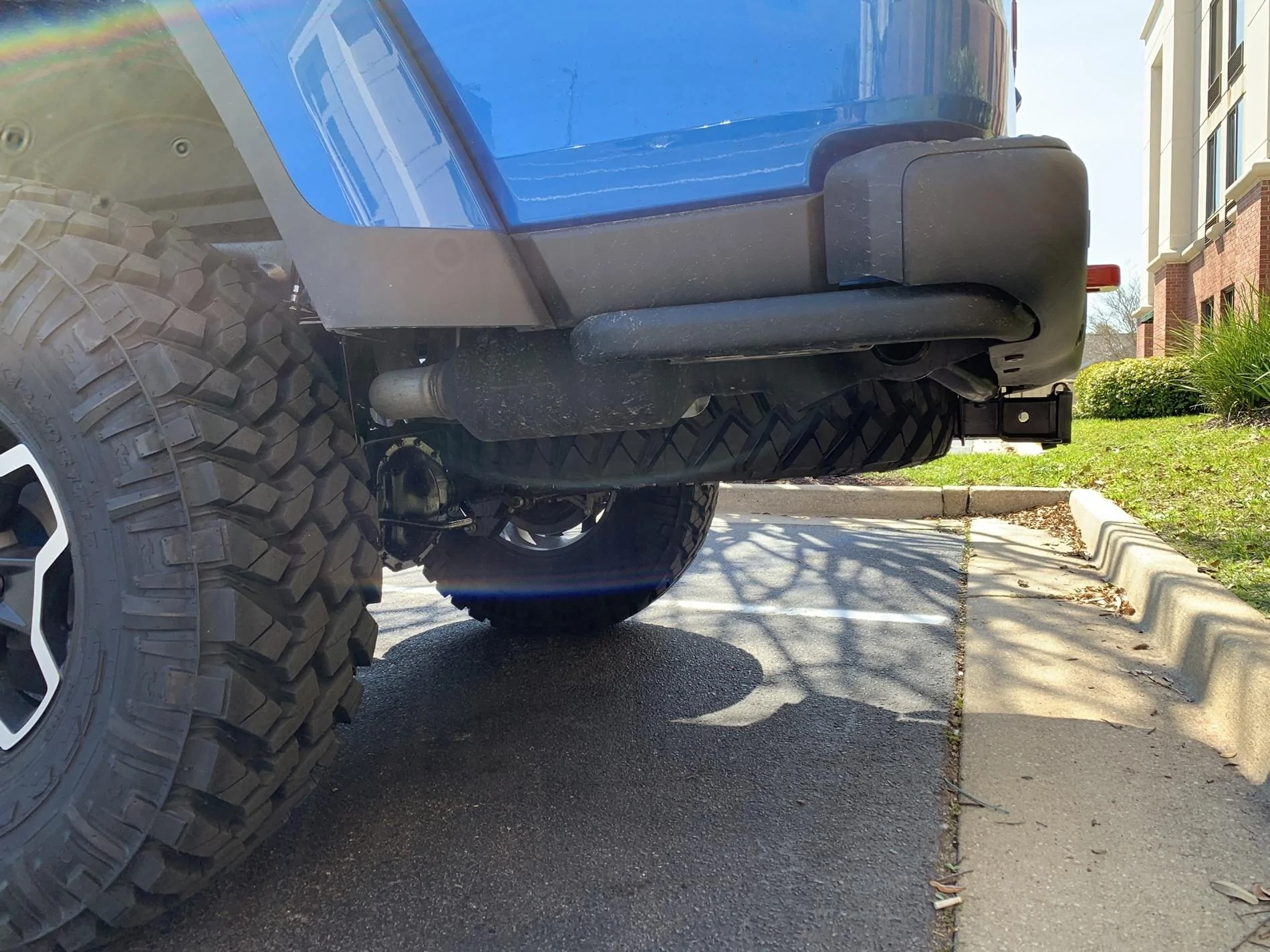

I can confirm fit for BFG KO2 37x12.5x17 on AEV Savegre II mounted with mounting surface facing down. I don’t think the shop aired it down either.
