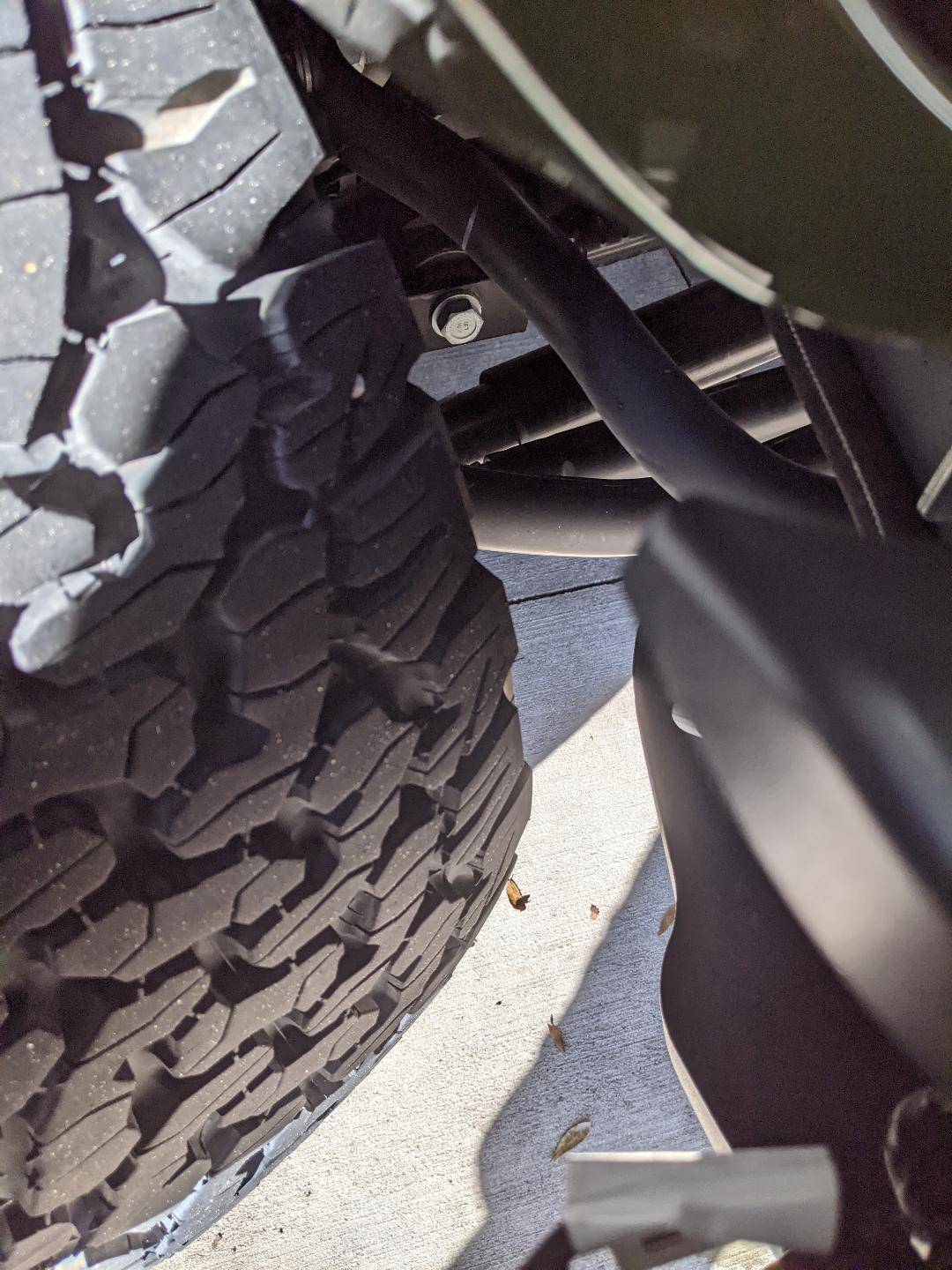

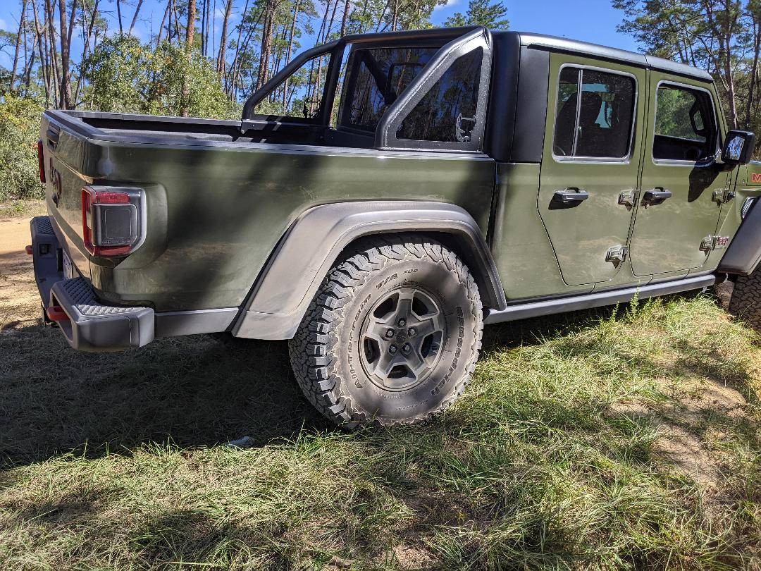

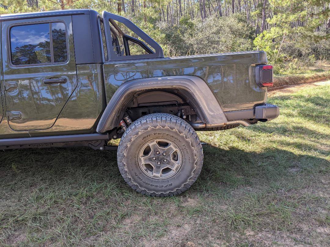

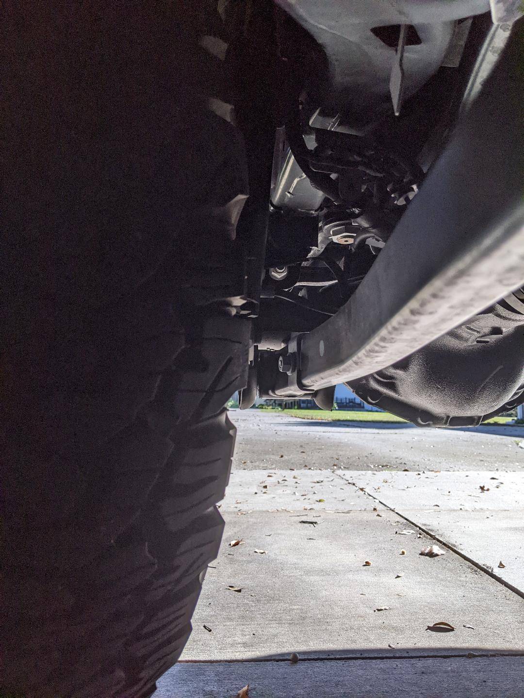

Managed to take the JTM out into the woods this weekend and flex it up and drive some really bad roads at some speed. I'm not a great picture taker, and most the good shots I was probably in the drivers seat not wanting to get out at the most inopportune time. So be it.

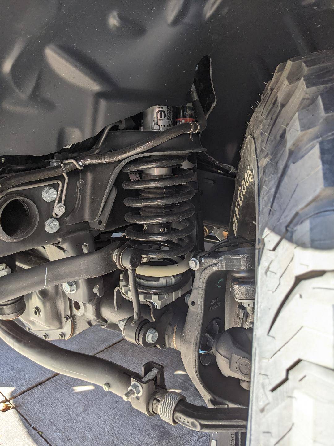

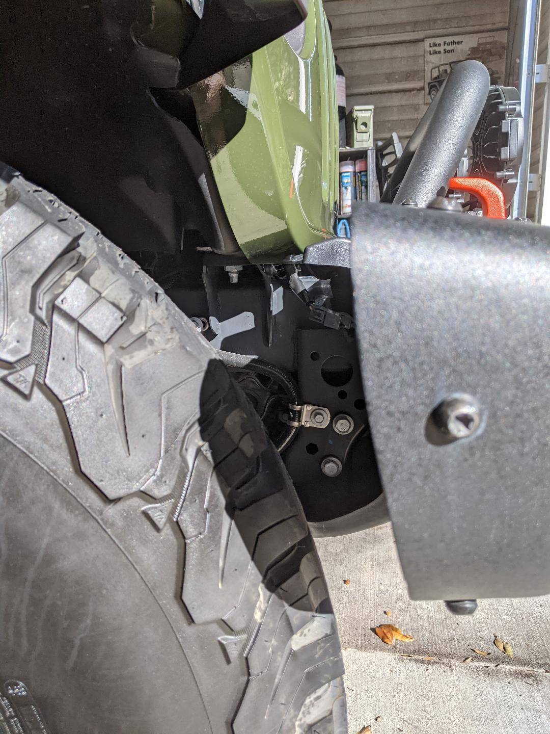

Do they rub? As previous post, yes I can get the front tires to rub the back side of the fender liner. I trimmed them a little and today zip tied them so they don't flap/move. Now they don't. I never adjusted the steering stops either.
This is with the stock 7.5" Mojave wheel also.

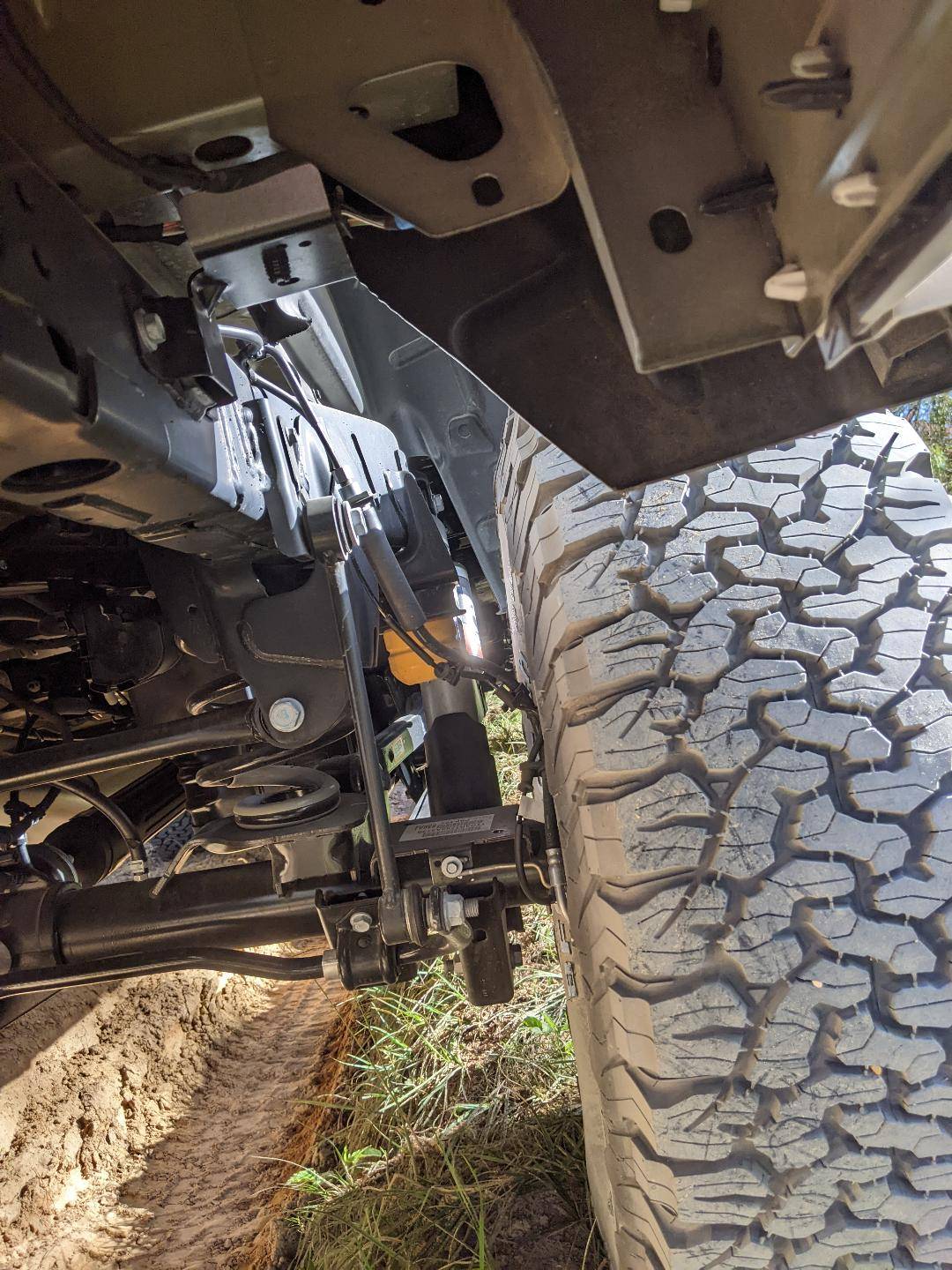

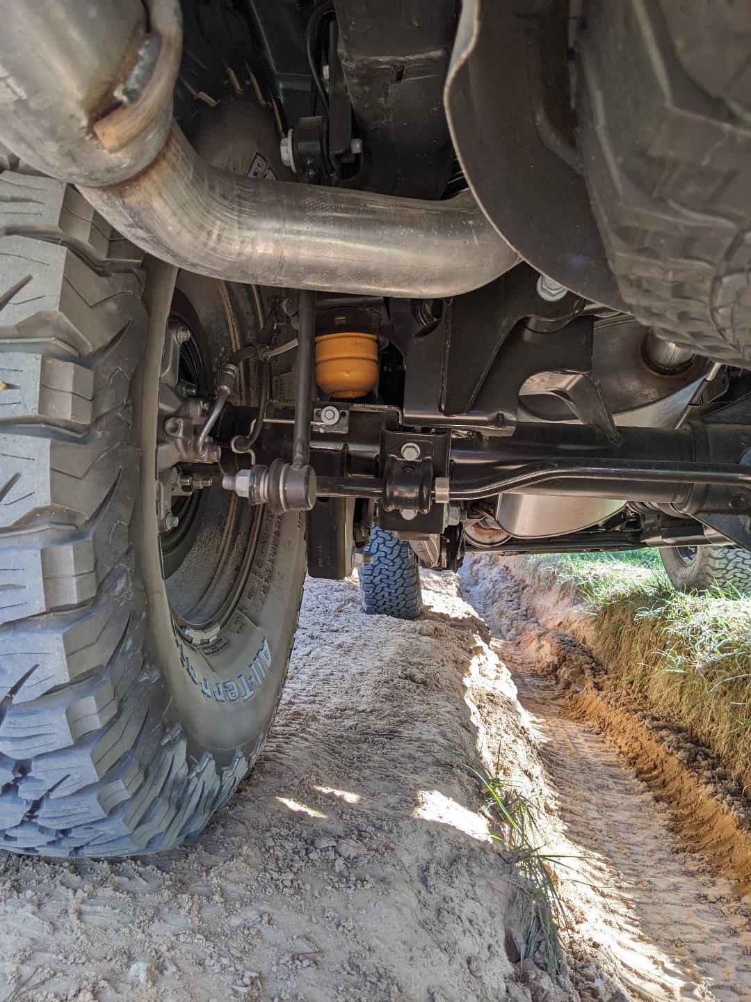

Everywhere else front or back I have yet to rub. I fully flexed both front and rear and inspected clearance. All seems to be good.
KevinC
Back flexed sitting on bump stop

Front tires at full lock.

Yeah, good call. I can see it rubbing pretty bad disconnected.
My plan is to not disconnect. My previous JTR I hardly ever needed to disconnect and got tired of it reconnecting above 18MPH. I feel stock Gladiators have enough articulation for my needs.
KevinC

You'll hear the tires rub.
