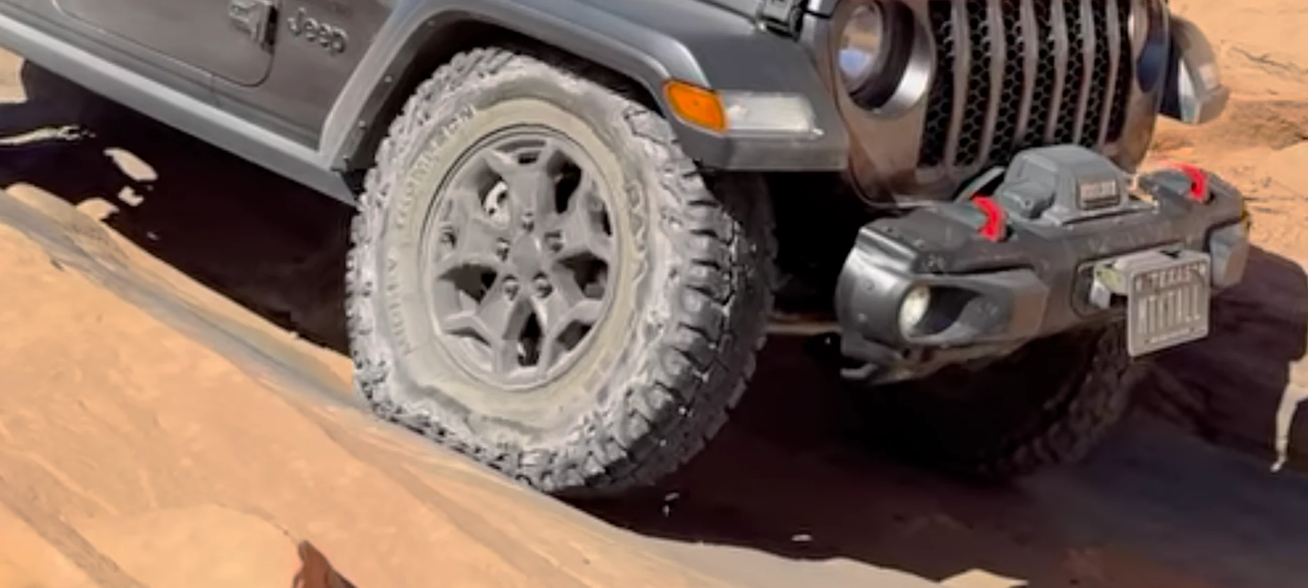

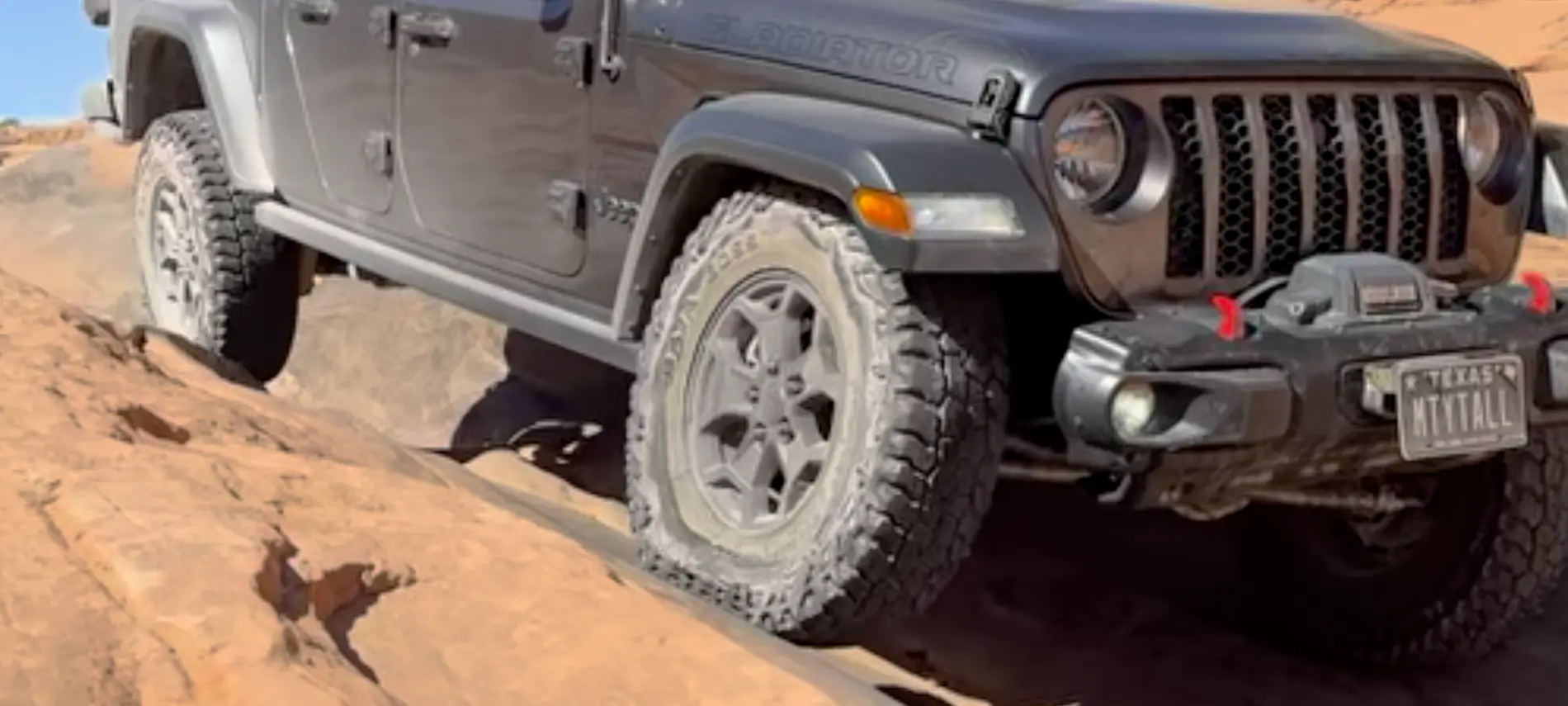

Load range E deform quite nicely at 15psi. They are a rougher ride on pavement though.
some do, but not all. I had a set that I had to drop all the way to 10psi to get even that much wrinkle.
Not an issue if you have beadlocks, but I certainly don't want to run any lower.
