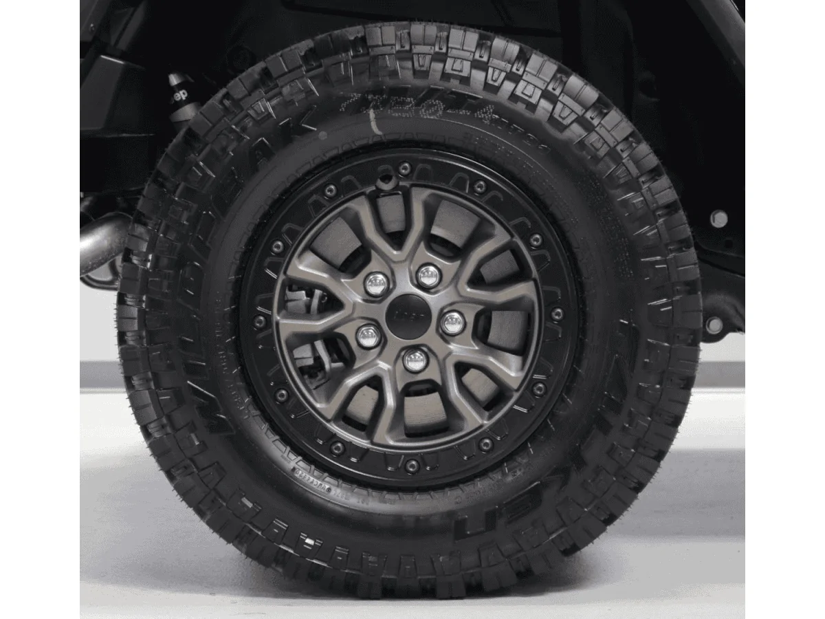

The stock JT wheels are a +44mm and I believe these are +12. They are a touch more out then I would have liked, but the other wheels I thought about getting (AEV wheels) were +25, which is only half of an inch different. I'm more than happy with these since they aren't as available though.

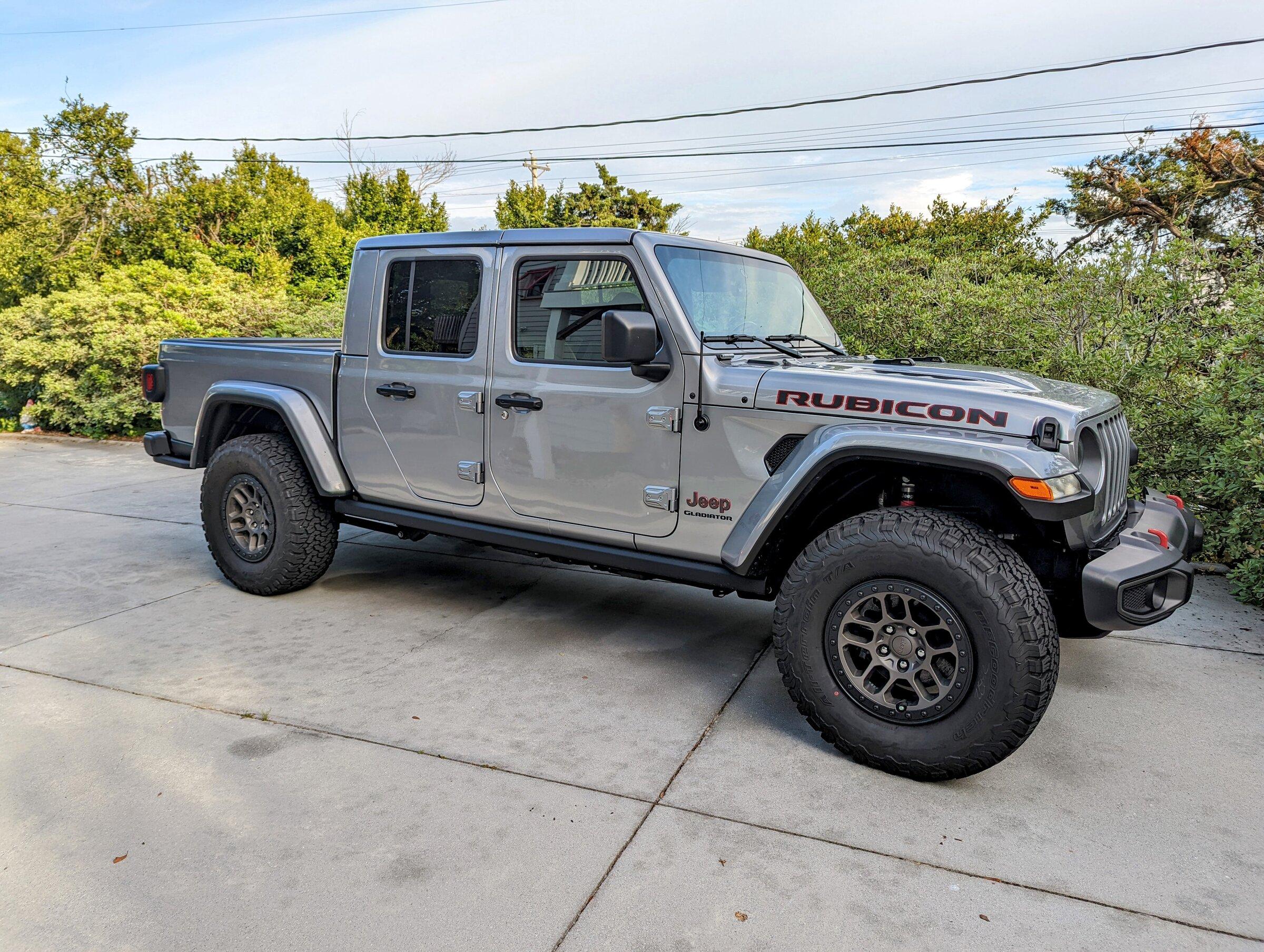

Do you have a "down the side" pic you can share? I have the stock Rubicon wheels and with 37's I feel like my rig looks too tall and skinny. Was actually looking for a slightly wider stance.
I can get you one later today, no problem. These and the AEV wheels at +25 mm are a good offset I think. The Mojave wheels are a good option too.
