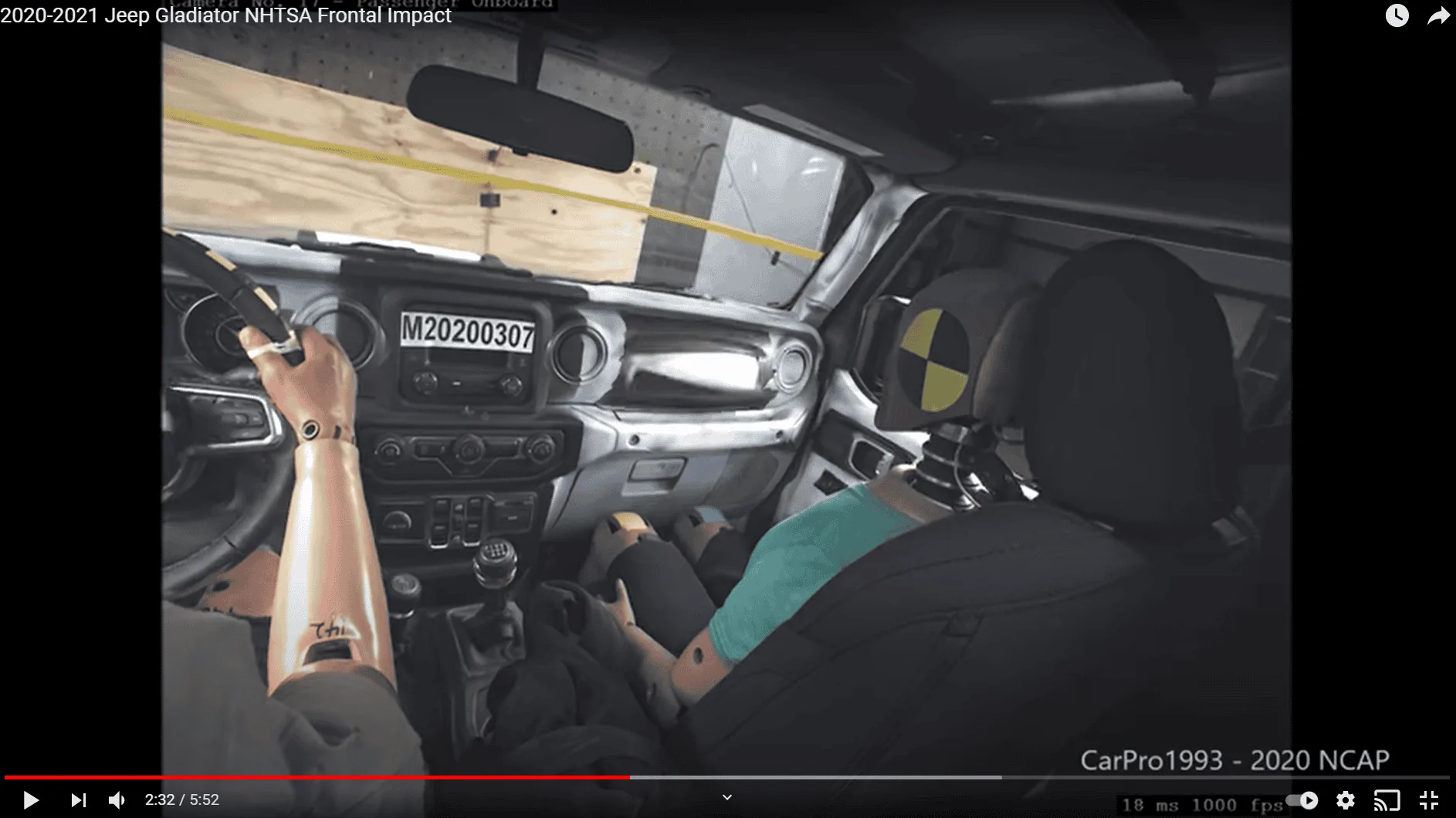

To expand on this a touch more. It's not about the airbag being unable to tear through the wrap. Instead it is about reinforcing the intended deployment zone, possibly resulting in a new deployment zone (shattering the dash, redirecting the airbag, pushing the dash out, etc). Yes airbags present more force than a big sticker can resist: however, that is not the claim being made here. @Backwoodsraider
I have to agree and I wouldn't place something as strong as a 3M overlay over the designated airbag launch opening.
I grabbed a clip from the NHTSA showing the moment when the passenger airbag deploys.
Personally I wouldn't want my family or friends being the crash test dummy for my own personal, untested, dashboard modification.
