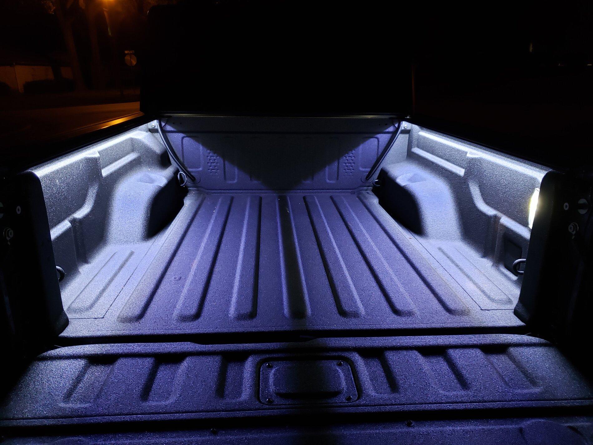

I could never see the need for a switch at the bed seeing how the cab switch is just a couple steps away. It's extra wiring and another switch that may eventually fail. I tied my LED's to the existing bed lamps so they go on and off together.

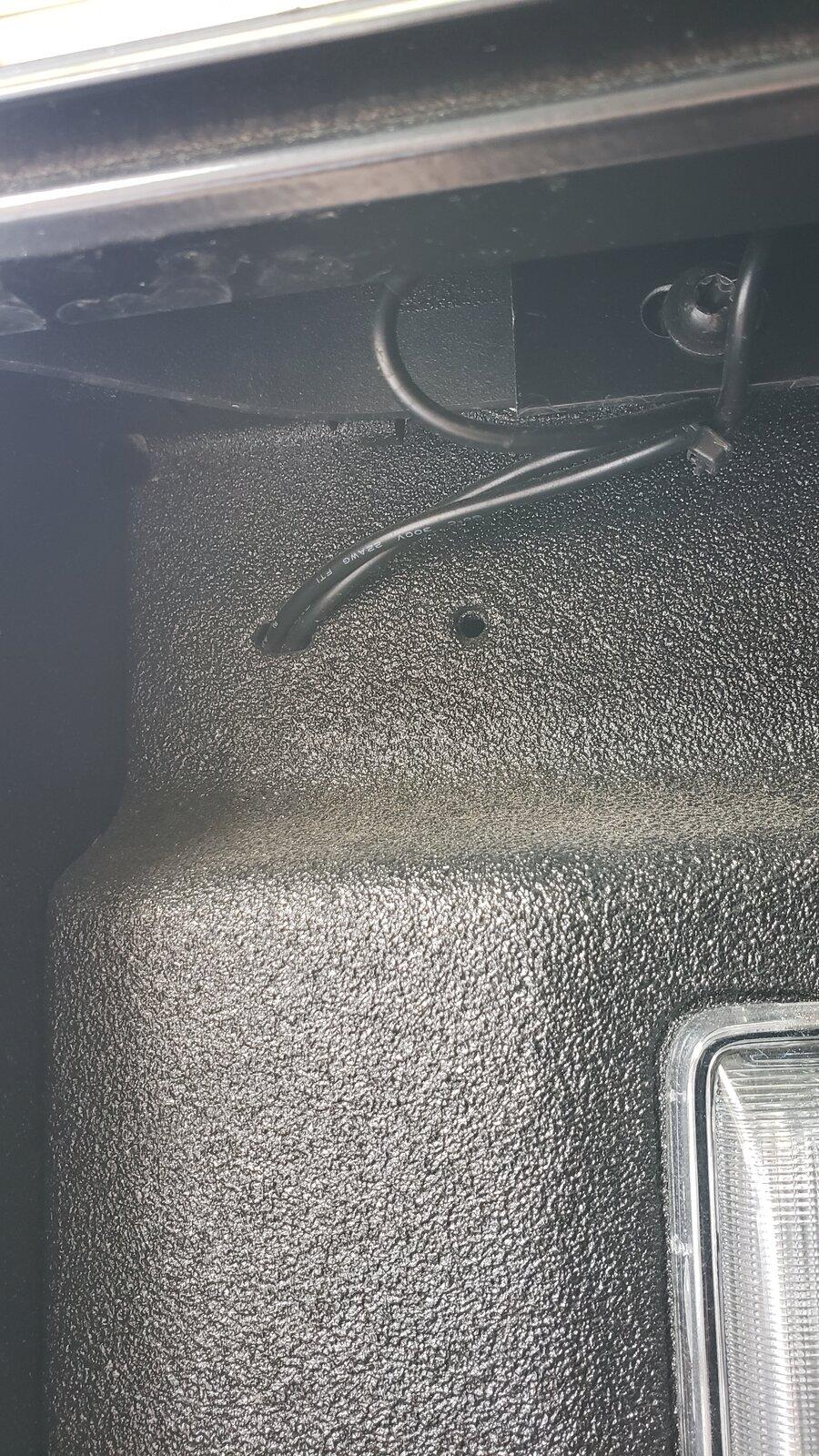

Which wires did you use in the bed did you use? Did you tie into each bed side light for each strip? Oracle black and red posi-tapped into which bed light wires? Also, where did you run the oracle wire to hide it inside the bed wall? Thanks in advance.

I just used the 2 wires going to the existing lights. I also never use taps, always solder and heat shrink. I ran the wires through an existing hole.

I also didn't use the Oracle kit. The e bay linked lights are identical in every way. Same kit as far as I can tell. Pictures and item description are exactly the same
