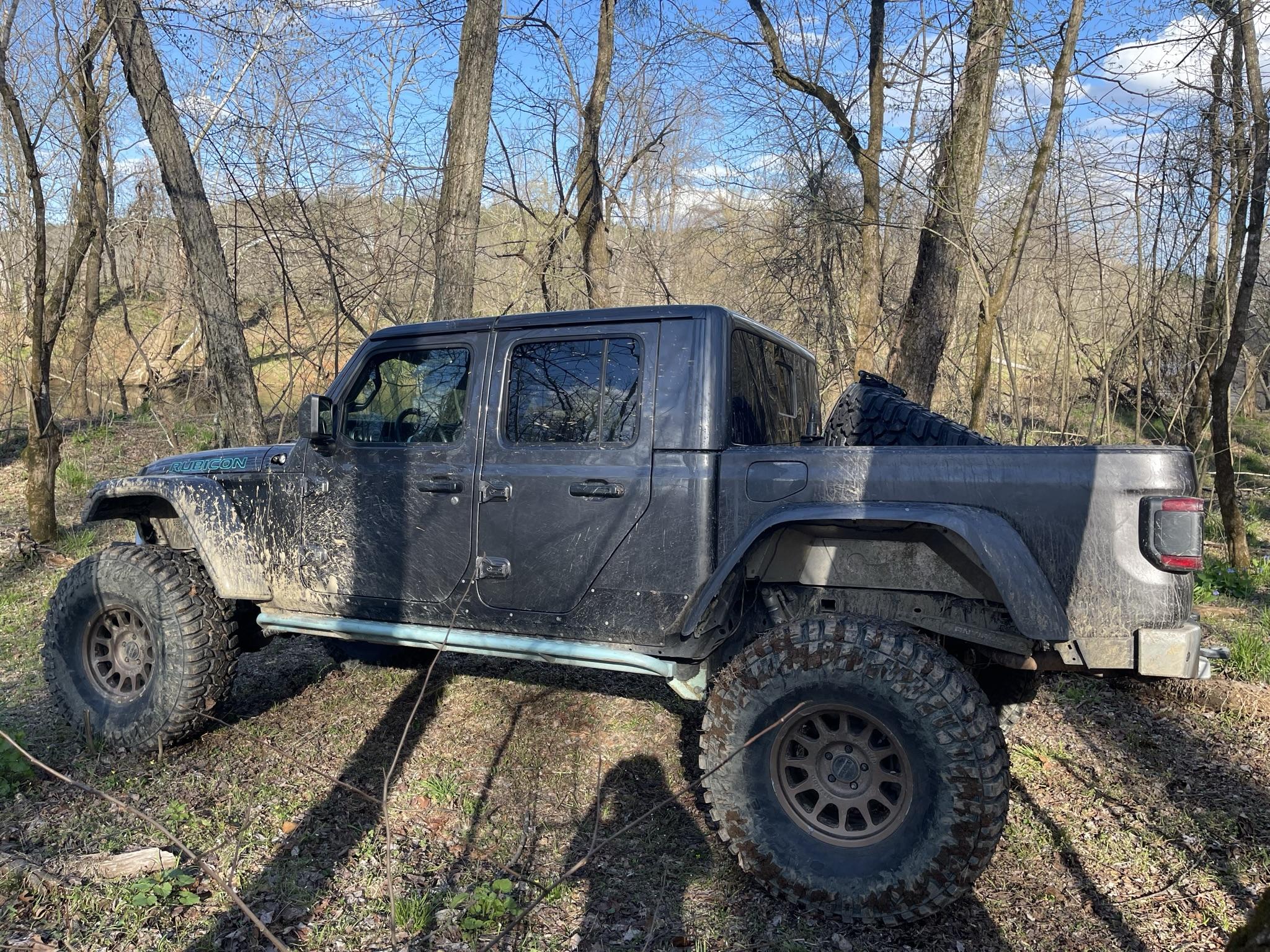

I’m running 37’s with a 3.5” lift. I’d never go higher. It’s great this way. Higher would be tough to use as a daily driver, which I do. Yes, you’ll want to regear for 37’s, especially with the 3.6. I’m on 5.13’s and it’s great. I have the auto and see all 8 gears. You wouldn’t even see 7-8 on 4.10. I wouldn’t go less than 4.88, but if you’re doing it, you might as well do 5.13. Here’s a side view to give you an idea of how it could look.
Thanks for the insight! I am now leaning towards a 3.5 lift with 35's. What brand lift did you go with? I love the stance your has! Great looking truck!

Thanks. Mostly the JKS 3-3.5 j venture package. The estimate is 3” for rubicons and 3.5 for sport or overland. I used yeti Steersmarts for steering and track bars, etc. fixed length JKS LCAs for the lift. The stance is different because I used a BDS ram 1500 rear spring mod, designed for 3” lifts. That kept my rake for hauling and towing. It has also proven to greatly improve departure angle. I much more rarely find my hitch skid with the rake. If I had to guess, the rear is probably lifted 4” or more, compared to 3 in the front. I’m really happy with how it turned out.

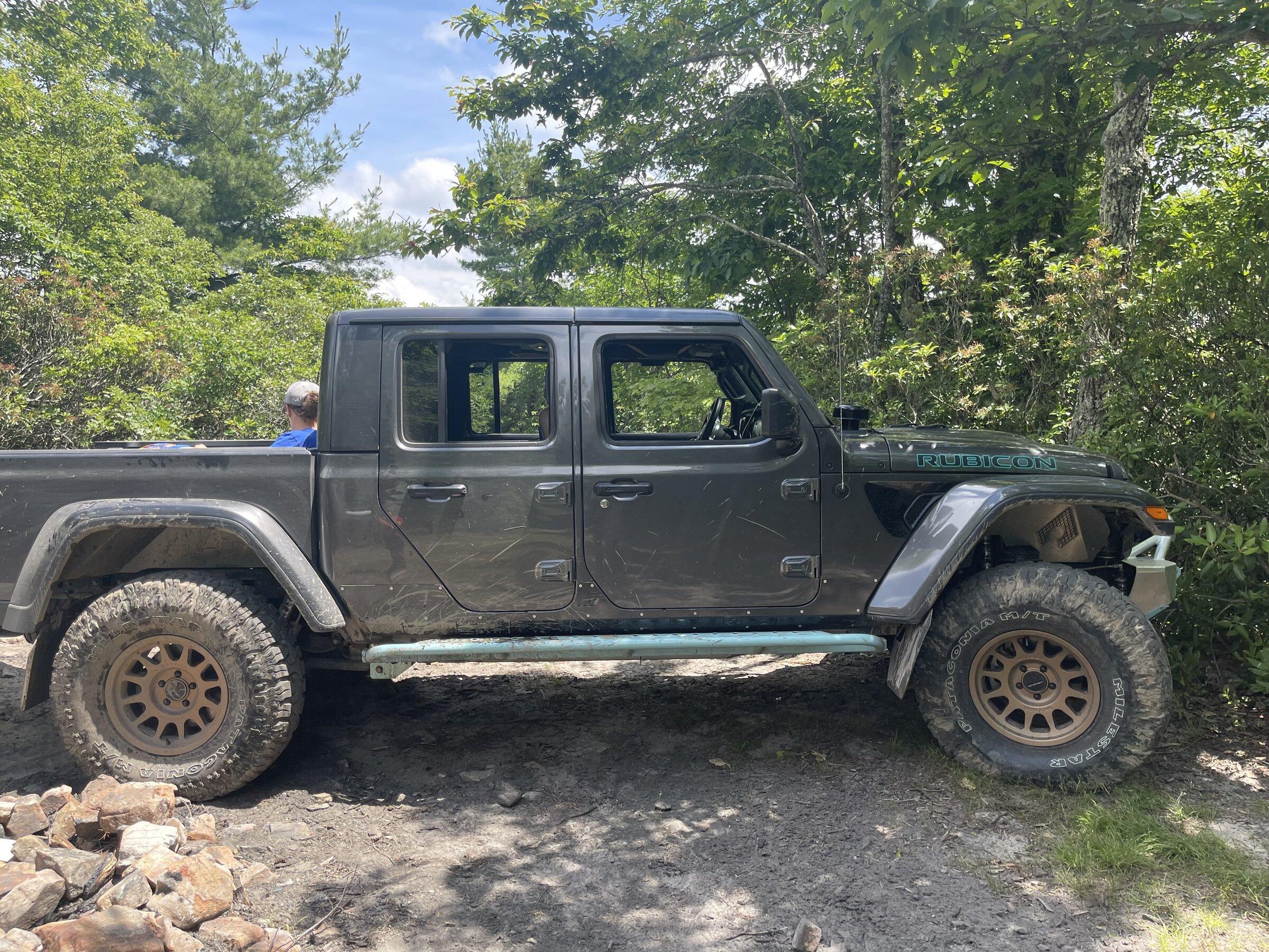

Here is what 38s and 4" front and 2"rear lift look like . Honestly I feel like it's at the limit of the average Joe's daily driveability. Certainly a tick beyond the tipping point of perfection that 37s offered on less lift . Really I probably netted less overall lift than stated due to added weight . Remember I have highline fenders also . TIFWIW
Jeep Gladiator 4" or 6" lift? This is my first Jeep, so many options. IMG_20220104_152402353_HDR~2
