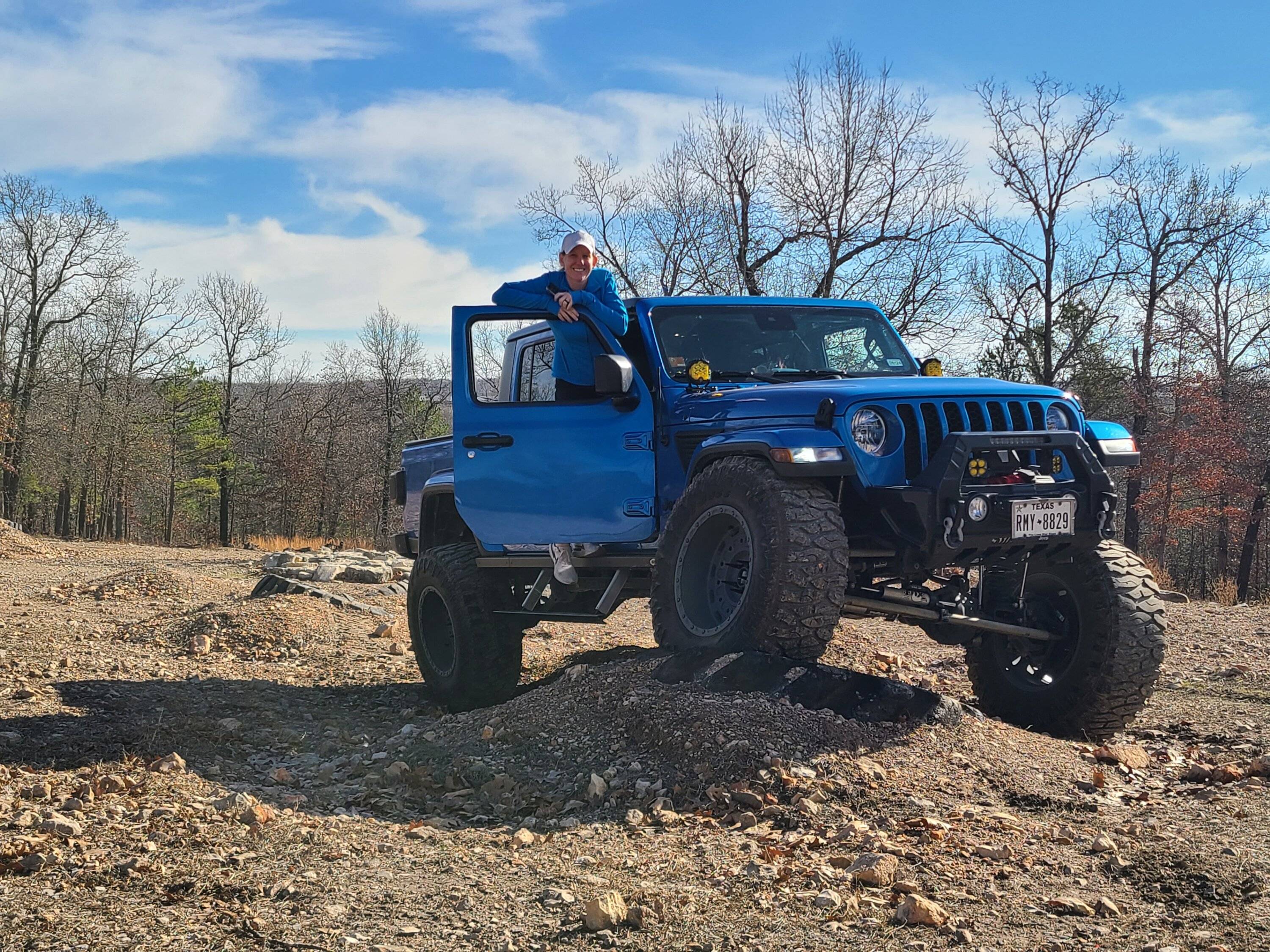

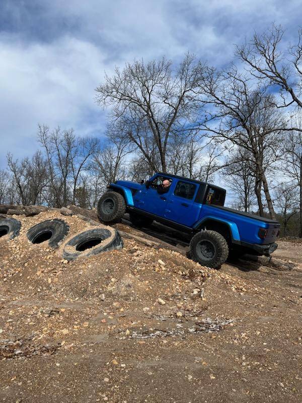

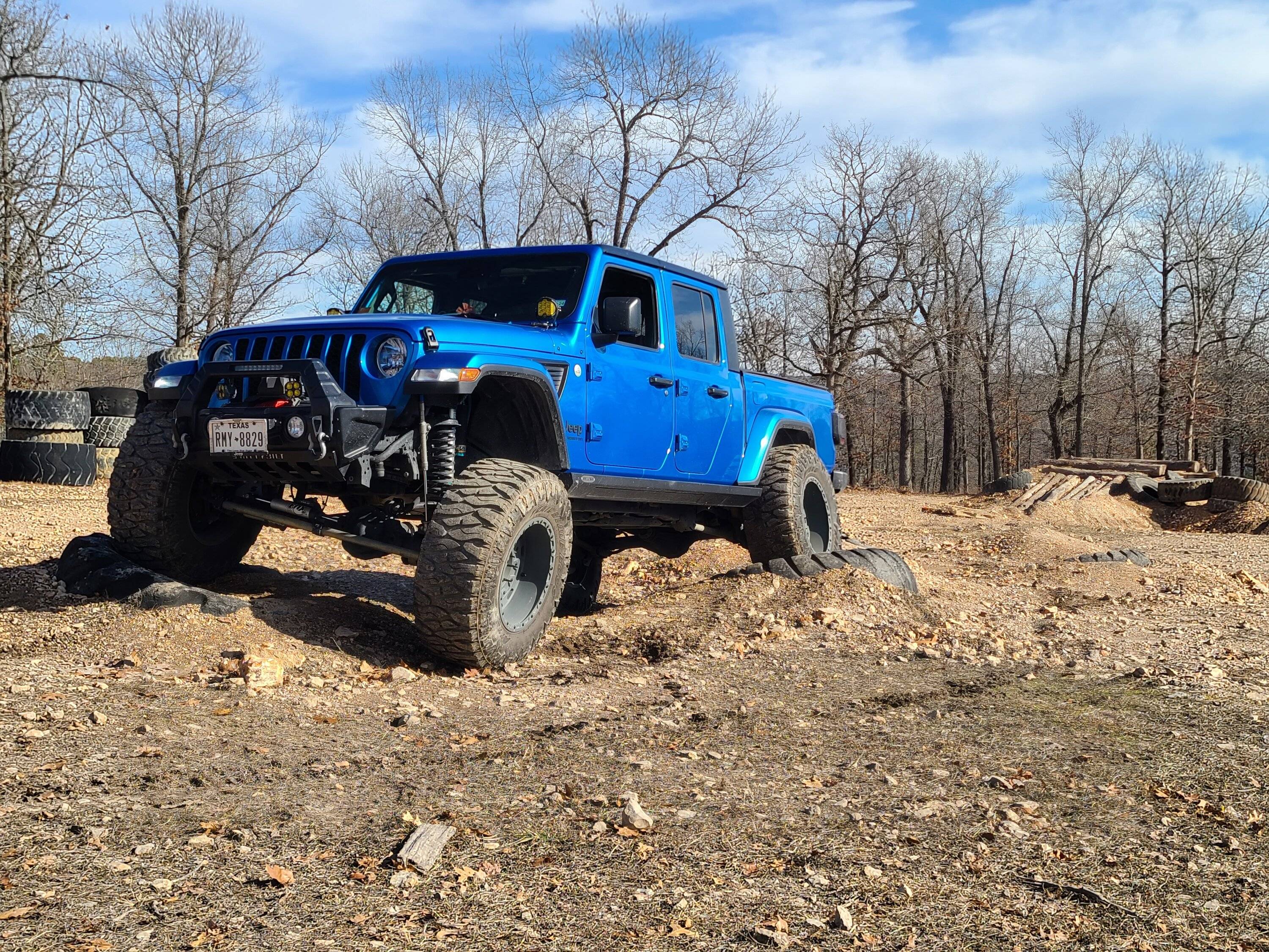

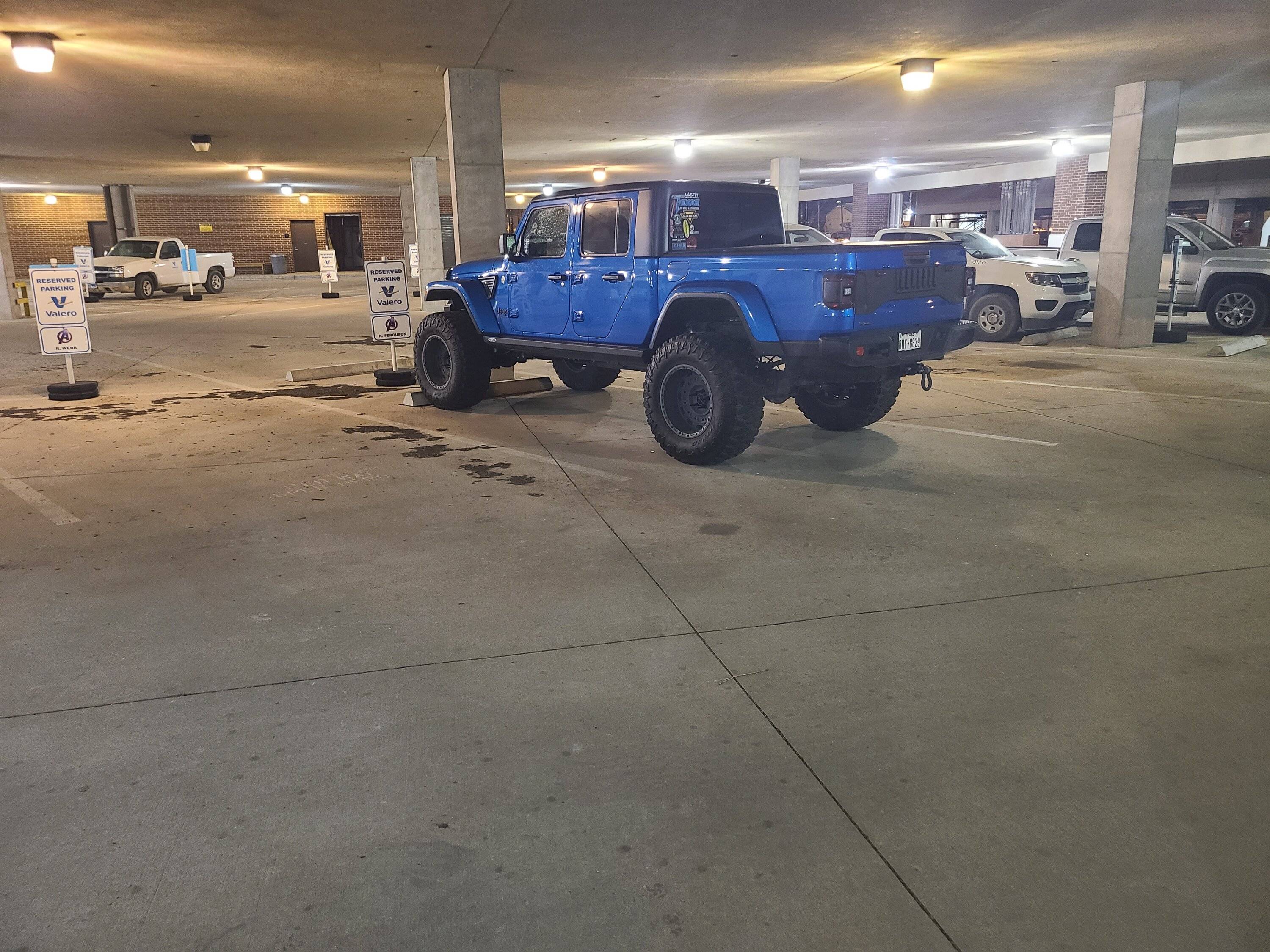

I'm assuming that you flipped your drag link along with your front track bar relocation brackets. After a lot of heartache on my last rig doing pretty much exactly what you're doing now, I found that the CA brackets, track bar brackets and drag link flip made all of the difference in driveability. I ended up trading in my '20 gas engine for a '22 diesel. I went straight to an Evo 6.5" stage 4 lift and have had 0 issues so far. I've got ~30k miles on this setup and have no complaints.
Have the track bar relocation bracket. Drag link flip it's on its way.
Looks like a beast.
Which springs did you go with?

Thanks! Evo 6.5" HD springs. I gained 8" initially but the bumper/winch has dropped it a little bit. I've got a .75" spacer to install but I'm honestly a little scared to mess with anything since it hasn't had any issues. I fought DW for 30k miles on my '20.
