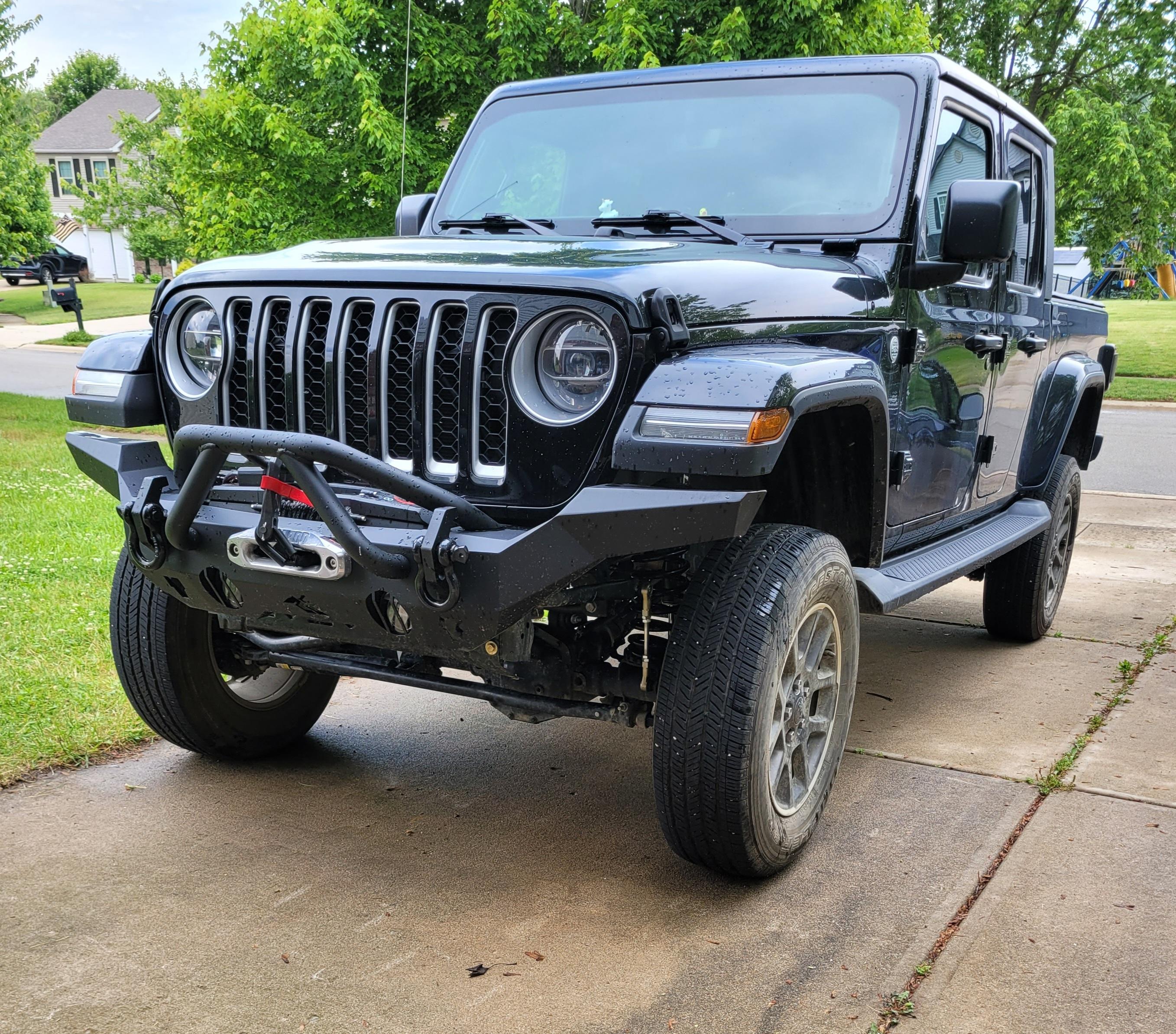

don't these lift kits generally quote lift based on Rubicon heights? (+1" over all other models) so if it's 3.5" of lift for a ruby then it's 4.5" for a OL.
They normally give you a little bit because of settling and weight added and that's normally between 3/4 and 1.5 inches. I don't think they base it off Rubicon height, Rubicon sits higher because of the springs they have nothing else. That's ground to bottom truck clearance, the highline fenders would give you more clearance for the tires but the ground clearance would be the same once the springs are removed for all models.

Yes ruby's site higher because their spring length or rate is such that it raises the frame 1" taller above the axles then other models.
The only clearance I am talking is how much a suspension raises the frame of the vehicle off the axles. When they quote lift kits they are referencing the increased space between the axles and the frame of the vehicle. SO a 3" lift raises the frame 3 inches more above the axles then what was stock.
If a ol jeep has say 8 inches of space between axle and frame and a ruby has 9" of space in stock form and a 3" lift based on a ruby was used, it would raise the OL 4" inches because you have to account for the extra 1" of the ruby which the kit was sized from.

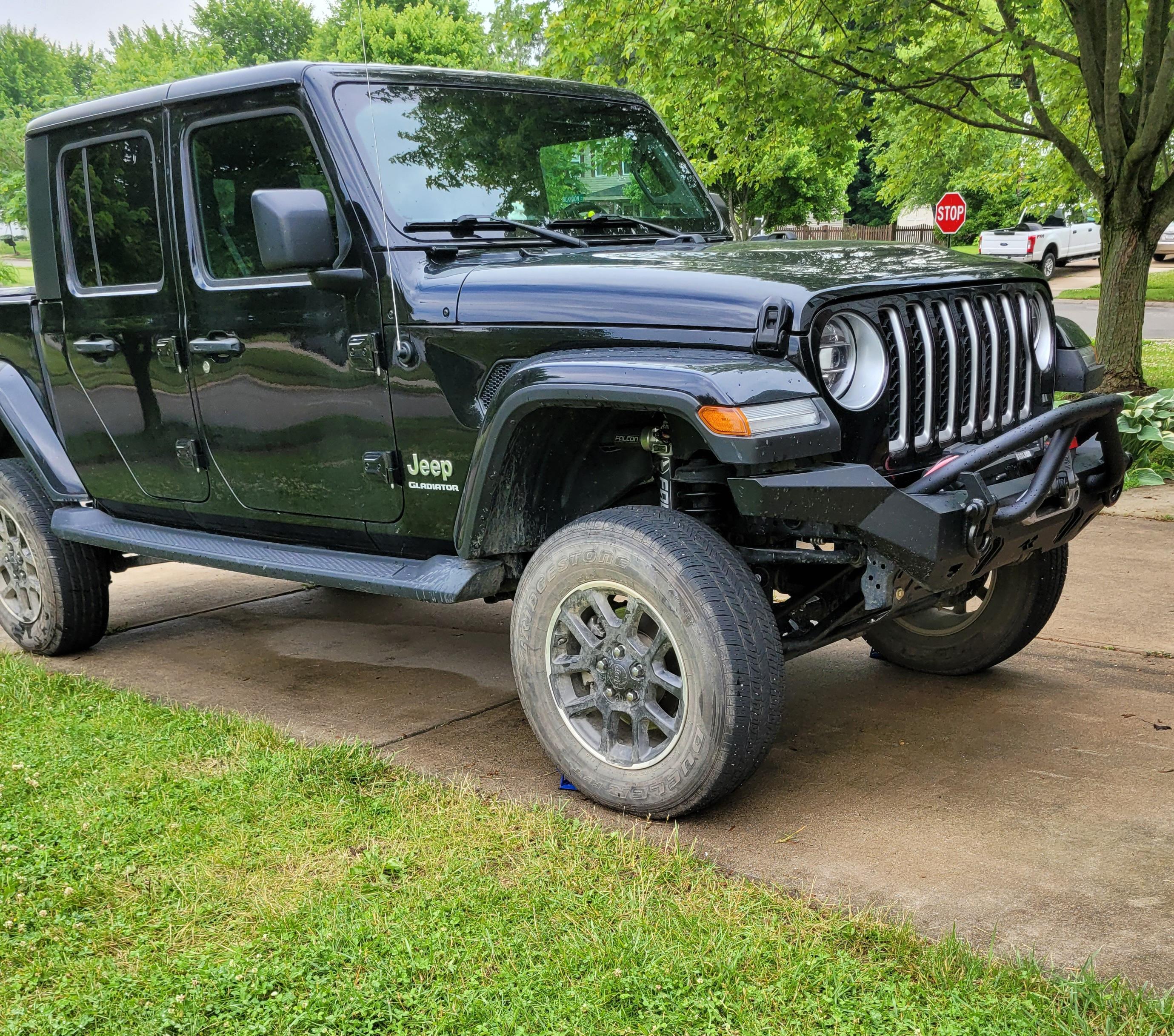

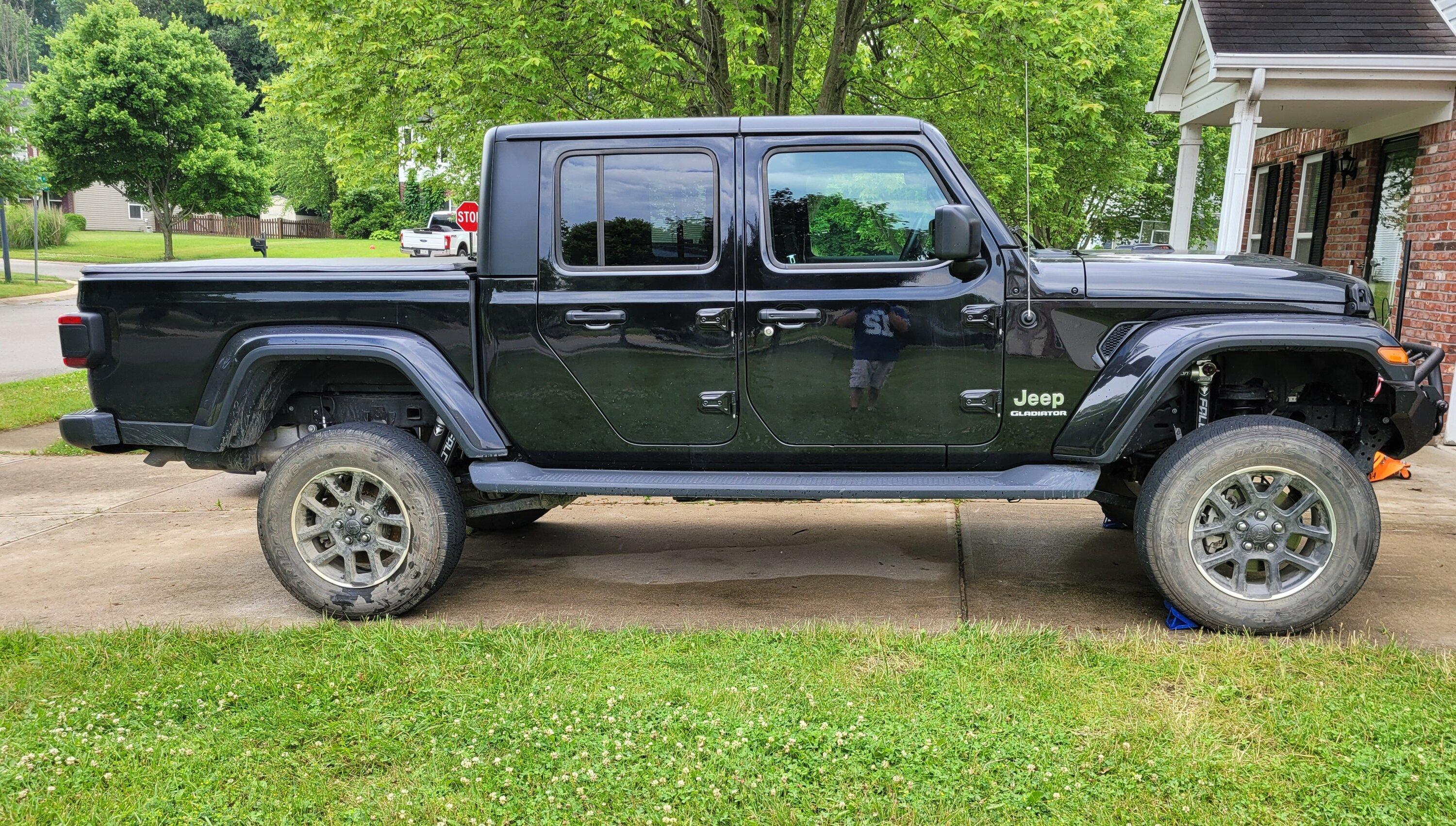

Needless to say, gaining an extra 3" in addition to the 3" from the kit like the op says seems odd and i want to see how compressed the shock is at rest. If the shock body is to long, the shock could be fully compress and bearing the weight instead of the springs and hold the jeep up the extra 3".

It depends on where the lift is measured and how much rake though. As i mentioned clayton always under-advertises their lift because its heavy duty so a 3.5 is actually 4" on a rubi more or less. They are also heavy duty and measured off a rubi so 4" on a sport is 5, and then a light sport these heavy duty springs probably are 6" worth of lift.

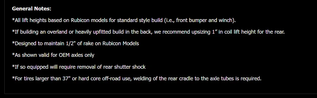

Wanted to check in here! While our lifts do provide slightly more lift than advertised, you definitely shouldn't be sitting around 6" of lift after install!
To clarify how we measure our lift heights, the advertised height is actually when measuring from the rear, and on a Rubicon model with the steel bumper package. The reason we measure from the rear is that we always provide a little bit more lift up front in order to remove some of the factory rake. A 3.5" kit should really measure about 4" in the rear after install on a Rubicon model, which will settle some but this is mostly in order to compensate for any accessories, and so that you're never left with less lift than advertised and are stuck with tires that are rubbing. 3.5" coils will also measure slightly more than that 4" in the front, actually closer to 5", because that is where we are removing that inch of rake. From the factory, the Gladiator has about 2" of rake total, and we aim to remove about half of that for an overall better looking stance.

Diesel Jeeps have the option of using the non-diesel kit so the springs in the front don't provide as much lift, non-diesels would have to use a 1-inch spacer in the rear. The nice thing about having a fully adjustable lift is that all of the control arms/track bars can easily be adjusted if adding a spacer!
