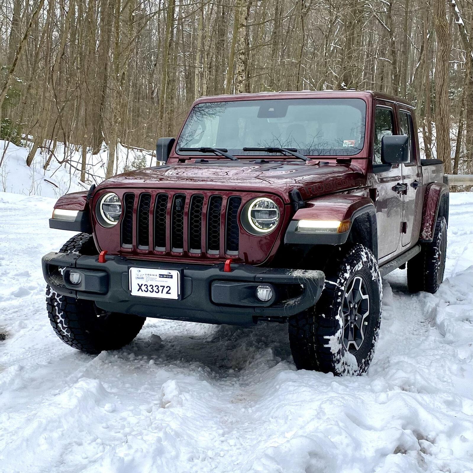

There are a couple great Jeep shops in MD that are both recommending a custom build 3.5" lift for my new JTR using components from Teraflex (3.5" base spring kit + Alpine IR short control arms, bump stops, etc) but I'm curious is anyone out there is wheeling something like this? If so, are you happy with performance and ride both on and off-road? Would you take the same approach again over a MC or Clayton Overland kit?
We're planning to put on 37's for better clearance on moderate/challenging trails, but we also plan to tow a small camping trailer, so we're going with the Falcon 3.3's to have some flexibility in our ride. Also a likely regear to 4.56's and a drive shaft upgrade will be added next year.
