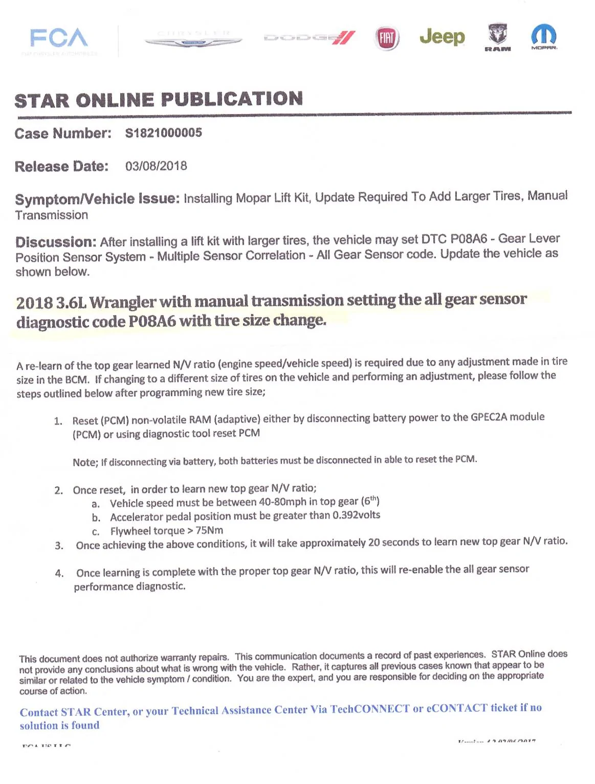

Went though this myself. Here's what you need to do:
Disconnect BOTH batteries for several minutes, then reconnect.
Drive at least 60mph in 6th gear for over 1 min.
Your computer detects the new ratio and will reset, your gear indicator will work and the engine lights will go out, etc. This is purpose-built to detect a difference in ratio vs RPM and it confuses your computer. You need to re-teach it.
There's actually a service bulletin about it somewhere...

Try this
https://static.nhtsa.gov/odi/tsbs/2020/MC-10176542-9999.pdf
