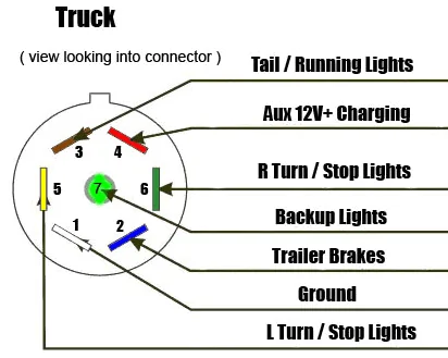

Yes -
Jeep Gladiator 7 pin connector 7-Way-RV-Style-Trailer-Plug-Wiring-Diagram-1

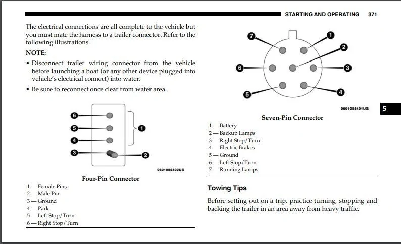

Right in your manual....ITs that book in your glove box...

FYI - it's a standard connector so book or no book, all you'd have to do in the future is google "7 pin trailer connector"
My dealer also told me that for a while, Gladiators came in with NO printed owner manual, only online. He said mine was the first he'd seen in a while with the book. He laughed because he said everything no longer fit really easily into the draw-string bag they stuck in the glove box with the other papers. I also found that one some things, the online version was more current than the printed manual.

As reference if you vehicle didn;t come with one you can order for free from jeep. Mine came with one and i still ordered the new one for free. Its about double thick as my original. Also you can download a PDF of the manual online. I have it on my PC and phone.
