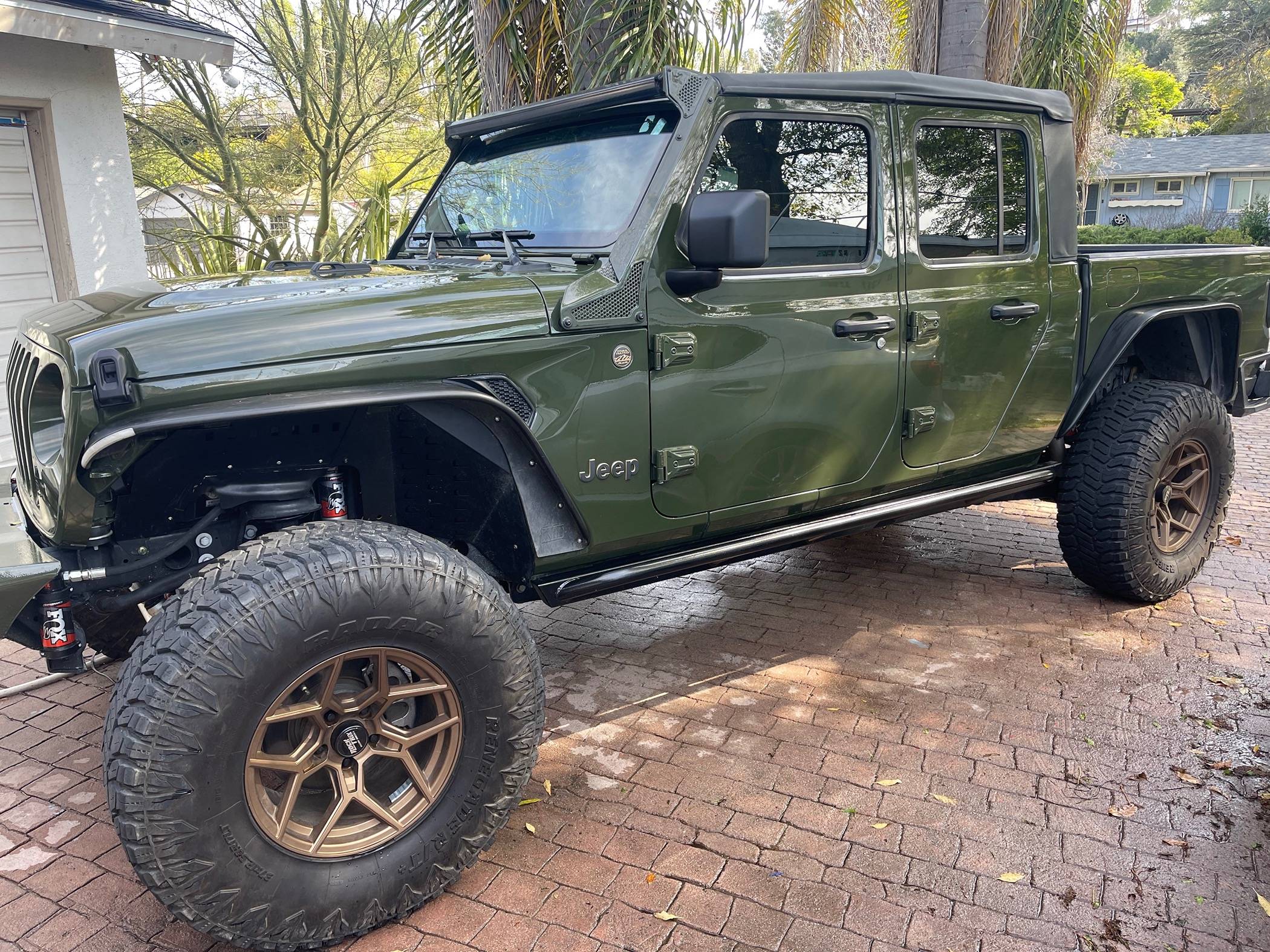

most recently I cut up my stock fenders and meshed the cheap Amazon fender liners together and got this. It does the job, and I was looking into aluminum fender liners but I just can’t justify the cost for something I for sure am going to smash up. I have wrecked these fender liners before and I just take them off and beat them back into shape and give them a fresh coat of bedliner and then are good again.

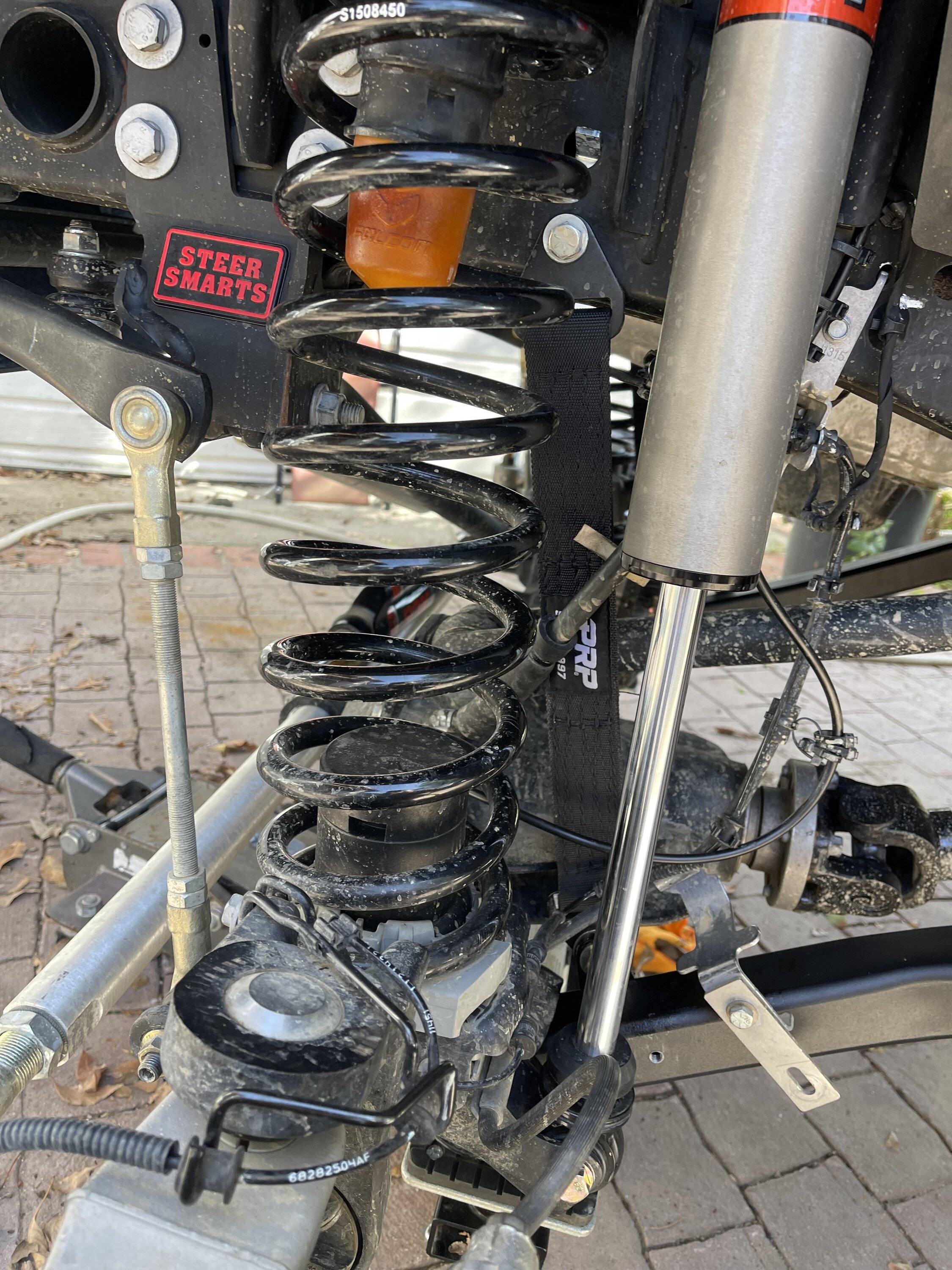

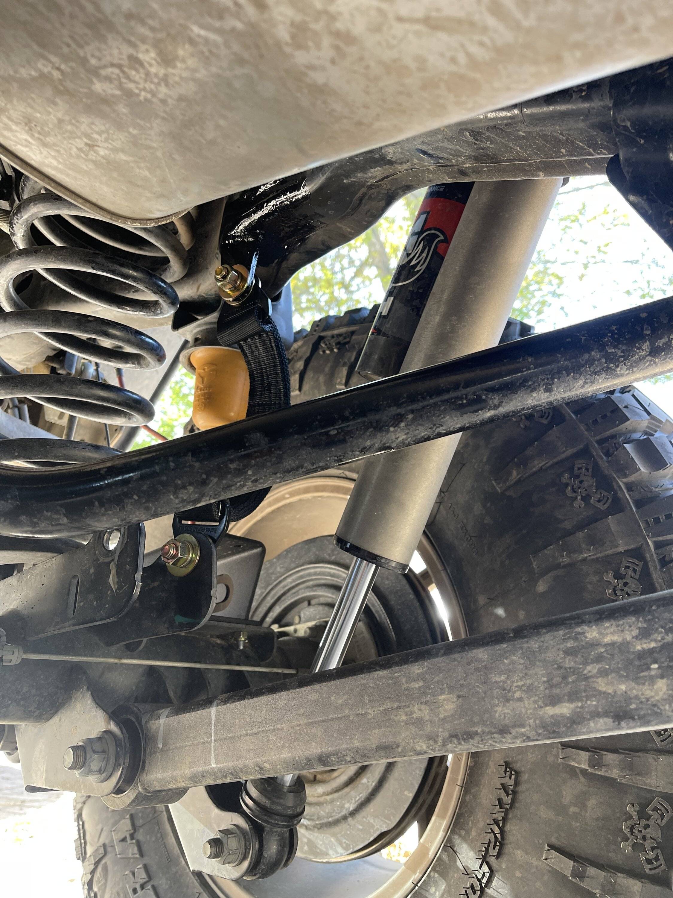

Prp limit straps front and rear. Teraflex bump stops and Clayton bump pads in the rear and adjustable bump pads in the front at 3” rn.

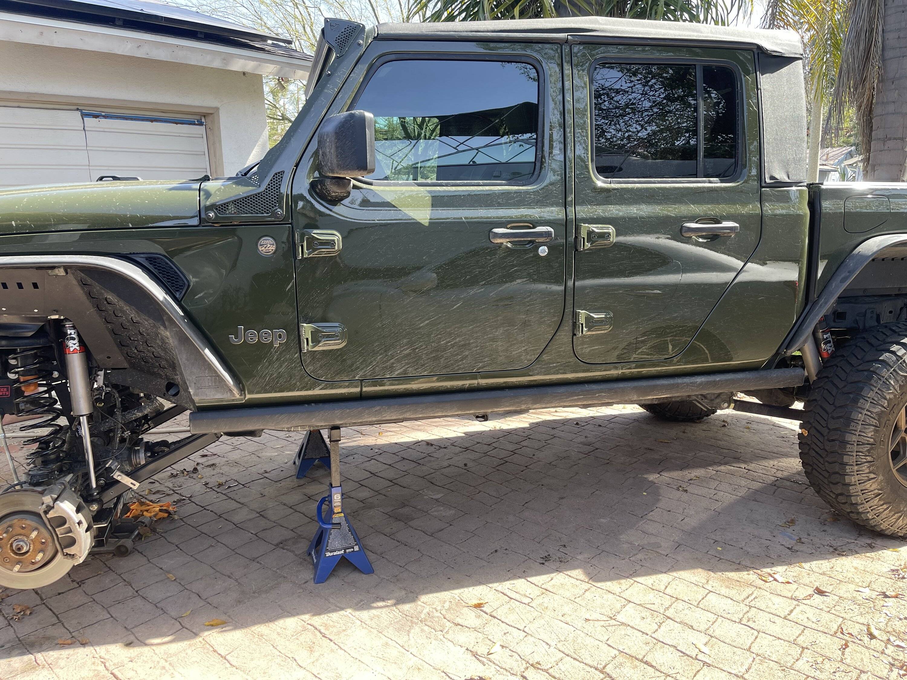

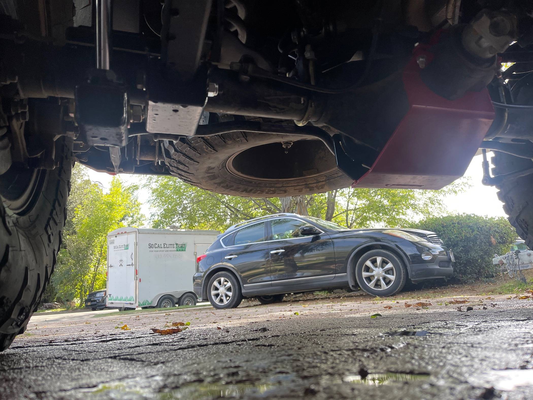

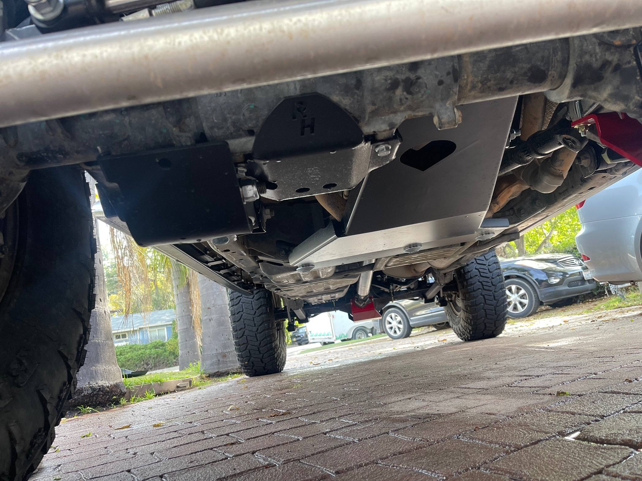

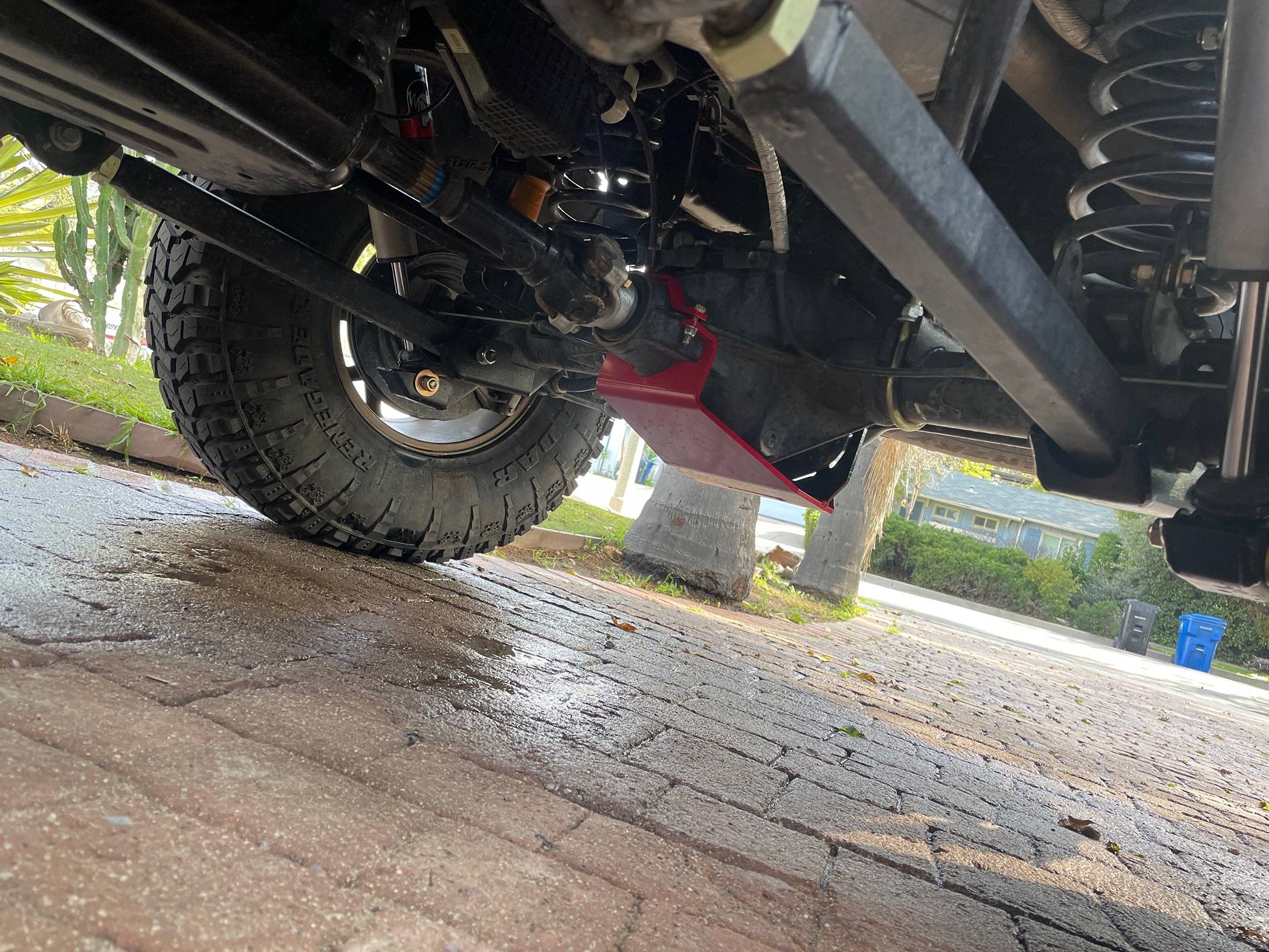

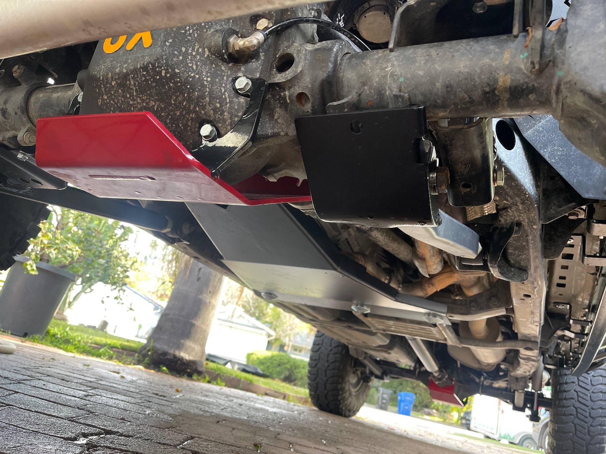

Rock hard rock sliders, skid plates from Rock Hard for the lower arms and shocks, and Rancho Diff skids front and rear, I modified the Rancho diff skid to fit the indents of the ox cover. Mountain off-road engine skid plate. And I have a Warn winch coming in for the front bumper.

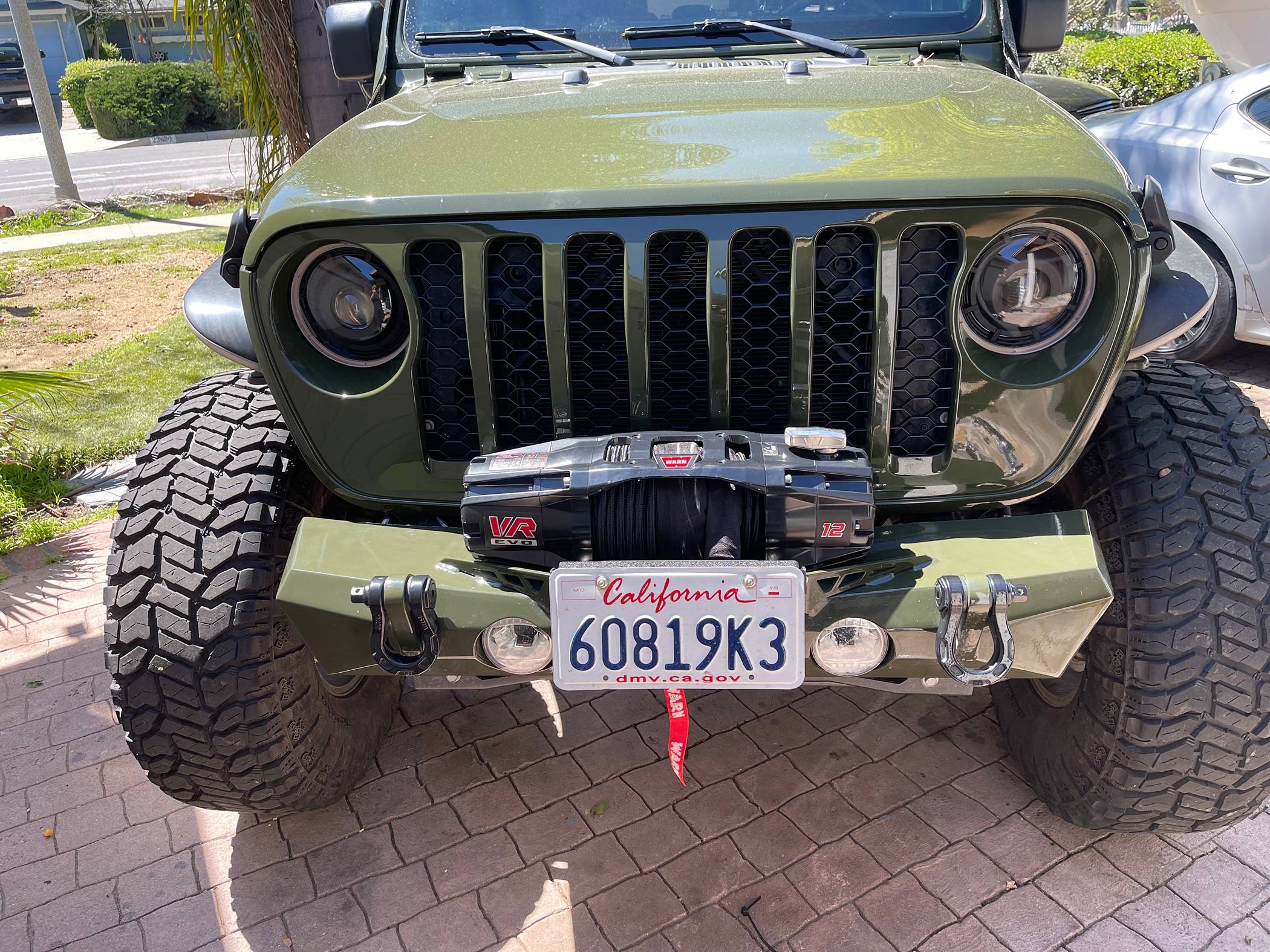

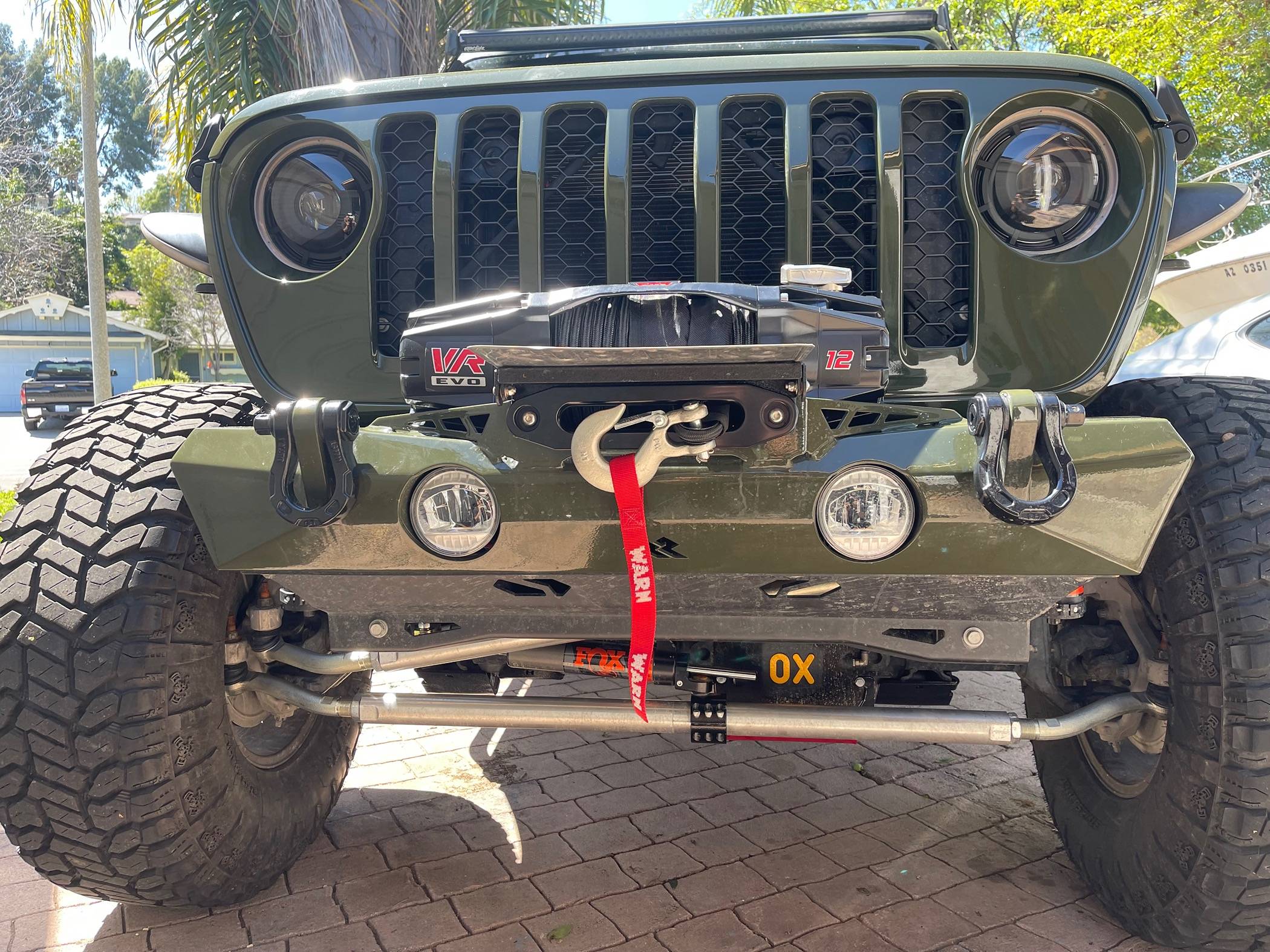

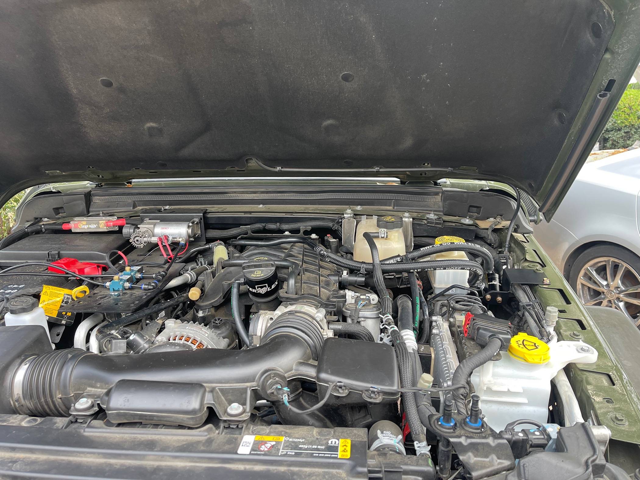

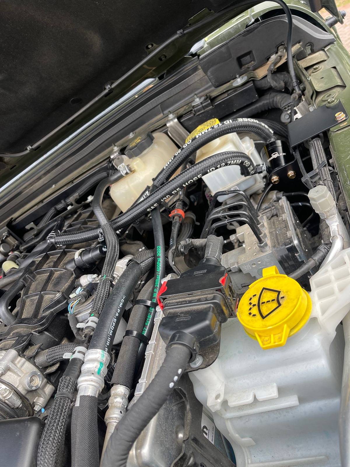

Warn vr evo 12k winch and Teraflex Crank Case vent system.

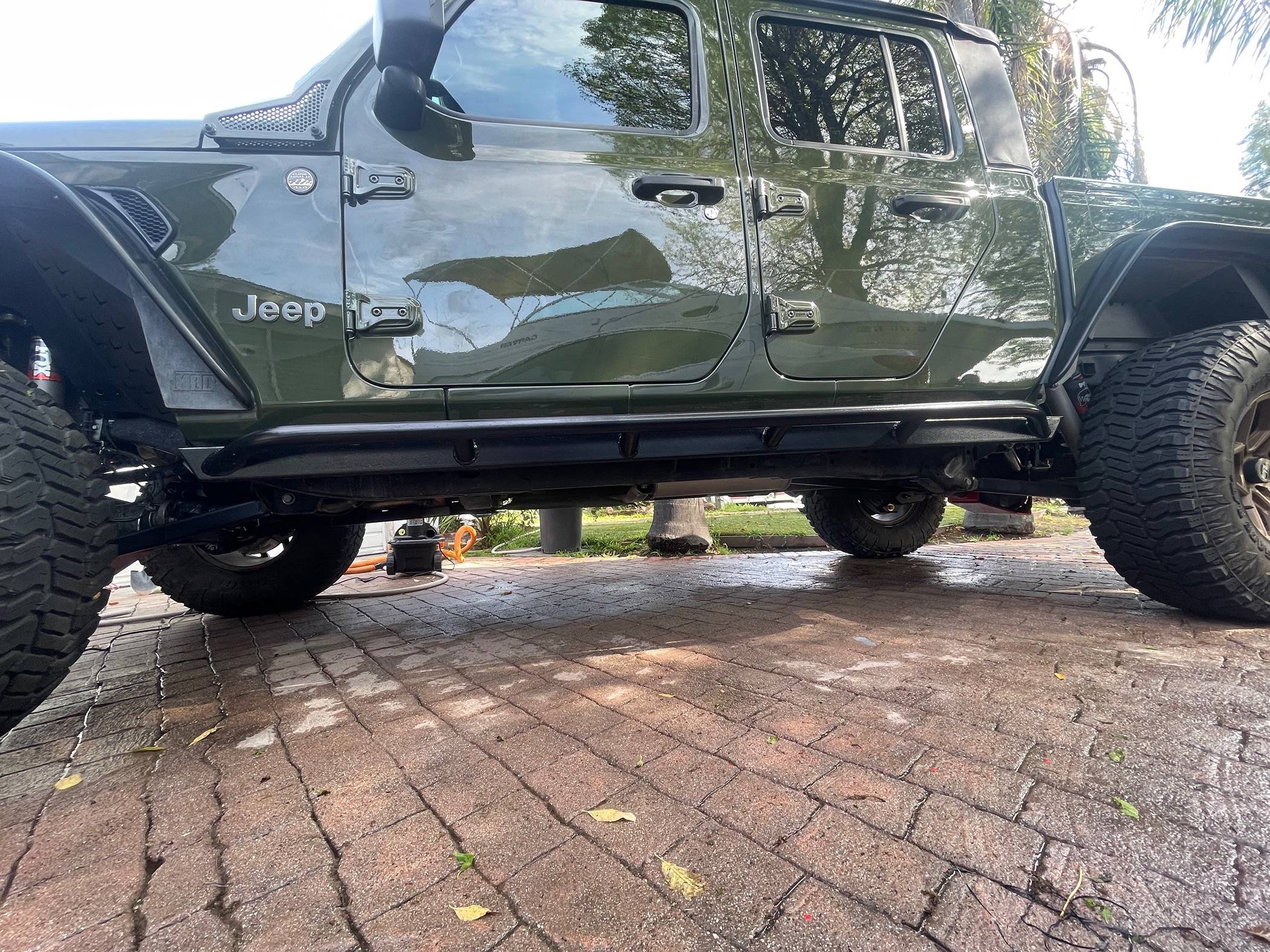

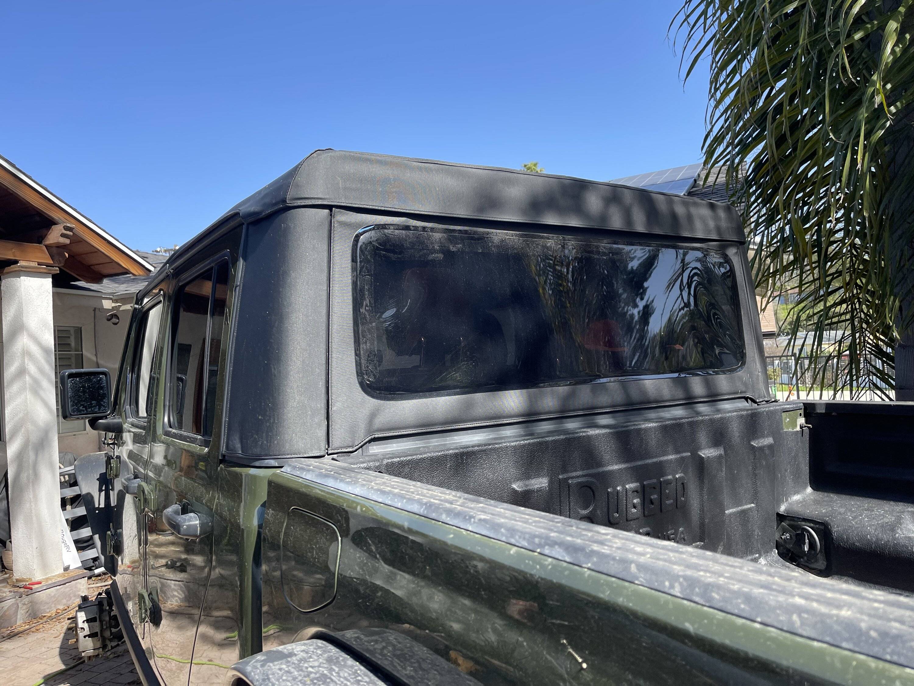

Also did rubicon side rails and tint, I just ordered some RockHard rock sliders angled up, they should arrive next week.
Jeep Gladiator My Do Everything Sarge Green Gladiator Build IMG_2312
And a rugged liner for the bed also. Actually now that I think about it, The rugged liner was my very first mod.
I’m currently looking into ASFIR JT engine and transmission skid plate but I’m not 100% sure. If anyone has experience with it or suggestions on something cheaper lol and still aluminum lmk

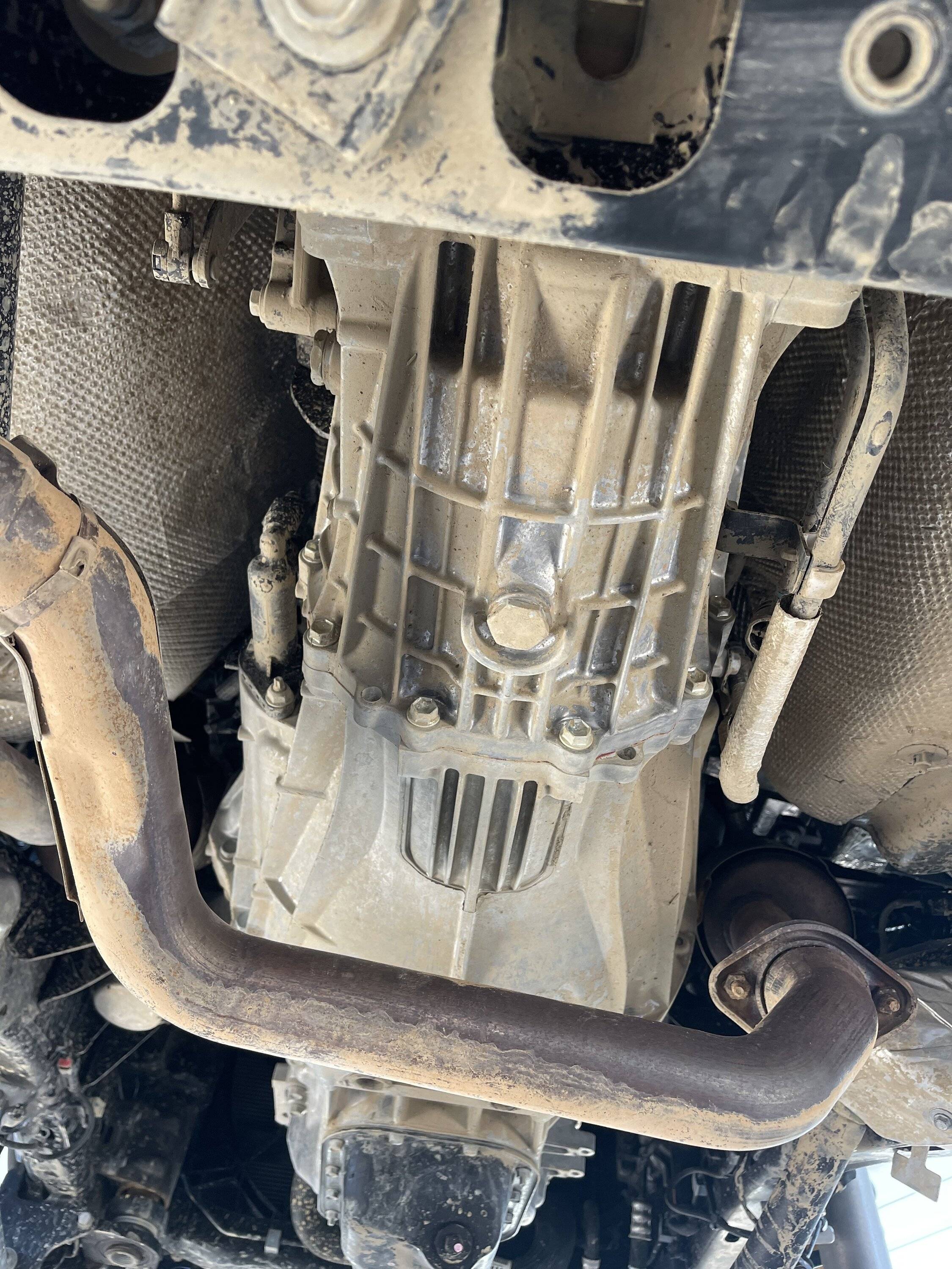

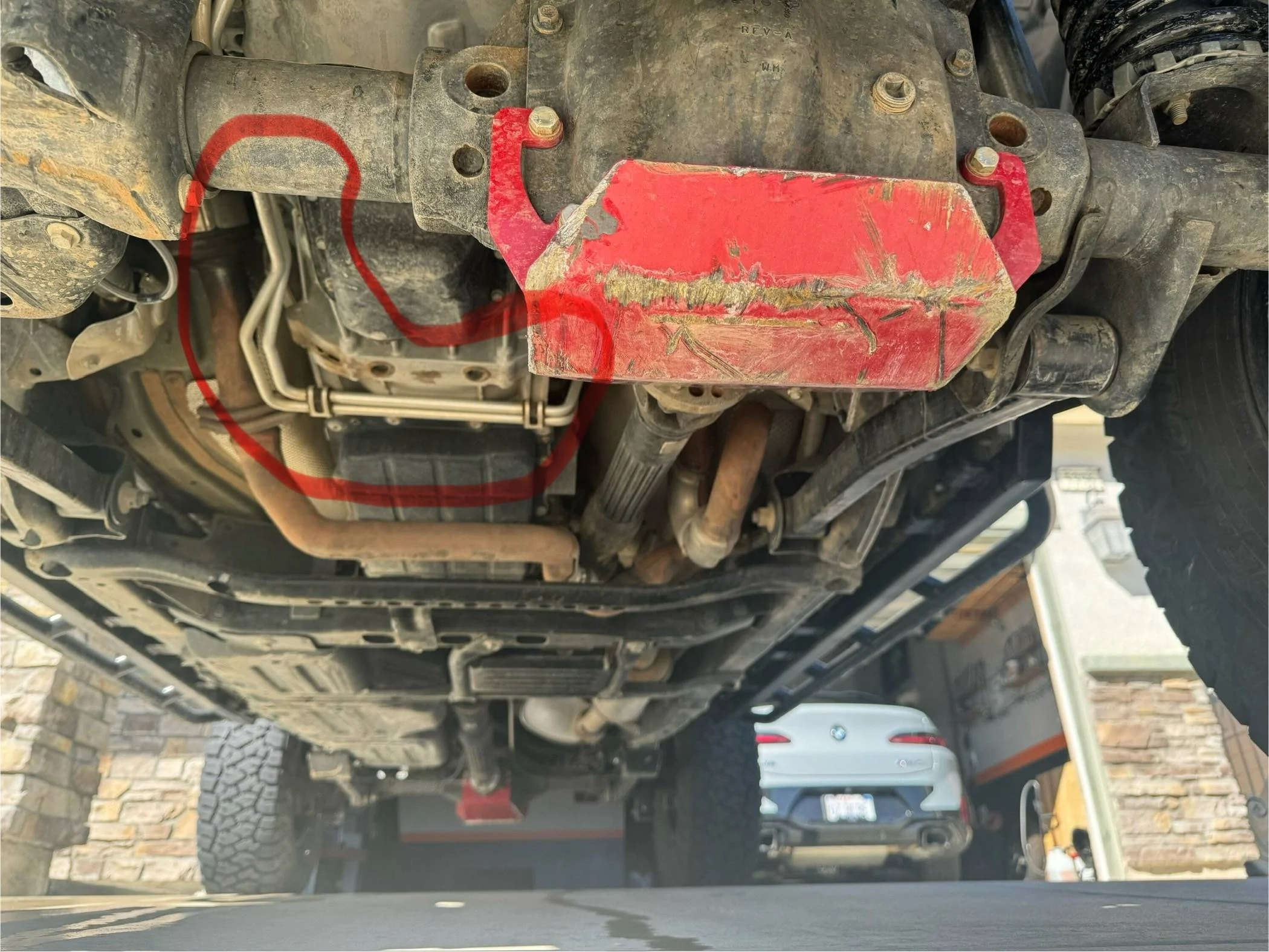

Did anything seem to melt when you welded on the Pro-X truss? I would want to do that but didn’t want to disassemble the axle/empty fluids. Plus I have an elocker so might be worth shielding that or removing it at the minimum ?
Did you ever see if the manual has any plumbing behind the oil pan?
I’m talking about this on an 8AT
Jeep Gladiator My Do Everything Sarge Green Gladiator Build IMG_6505

We did it at 110v, I don’t think it gets hot enough to hurt anything. It’s a 10 second blast I’m no engineer or anything but I think the fluid probably gets hotter when I’m running locked at like 65mph through desert/dunes. But again please do it at your own risk and I don’t know squat, I could be 100% wrong. My buddy builds and restores classic Harley’s, he seemed to think it was ok.

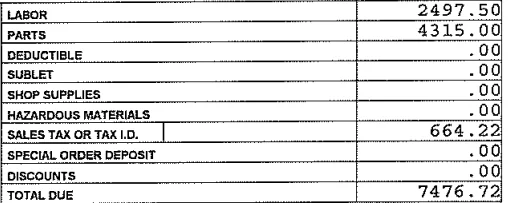

That’s good! Here’s an excerpt from @drewcnit thought tbh I think that’s the first person to admit they’ve hit those coolant lines. $7k fix?
Yep, here's from the repair bill -
I should also say, if I had stopped and left it off immediately when it happened, I may not have needed the transmission, it probably burnt up trying to get down the mountain as I had the Jeep on but in flat tow mode, so that I could use the brakes and not hit the guy pulling me.

Dang that’s horrible, so much money that could have gone to mods jk jk, that does suck though. I was about to order the ASFIR engine skid but I realized it doesn’t work w/ 6speed. Im going to call some companies when they are open tomorrow and figure out what will work for me
