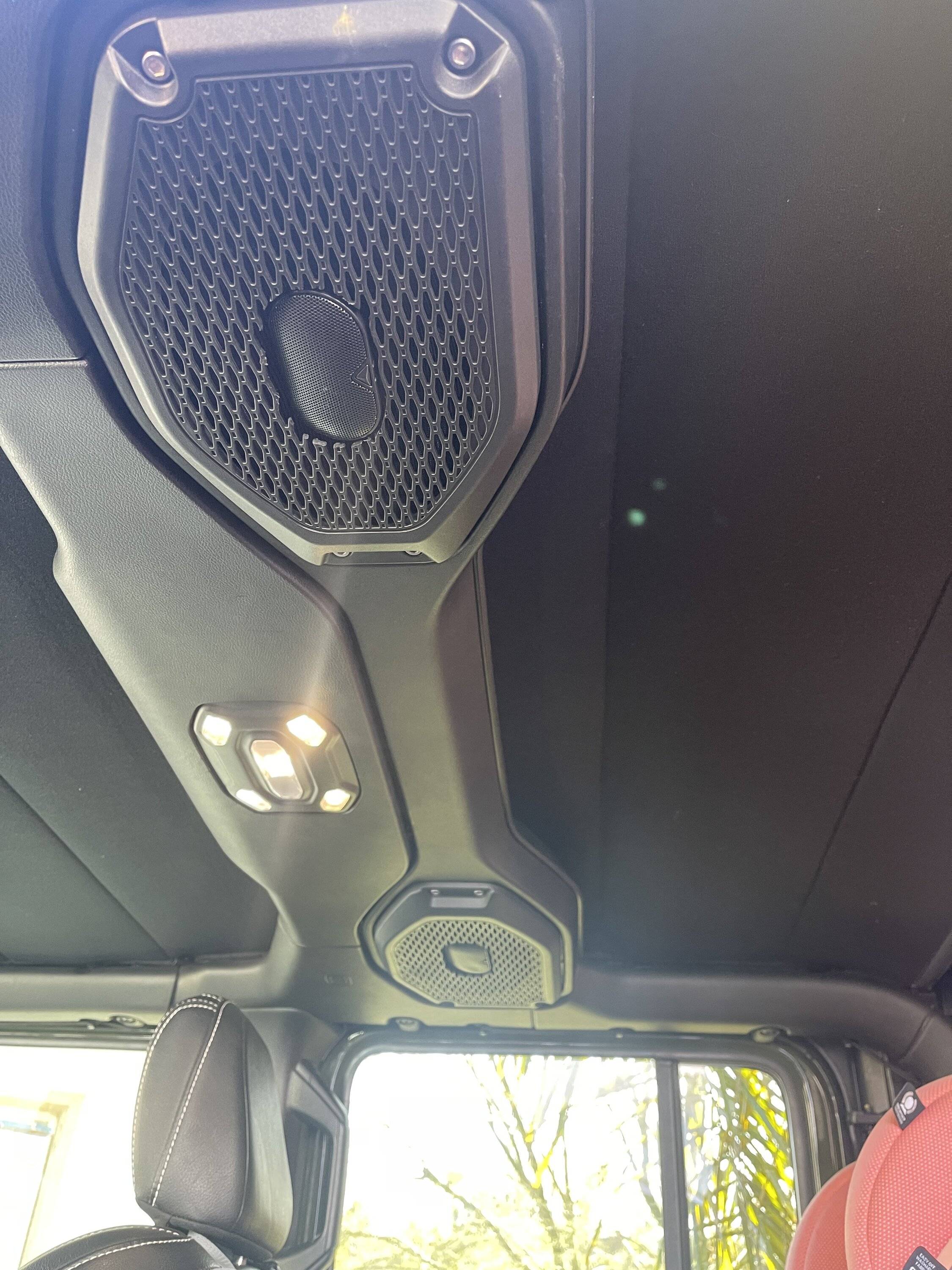

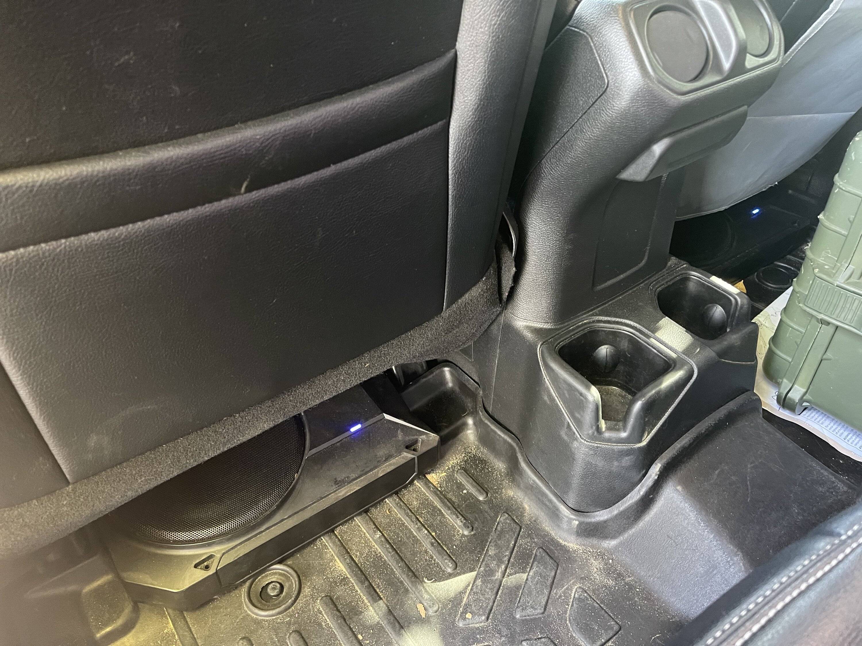

This is what my speakers look like installed. I ended up having to cut the MB speaker grills to fit center of speakers. It’s an all JBL stadium system except the subs I can remember there name but they just sit under the seats, I will mount them eventually… fyi I would not have spent what these speakers cost retail, but my friend works for JBL and I am able to get 50-60% off. Non-transferable discount lol please don’t ask. Also did a hotheads roof liner for the soft top, this added a great deal to the truck to make the interior feel finished.

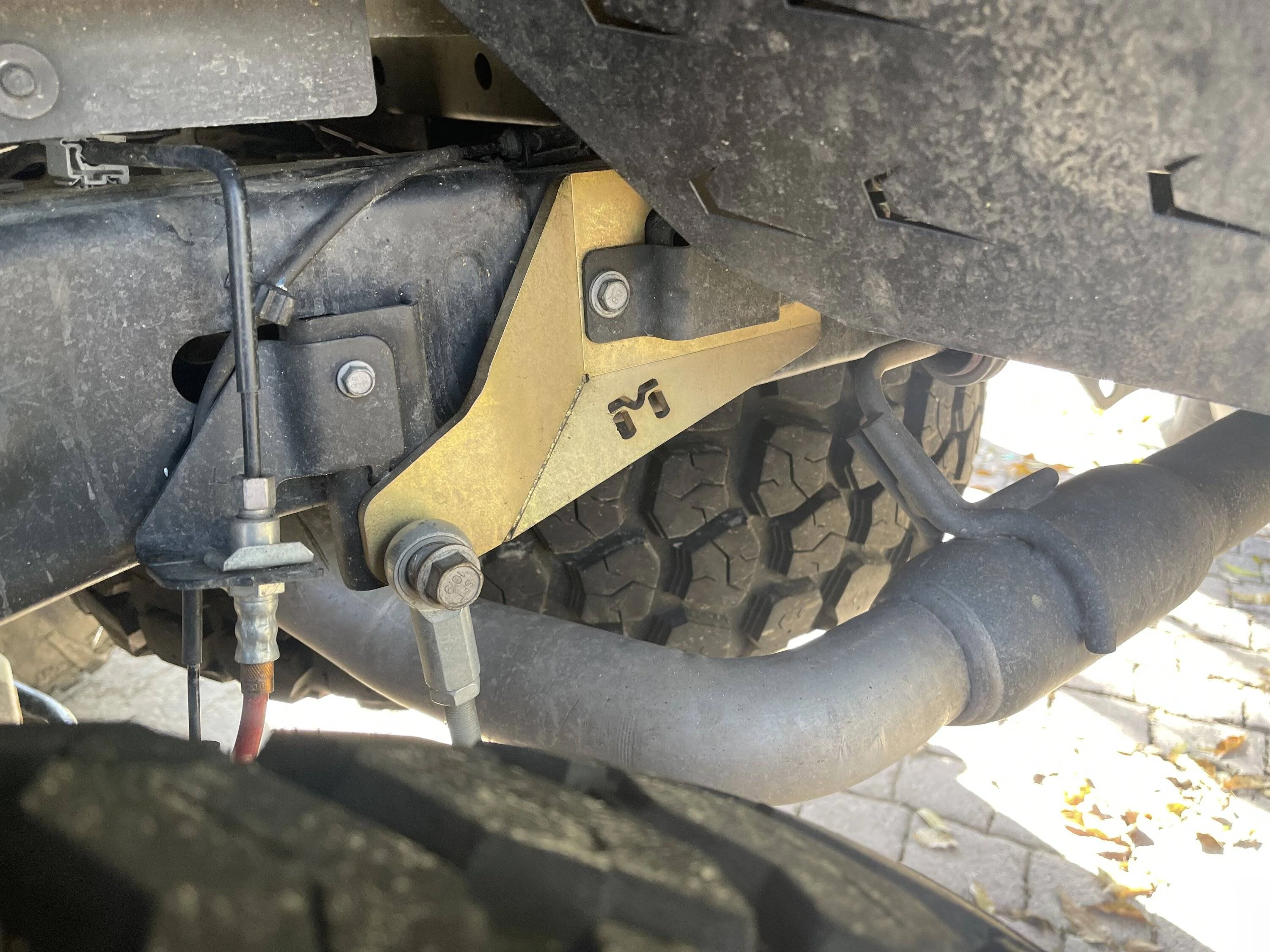

I also did the metal cloak rear swaybar endlink mount brace (not sure if that official name) . I would say nothing is really a necessary mod, EXCEPT THIS! I bent the crap out of my mounts when the truck was STOCK. I don’t know if the bolts where not torqued properly, I wouldn’t put this past jeep, but both bolts fell out but not before mangling the hell out of these mounts. I hammered them back into shape and added the metalcloak brace, and red loctite and haven’t had a problem since

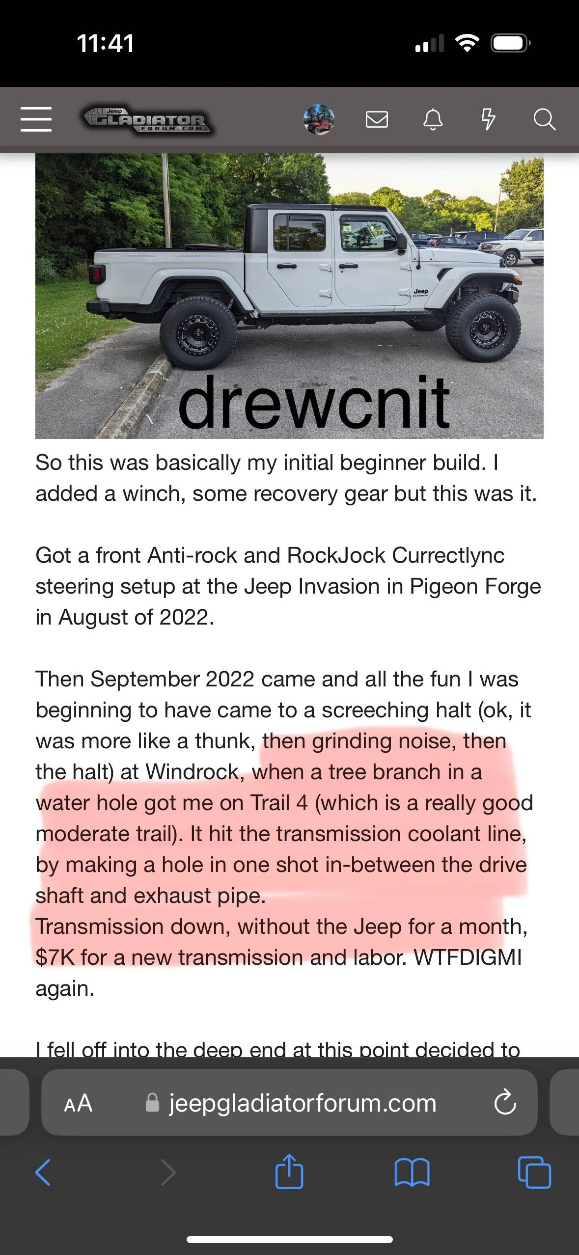

That’s good! Here’s an excerpt from @drewcnit thought tbh I think that’s the first person to admit they’ve hit those coolant lines. $7k fix?
I hit these same lines in Colorado last year. I actually hit the exhaust pipe first which I think took the brunt of the force and the lines were moved and the bracket bent. I still need to fix the exhaust leak that remains from this rock. Did you end up putting a skid place in th
Yep, here's from the repair bill -
I should also say, if I had stopped and left it off immediately when it happened, I may not have needed the transmission, it probably burnt up trying to get down the mountain as I had the Jeep on but in flat tow mode, so that I could use the brakes and not hit the guy pulling me.
I hit these same lines in Colorado last year. I actually hit the exhaust pipe first which I think took the brunt of the force and the lines were moved and the bracket bent. I still need to fix the exhaust leak that remains from this rock. Did you end up putting a skid place in that area? Thanks!!
Yes, RockHard 4x4 Aluminum Belly pan, so much coverage!
