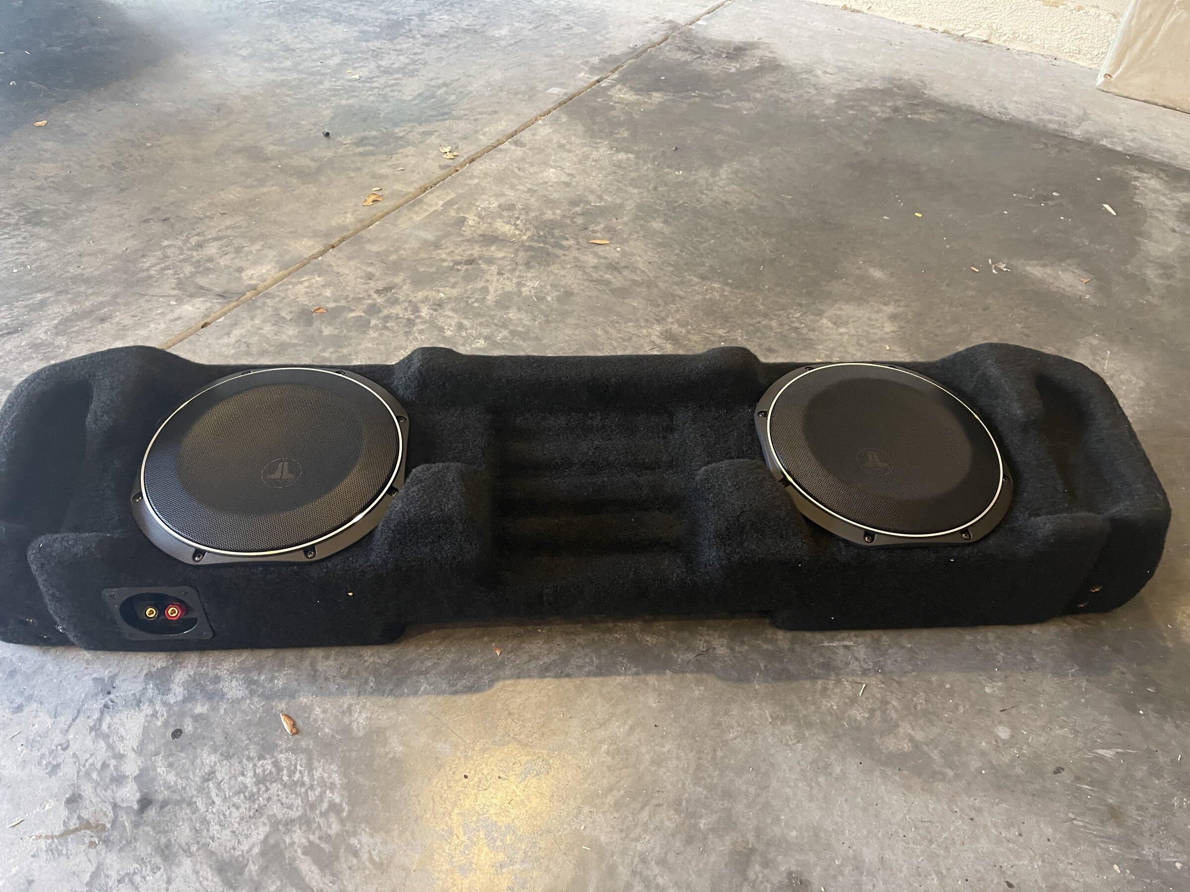

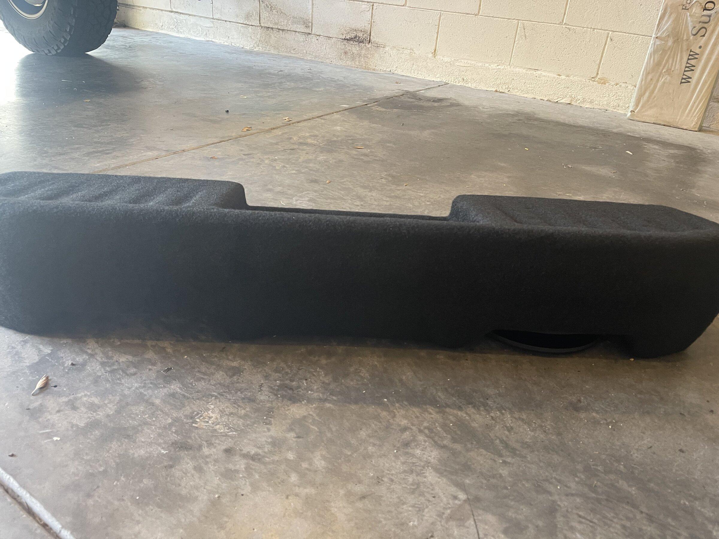

Im just finishing mine. Ended up with
Mb quart 3.5 in dash 4ohm. These connect in parralel to 4 ohm 6.5 kicker coaxials in th kick panels. These run at 2ohm for 115watts.
The soundbar has infinity 6x9 3 way 2ohm also @ 115 watts. Im using the jl audio under seat subwoofer which had 2 10s down firing. This is running off a 5. Hannel audison that puts 550 to the subs. I had originally used a rockford amp but wanted more sub power.
the amp is under the front driver seat. Ill post some pics later....very happy overall after applying the audison amp.
Jeep Gladiator 8.4 Premium Audio Upgrades A84EF474-6089-41AC-BB94-D6879A1EF1F0
Jeep Gladiator 8.4 Premium Audio Upgrades 453AE193-0541-487E-B2B6-139EB46FBBCF
