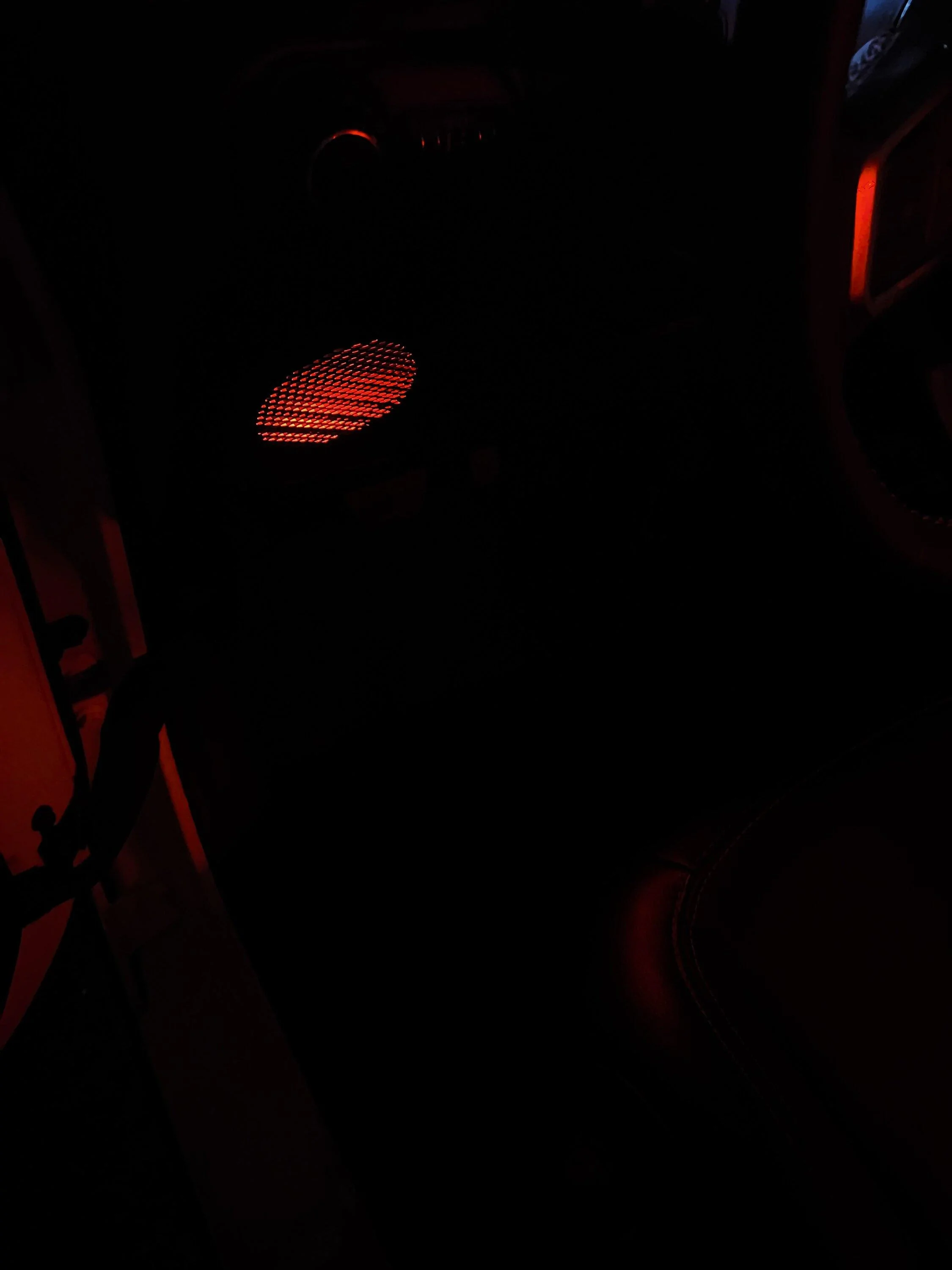

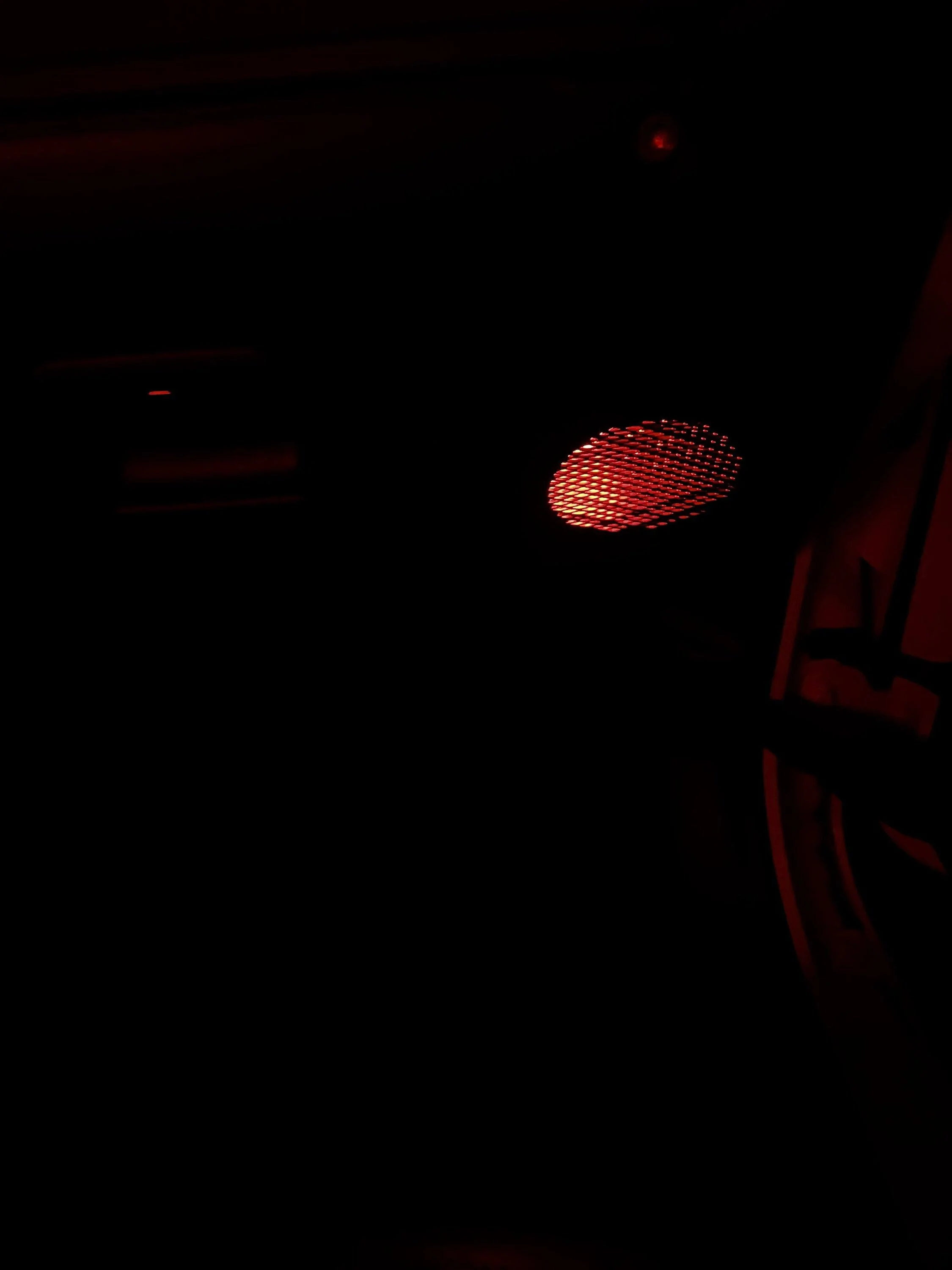

I also installed the 6.5” metra pod for knee panel speakers. I used stuck sound deadening material all inside and some polyfil. I used the 6.5” DS18-500 watt max, 250 rms. They have a red led in middle of cone. You can use a bt controller but I just wired the red color into the aux switch.

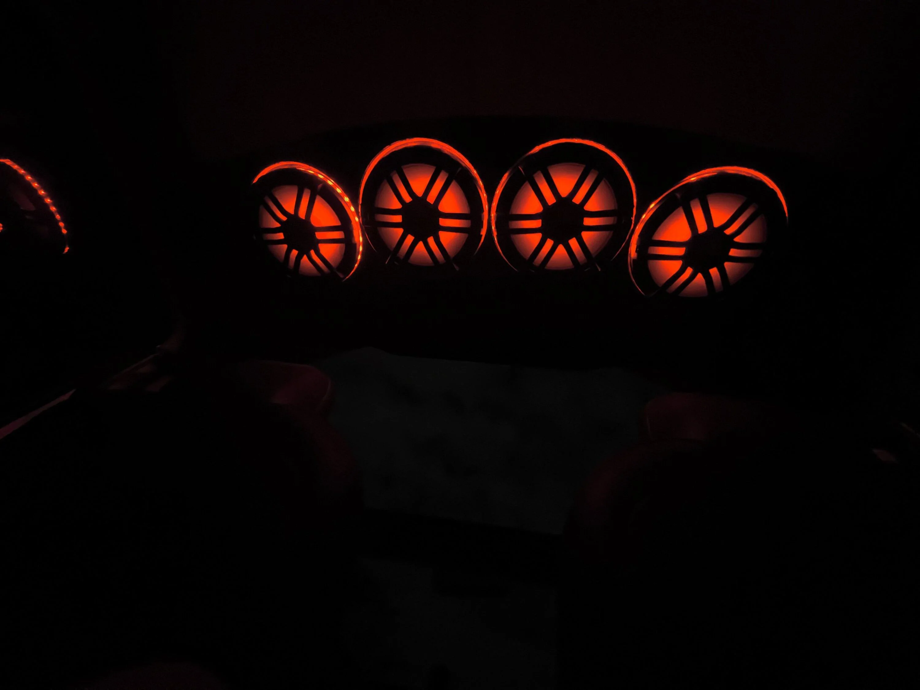

I installed 4-8” Rockford Fosgate color optix, 250 rms and 1000 watt max into soundbar. Had to order bt led controller for the speakers since they have led lights in cones.

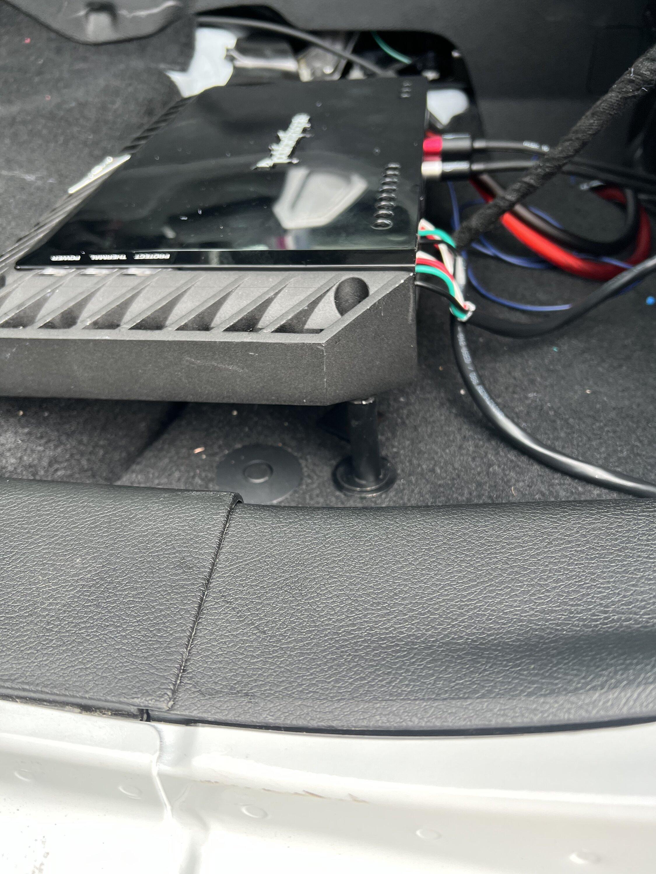

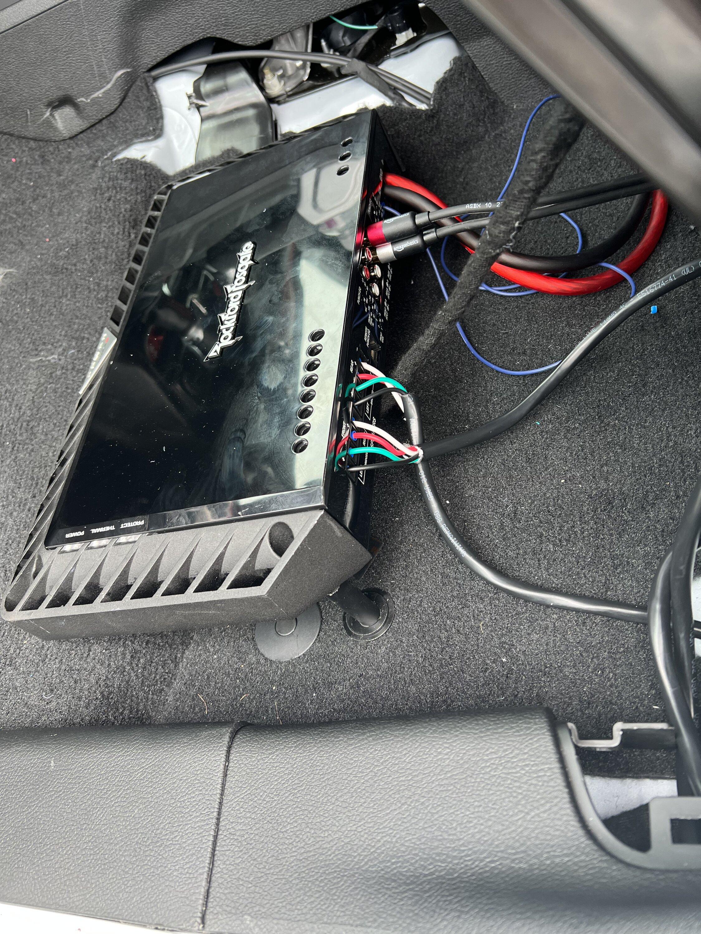

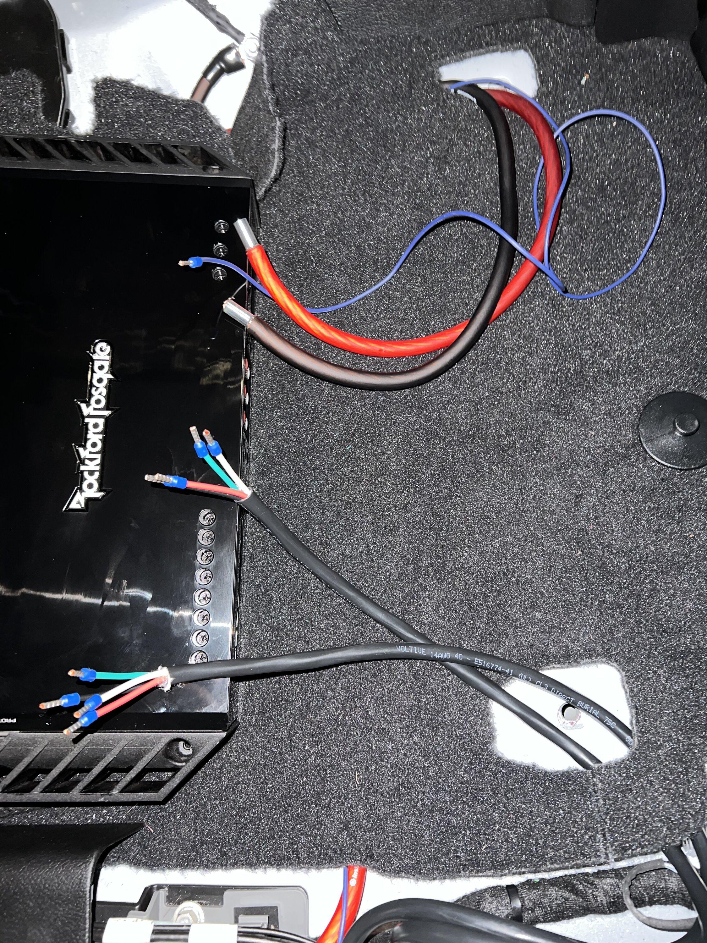

I installed a 1000 watt 4 channel Rockford Fosgate amp the outputs 250 watt rms to every channel. I put it under drivers seat and added a 2 spacers on rear of amp to sit above air vent.

I’m now just waiting for my pac amp pro to arrive to hookup the rca wires I already ran.
I ran the LED speaker rings, LEDs in the center of 6.5” knee speakers and the LEDs on the 8” soundbar speakers to the same factory auxiliary switch.
