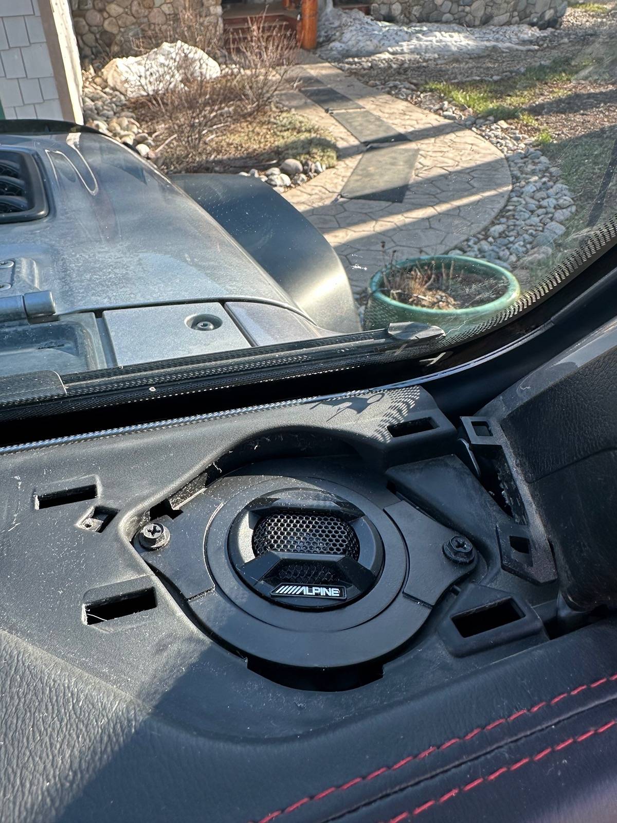

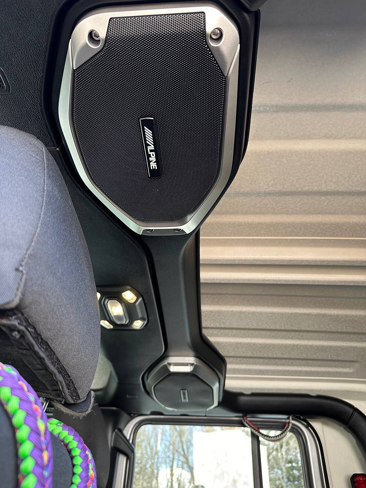

If you have the factory amp and sub, I’d personally start with the alpine setup. They’re specifically designed for JL and JT jeeps. I have them in mine and they sound amazing. I still have the factory head unit. Mine did not come with an amp, so I added a very small 200w (50x4) alpine amp.
I have these for the sound bar…
https://www.crutchfield.com/p_500SPV65JL/Alpine-SPV-65-JLT.html
These for the dash (they fit under factory screens)…
https://www.crutchfield.com/p_500SPV10TW/Alpine-SPV-10TW-WRA.html
and this amp that fits behind the glove box…
https://www.crutchfield.com/p_500KTA450/Alpine-KTA-450-Power-Pack.html
I didn’t have a factory sub, so I added a powered Memphis 10”. But since you have an amp and a sub, I’d start with the speakers and see how it sounds. I think your be quite happy.
My setup is similar but I have a powered Alpine Sub under the front passenger. Came bundled with tweeters and amp.
https://www.amazon.com/dp/B07K43KGPF
I also have the same sound bar upgrade.

I have the 200w alpine amp behind the glove box. It powers new alpines in the sound bar and dash, along with the stock knee speakers. They weren’t worth the effort. I then have a 300w Memphis 10” sub behind the rear passenger seat. It sounds great.

Like you, I skipped the knee speakers. I used alpine spv-65-jet in the sound bar. You don’t need to change any polarity with them, as they’re wired and crossed over specifically for the JL or JT. I used their 1” dash tweeters which match perfectly. They also don’t need polarity changes as they’re specifically setup for these jeeps. But these speakers needed a little power, and my factory 7” wasn’t cutting it.
