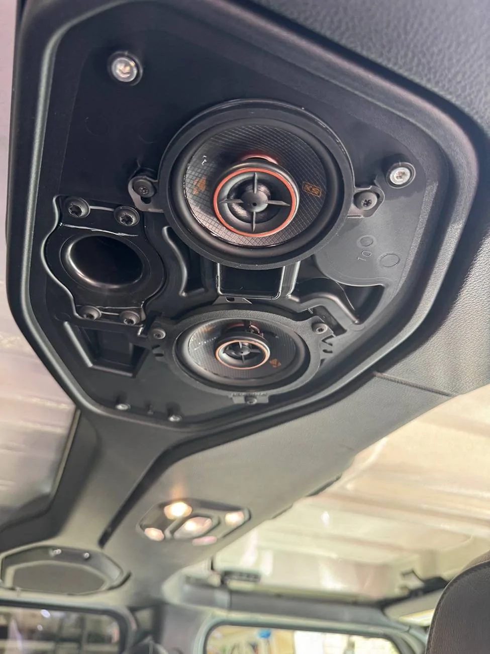

just installed this exact combo today. 3.5s In dash and soundbar and a 4” also in the soundbar. Bought from Crutchfield, unfortunately one of the Metra adapters 72-6514 for the 4” was broken so had to keep the factory 4” on one side but it definitely sounds better. Had some 3m thinsulate laying around and stuffed it up in the 4” cavity of the soundbar behind each of the 4" speakers.
The 3.5” in the soundbar barely fits but it’s tight and locks down when screwed in.

just installed this exact combo today. 3.5s In dash and soundbar and a 4” also in the soundbar. Bought from Crutchfield, unfortunately one of the Metra adapters 72-6514 for the 4” was broken so had to keep the factory 4” on one side but it definitely sounds better. Stuffed a little poly fill up in the 4” cavity of the soundbar.

Those extra 4-way tabs can be bent back and forth until they snap off, leaving just the 3-way tabs. Then the speaker fits flush.
Edit: At least that was true on particular brand I put in.
Thanks! Yeh the 4" seemed to fit in flush with the little kicker outer plate even though the speaker tabs don't line up.

So far, very happy with the setup. Front Stage on the dash and Kicker replacements on the sound bar. Put polyfil in there and bent off the tabs on the 4" speakers, easy install. Love the sound. Easy upgrade. Thanks for everyone's advice.
