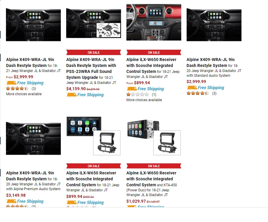

Ive been eyeing that iLx-W650, just waiting to see what functionality you loose from stock.

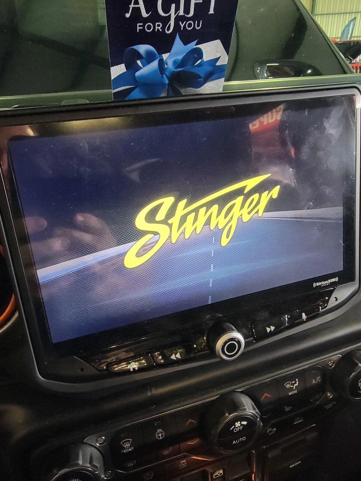

Stinger Heigh 10
Abby Speaker solutions 8" tweet pods overhead with 8" Hertz Mid bass with Skar neo tweeters
Dash. DD AW6.5s with Skar neo tweeters in dash.
Audio Control DM-810 DSP

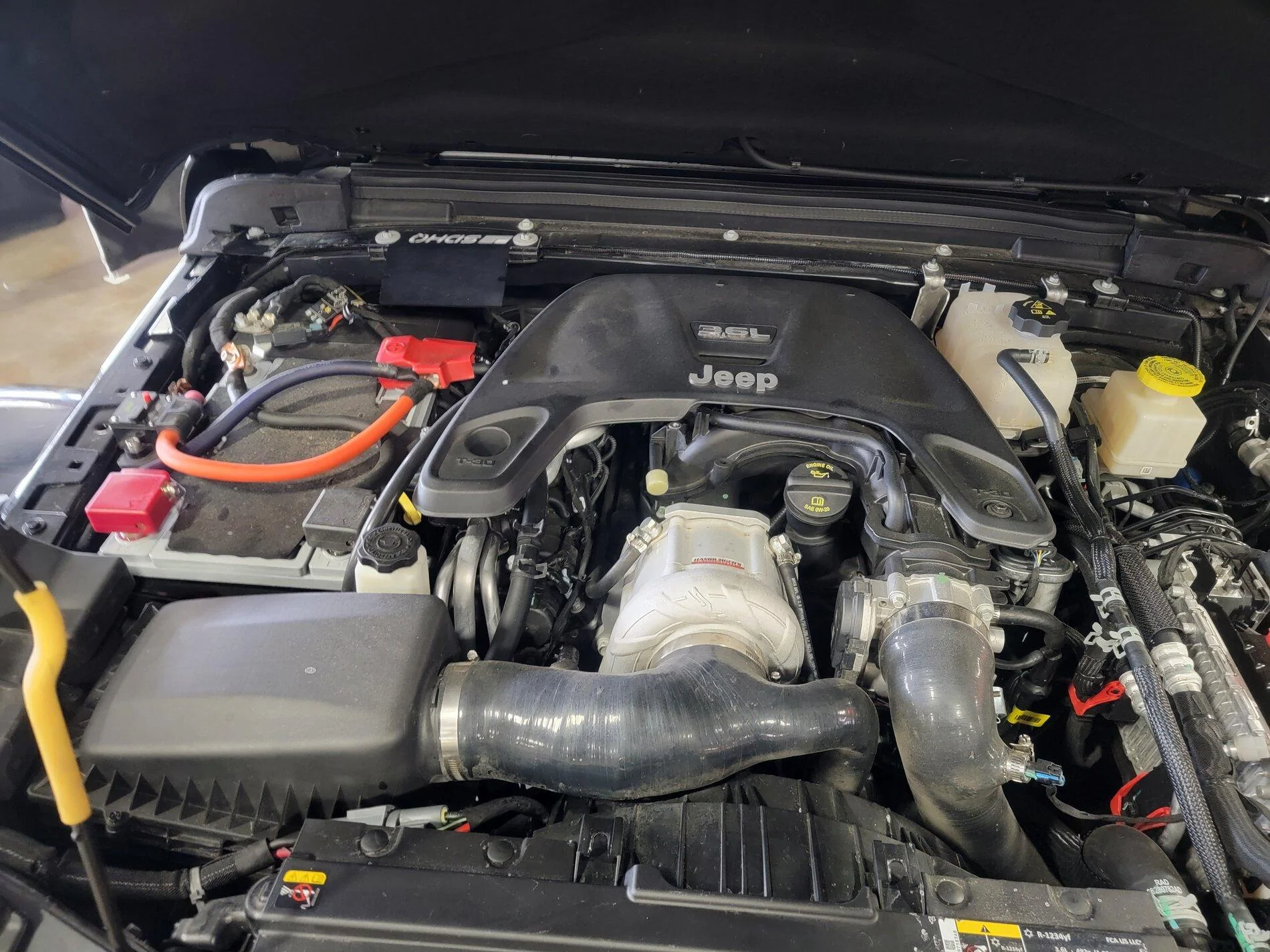

Profit box

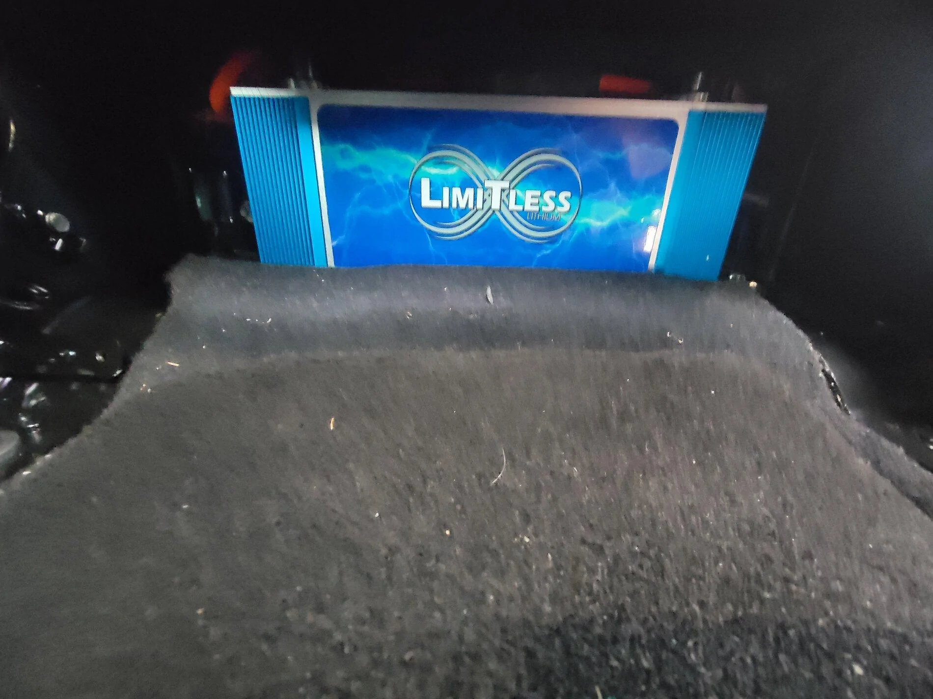

Limitless Lithium Cyber 12k battery
Genesis Dual Battery DIY kit
2 Full Throttle FT750-25 batteries
1 400 amp alternator.
I would imagine very little if your starting with the 5 or the 7 considering the mandatory scoshe replacement panel.
