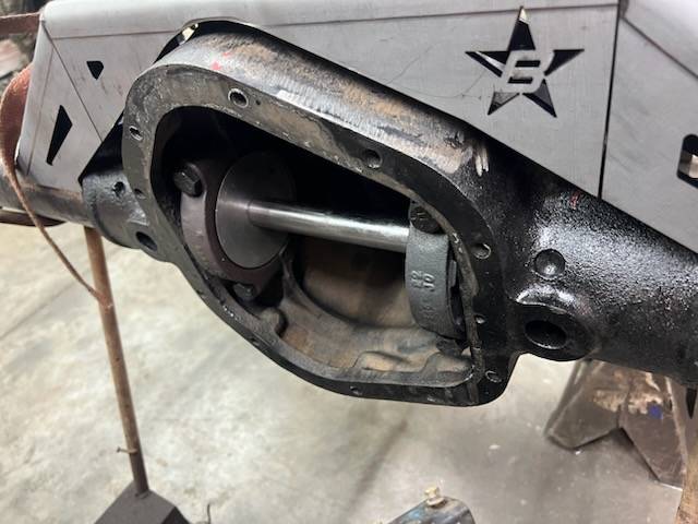

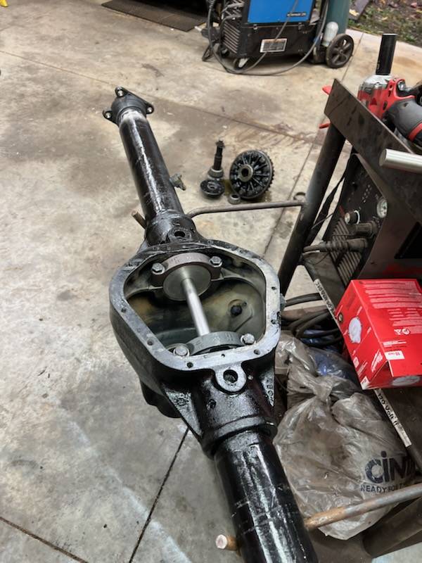

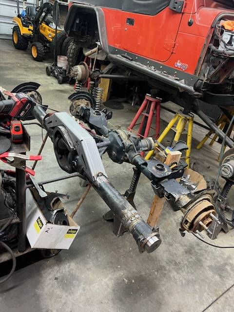

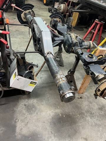

I've had this axle for years behind the barn , found a bent JT axle housing n thought why not....
not finished yet , hopefully get the brackets welded on over thanksgiving
gears locker n shafts ordered soon too!
this was 1999 ford e-350 D60U smooth bottom axle
Jeep Gladiator Got bored, decided to build a semi float 60 rear axle IMG_7972
Jeep Gladiator Got bored, decided to build a semi float 60 rear axle IMG_7971
Jeep Gladiator Got bored, decided to build a semi float 60 rear axle IMG_7876
Jeep Gladiator Got bored, decided to build a semi float 60 rear axle IMG_7970
Jeep Gladiator Got bored, decided to build a semi float 60 rear axle IMG_7969

What are you doing that will make it free floating?
What is the bar that is going across inside the differential housing? some kind of alignment bar?

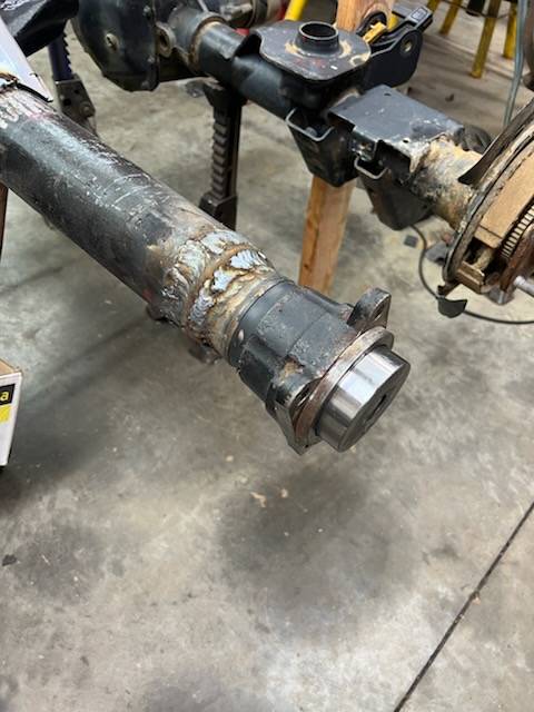

Another thing that came to mind today as a straiten/sleeve another JK housing..........
I would have welded the ends on last after all the control arm brackets/truss were welded on. I'm sure your tubes are pretty heavy, but I have found the housing is never strait after welding. Nothing a little heating/cooling to straiten the tubes can't fix if it pulls a little though?
